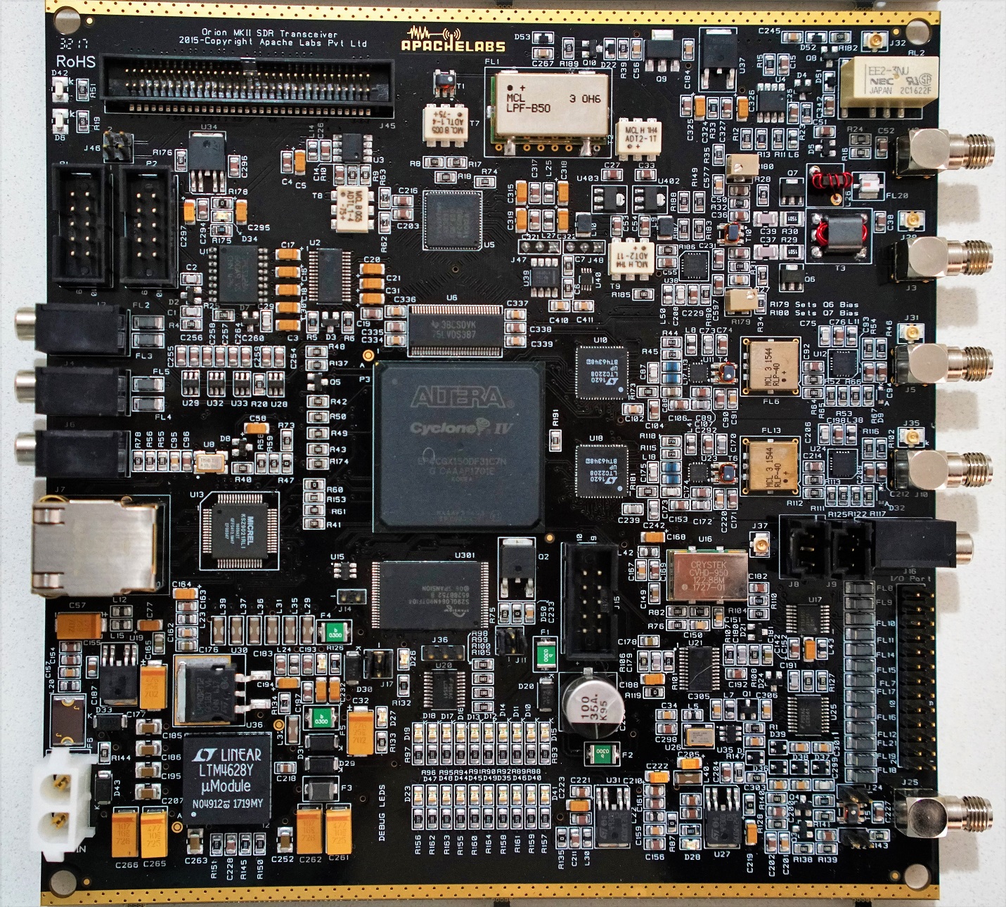

Re: Unstable, wide, nasty spur
I got this image right off of the Apache website. Easy day, right on the edge of the board.
Hmm. Didn't think of that, obviously.
Thanks, Scott. Looks like a walk in the park!

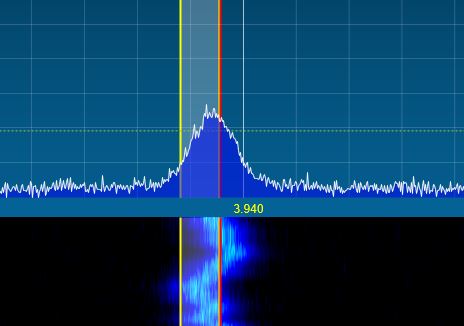

- After mod - change R145 to 140K
- w7kev_spur_after.jpg (17.11 KiB) Viewed 41136 times
- Before mod - R145 is 100K - actually 99.36K measured.
- w7kev_spur_before.JPG (24.49 KiB) Viewed 41136 times

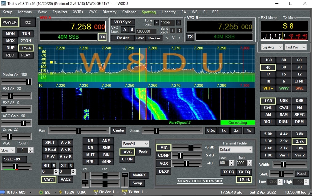

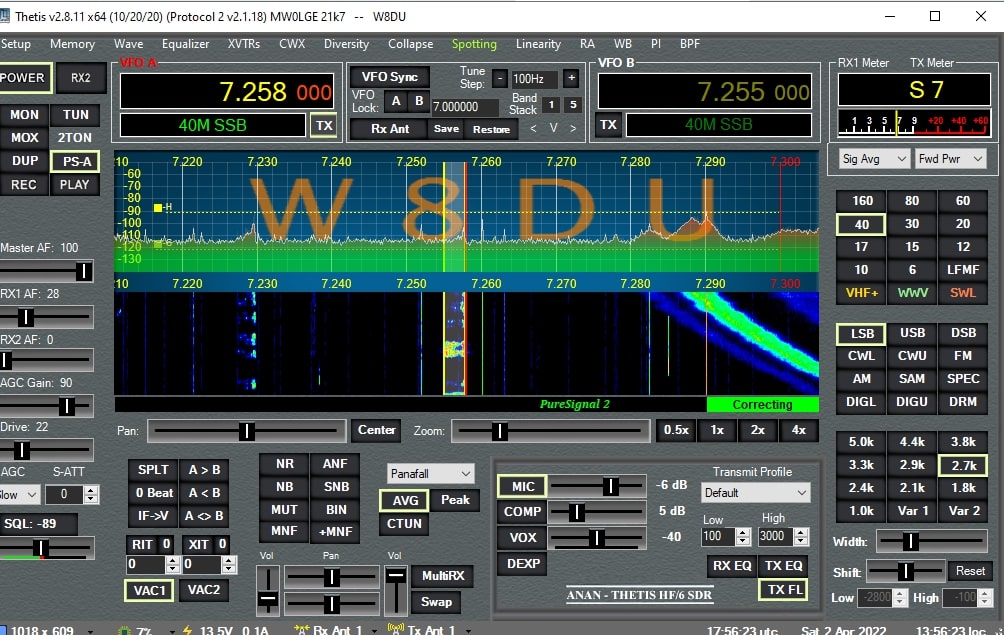

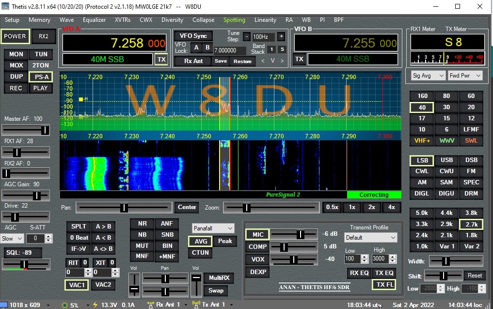

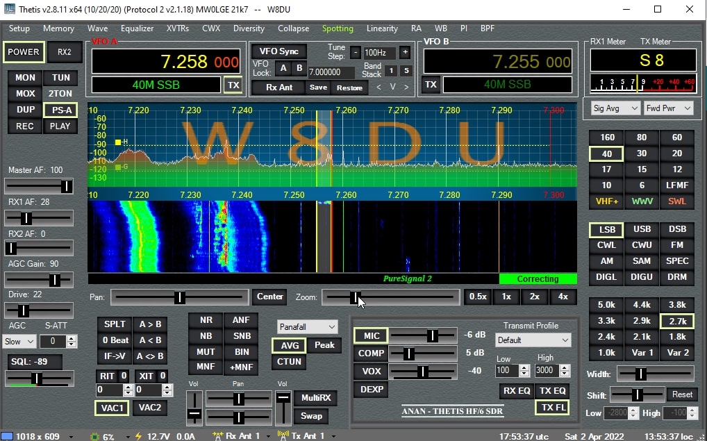

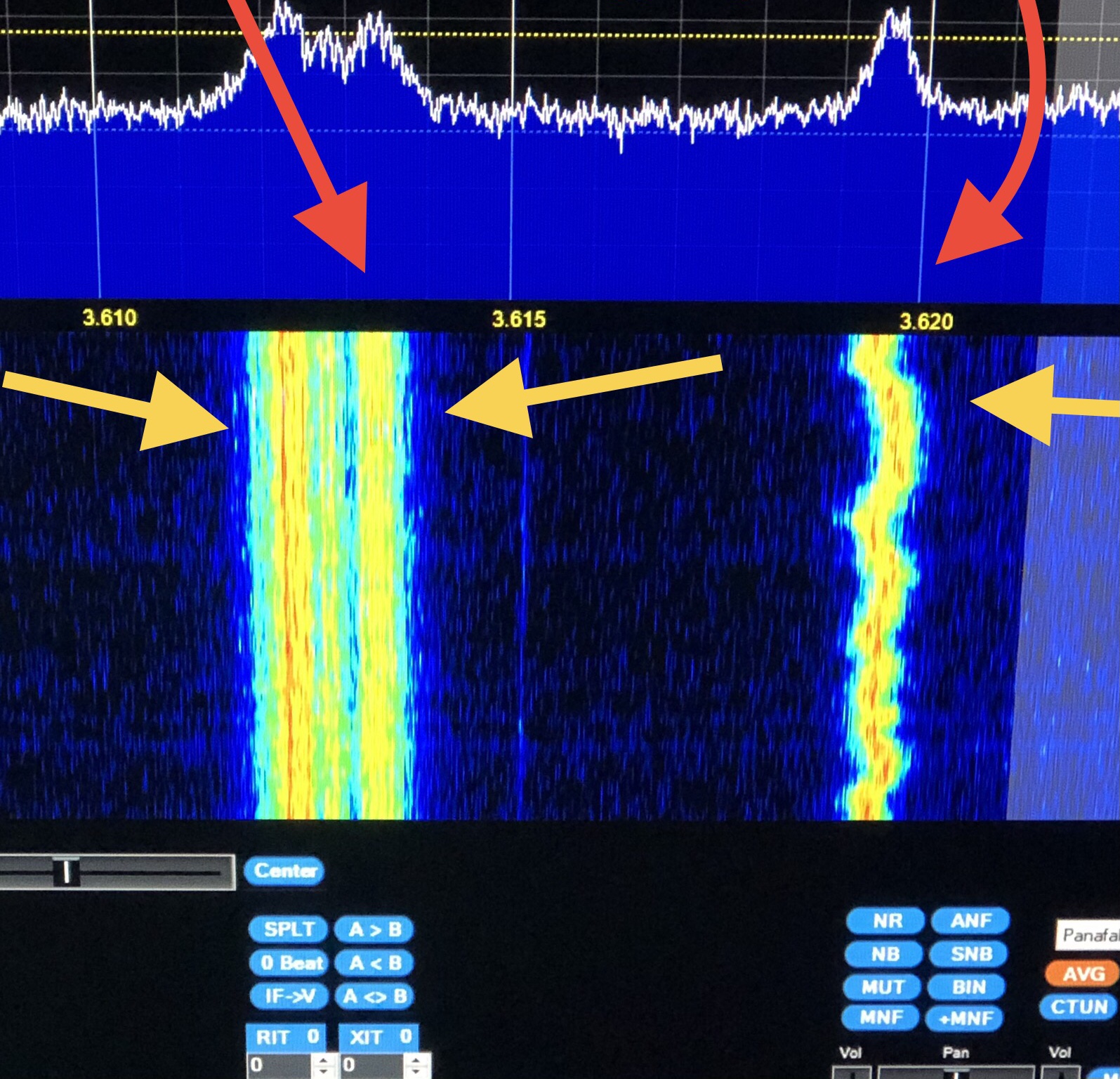

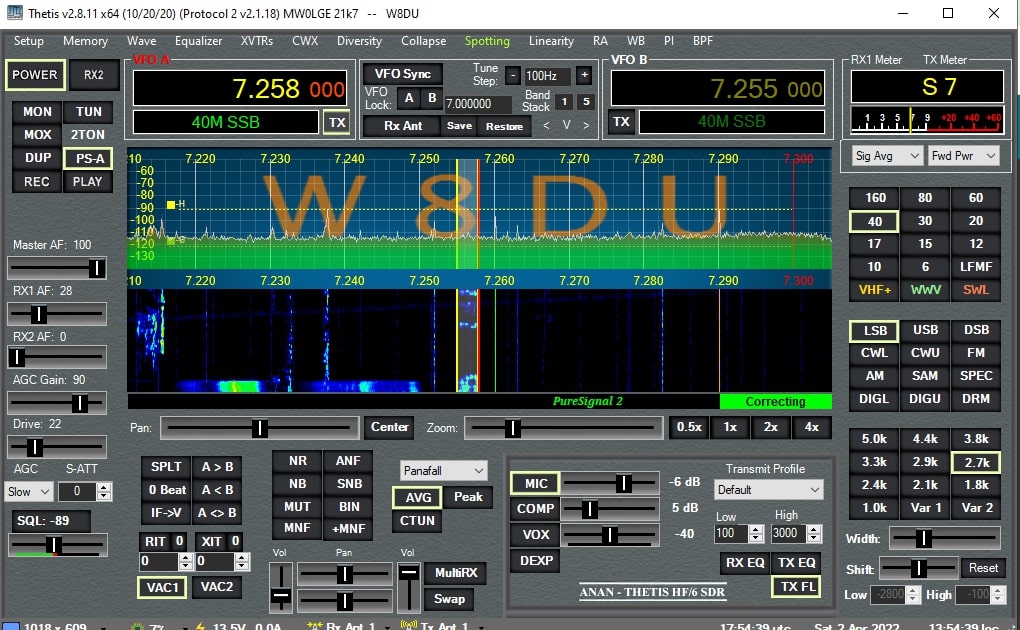

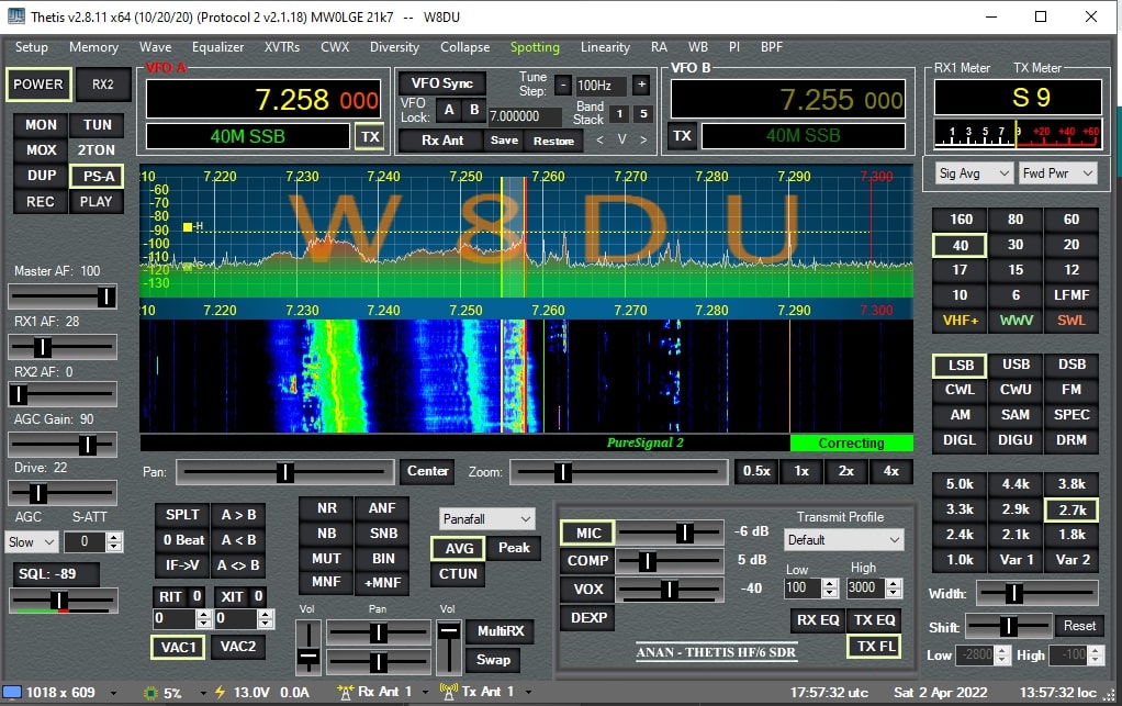

I am thinking maybe I am having the same problem, but the fundamental appears to be in the 40 meter phone band. The noise is definitely coming in through the antenna because when I disconnect the antenna, it disappears completely. It also abruptly starts and stops with no apparent repeating interval. Any ideas on this one anyone?
Tnx es 73 de Arnie W8DU
