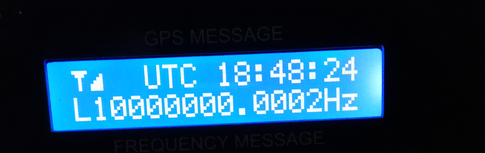

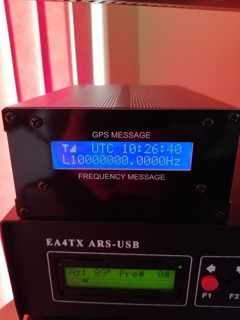

Postby Tony EI7BMB » Tue Sep 24, 2019 6:53 pm
Unit arrived today and works fine after I made up an external mount for the supplied GPS antenna. Have not had time to look for the OXCO type so far as I've been monitoring the EI0SIX beacon all day. Nice display too
Re: GPSDO Tutorial?
Postby w-u-2-o » Tue Sep 24, 2019 10:31 pm
200 microHertz error. How on Earth do you find that acceptable? ;)
Re: GPSDO Tutorial?
Postby Tony EI7BMB » Wed Sep 25, 2019 7:50 am
LOL guess I'll have to live with it :D
