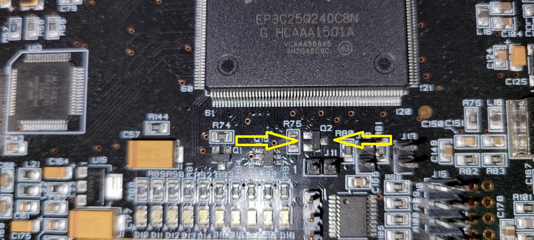

I have down loaded the schematic but I still need to find it on there.
Anyway this is a pic of the 10E board. Any chance would you know if this is the Fet that controls the PTT Out?

Re: Voltage On PTT Out After Power Blink
On the Hermes schematic look at sheet 8, block C5.
I just had a chance to look this up Scott!
Yep 2n7002K fett (Q2) C5 area.
