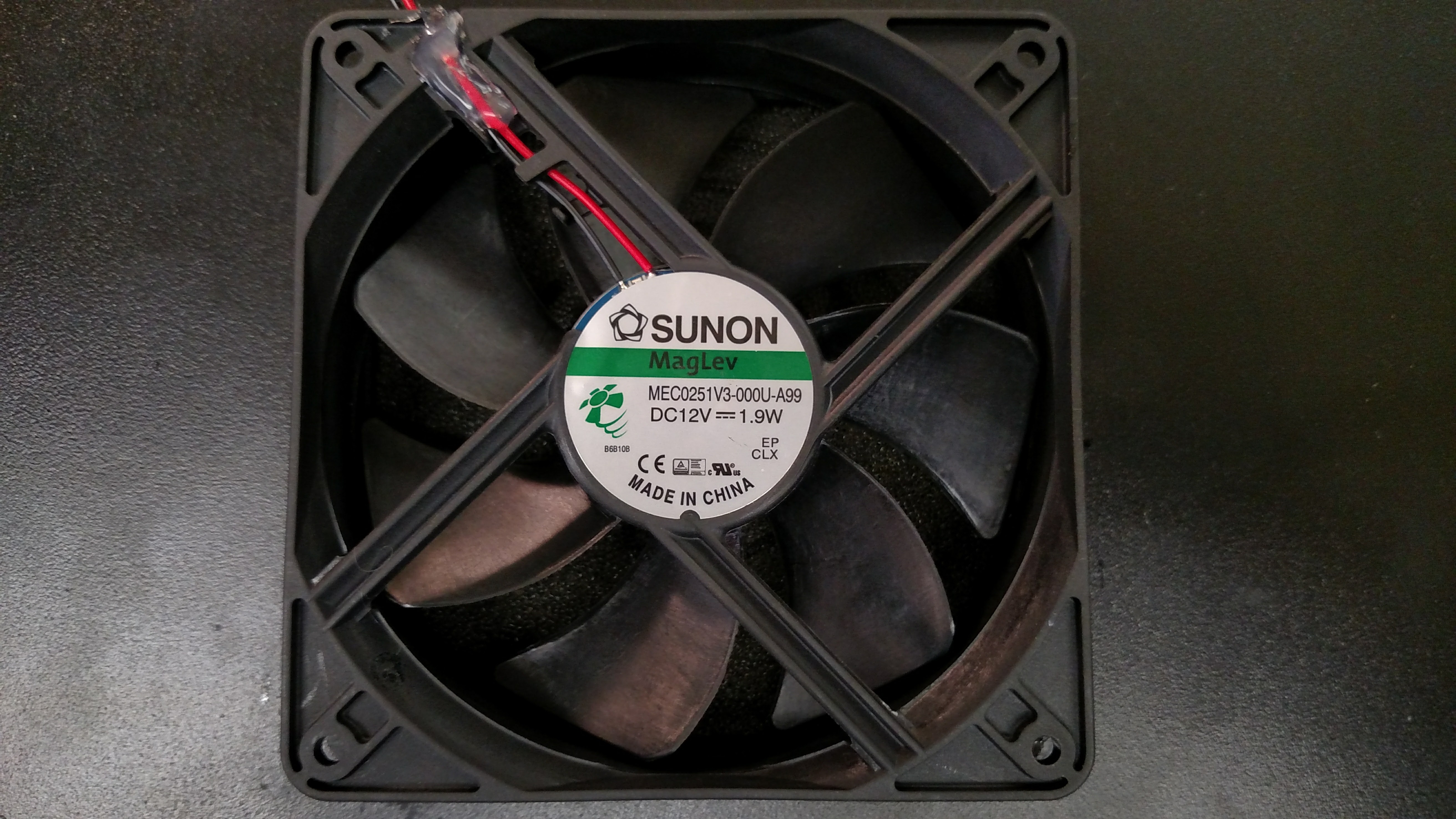

Carl,
It's your lucky day. It just so happens that by some miracle I have handy a photo of the fan that is inside the 8000 here. Can't say for certain it'll be the same in your 8000, you will have to take yours apart to be sure, but it's a data point for you. It's probably low risk to match it or cross reference a different part number. If you are going with a different part number, be sure to check that the fan performance curve for the replacement fan is equal to or better than the old fan.

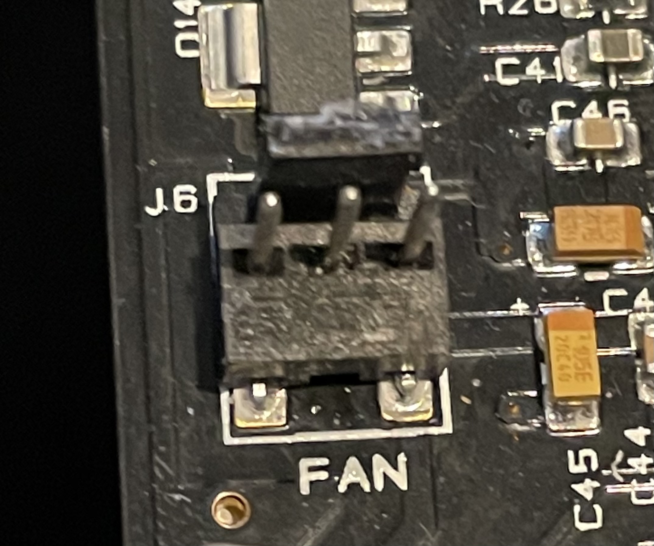

I pulled the bottom cover off and removed the noisy fan and dirty air filter. Then removed the top cover and cut the glue off the connector and removed it. The new fan came with a two pin connector which was not compatible with the three pin mount on the PA board. I cut the three pin connector off the old fan and soldered it on the new fan. I installed the new fan and replaced the covers and the fan wasn't working. :-( Took it all apart again and checked the pins on the PA board with a meter and nothing, no voltage. The only thing I can see left to try would be to reflow the PA board fan connector. I tried the old fan with bare wires to the pins and it didn't spin either. What would you recommend at this point?

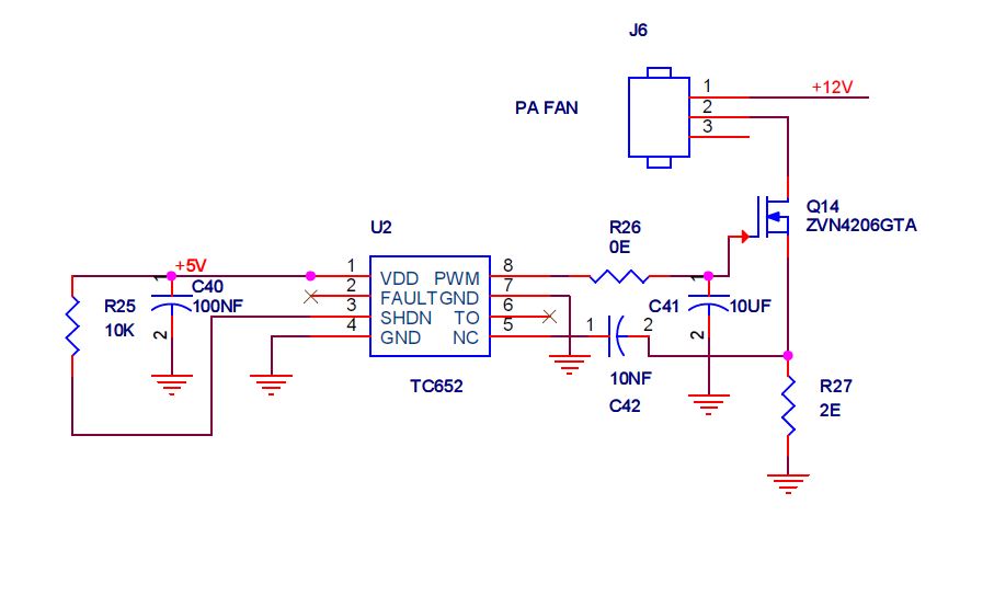

On the 8000 the fan is operated by a TC652 fan controller IC, located on the PA board. See the schematic snippet below.
It may be that the unit has not become warm enough to operate the fan. I don't know exactly which part number Apache selected, however if you look at the full part number and then reference Table 3-3 in the datasheet (follow the link above) that should tell you what the low threshold temperature is (and I'd be interested to know). However I suspect it is 25C and the fan will be shutdown below that temperature.
You could use a heat gun to heat the chip and see if the fan turns on.
It is also worth noting that on the 8000, and the early 7000's, Apache used a FET to drive the fan, not a BJT per the recommendations in para. 4.1 of the datasheet. This alone can make the fan sound noisy sometimes.

I did run the radio after installing the new fan. I had it up to 35C at one point and never heard the fan run. In the shack it can get above 25C (usually 26 to 27C) before ever transmitting. My thought was I may have over stressed the header removing the hot glue and broke a solder joint, that's why I ran reflowing the header by you. thoughts?

FYI.... I reflowed the fan header and it's working now.

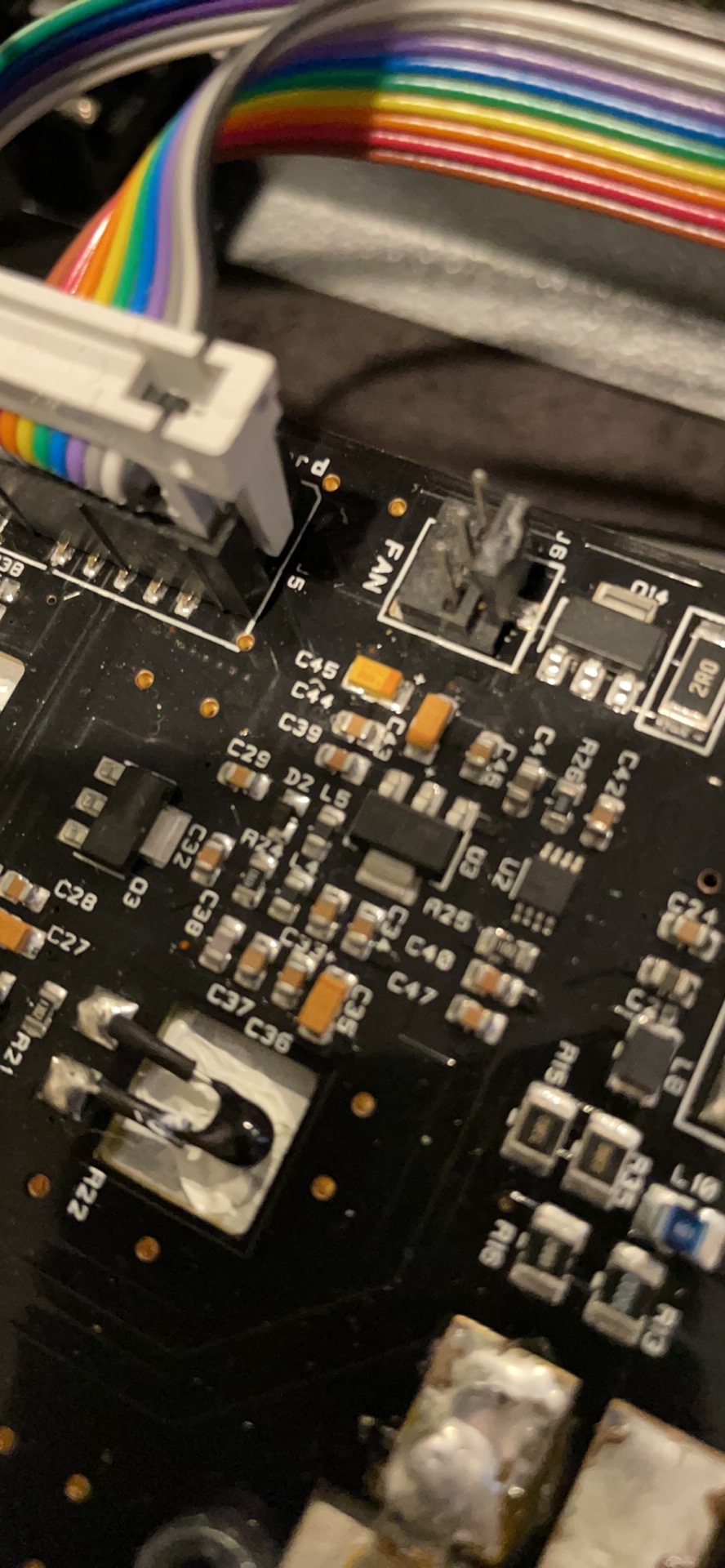

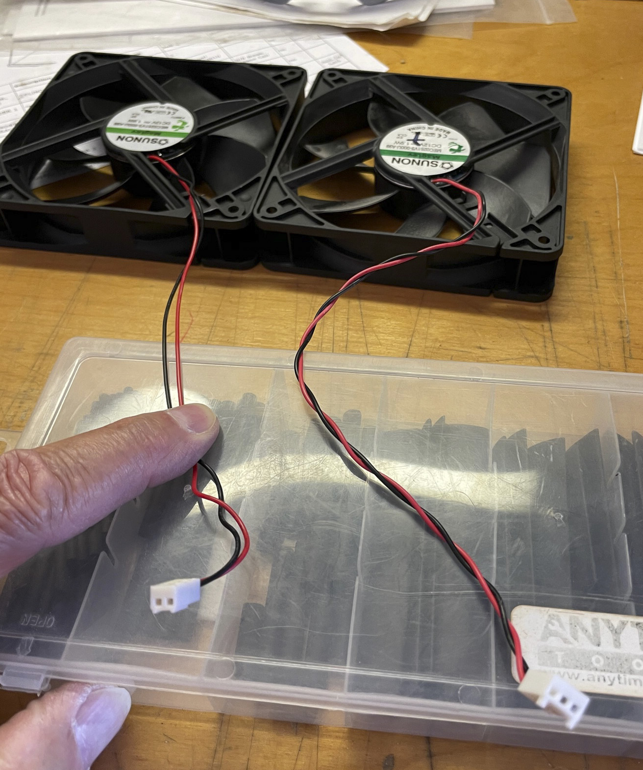

Postby cLicari » Mon Nov 09, 2020 3:44 am
w-u-2-o wrote:Glad you got it sorted :)
Did you take any photos that you could post?
Old-New fans0.JPG (511.83 KiB) Viewed 33100 times
LDMOS_PA Board.jpg (336.71 KiB) Viewed 33100 times
