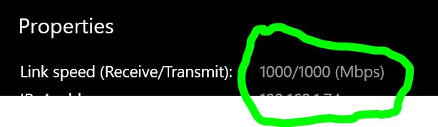

Postby VE2JN » Tue Jan 07, 2025 3:20 pm
right light (green flash) and left green stay on
Re: Anan 100 no ip
Postby w-u-2-o » Tue Jan 07, 2025 5:16 pm
Is the ANAN directly connected to the PC?
What you look at the properties of the connection on the PC, what does it say?
