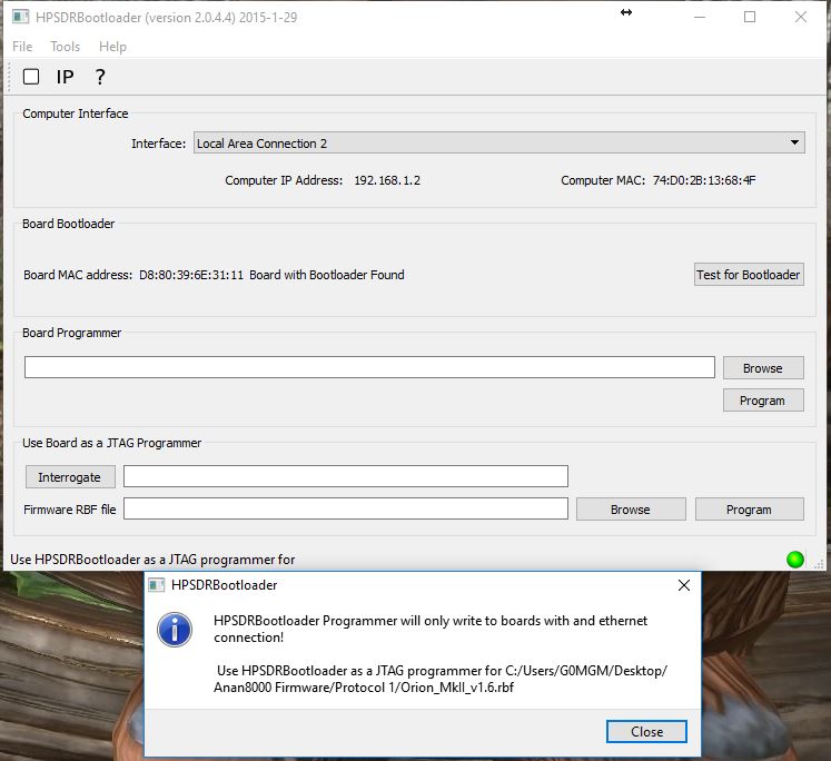

I thought I would try the new Protocol 2 F/W and Thetis, but seem t have bricked the Anan.
First I tried the HPSDR Programmer by upgrading to Protocol 1 ver 1.6. That worked fine.
I then tired to use it to Upgrade to Protocol 2 ver 1.2rdf but the Programmer could not find the radio after doing the erasing stage.
I then upgraded to the latest version of Bootloader ver 2.0.4.4, turned the radio off, flicked the switch on the back, and ran bootloader, Win_pCap was already installed. It can find the radio but when I try to program it by clicking Browse in the Board Programmer section I get the error message attached...
Any ideas?

See this thread.
Most likely you need to rename your rbf file "metis.rbf".

Thanks Scott. That worked. Now back on Protocol 1 but will try 2 later. I not seem to remember reading something a long time ago about having to rename these files for the Orion boards. Never had to do that for the Angelia.
