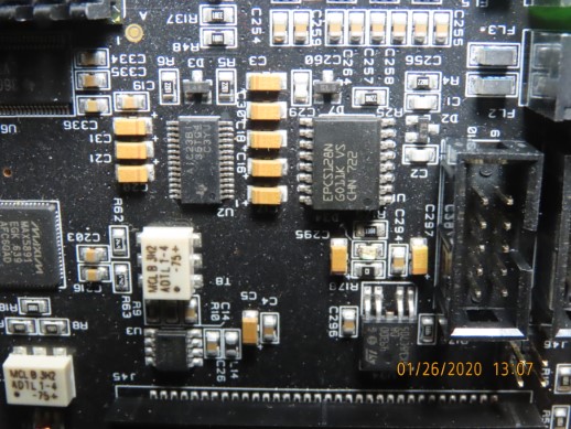

I inspected the radio as per your instructions and I see I have the EPCS chip and in fact no jumper. I was using the winpcap and not the win10pcap... but I didn't rename the rbf to metis. The switch is a netgear GS605v2.
Having said all that, whats next.

Re: Maybe Bricked my 7000dle
Postby w-u-2-o » Sun Jan 26, 2020 9:14 pm
tomsttsa wrote:I inspected the radio as per your instructions and I see I have the EPCS chip and in fact no jumper.
That is correct.

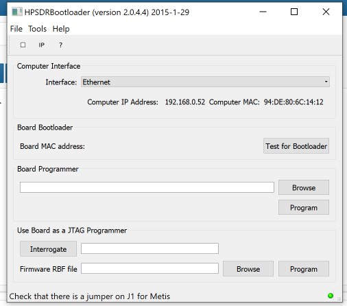

I confirmed that I am using the suggested version of winpcap.
I tried HPSDRBootloader with both switch positions and I did it twice in each instance. Once by running the software and then turning on the anan and once by turning on the anan and then running the software.
I also ran HPSDRBootloader in administrator mode.
The netgear switch port is green indicating gigabit speed, other wise it would be amber indication a slower port speed.
The interface pulldown has nothing other than "Internet"
bootloader (Custom).jpg (41.76 KiB) Viewed 49454 times
Postby w-u-2-o » Mon Jan 27, 2020 9:15 pm
tomsttsa wrote:I confirmed that I am using the suggested version of winpcap.
Good.
When you start the software makes no difference. The software does not do anything until you press the "Test for Bootloader" button.
This also makes no difference.
If this is the indication you are getting on the port the ANAN hardware is plugged into, then this does suggest that something is wrong with the ANAN. Bootloader should boot into a 100BASE-T condition.
And you tried it with a direct connection.
I'm running out of things to suggest. It may be time to buy a JTAG pod ("Byte Blaster", etc.) and get the Bootloader code and directions from Doug, W5WC.

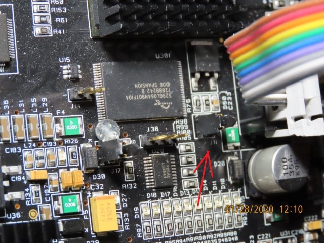

Many thanks to Doug W5WC for getting me fixed up with the anan. It turns out I didn't actually brick it, what happened was the previous owner had installed a relay and switch for puresignal and an amplifier, but instead of plugging in the "normal/bootloader" switch back into j17, they plugged it into j11 instead.
The arrow points to j11, to the left is j17
After I corrected that, I loaded protocol 2 but this hangs the computer when I click the power button, so I put protocol 1 back with v2.7, and we will take a deep breath and relax for a bit. The thetis issue will be for another thread...thanks to all for their help.
73 Tom

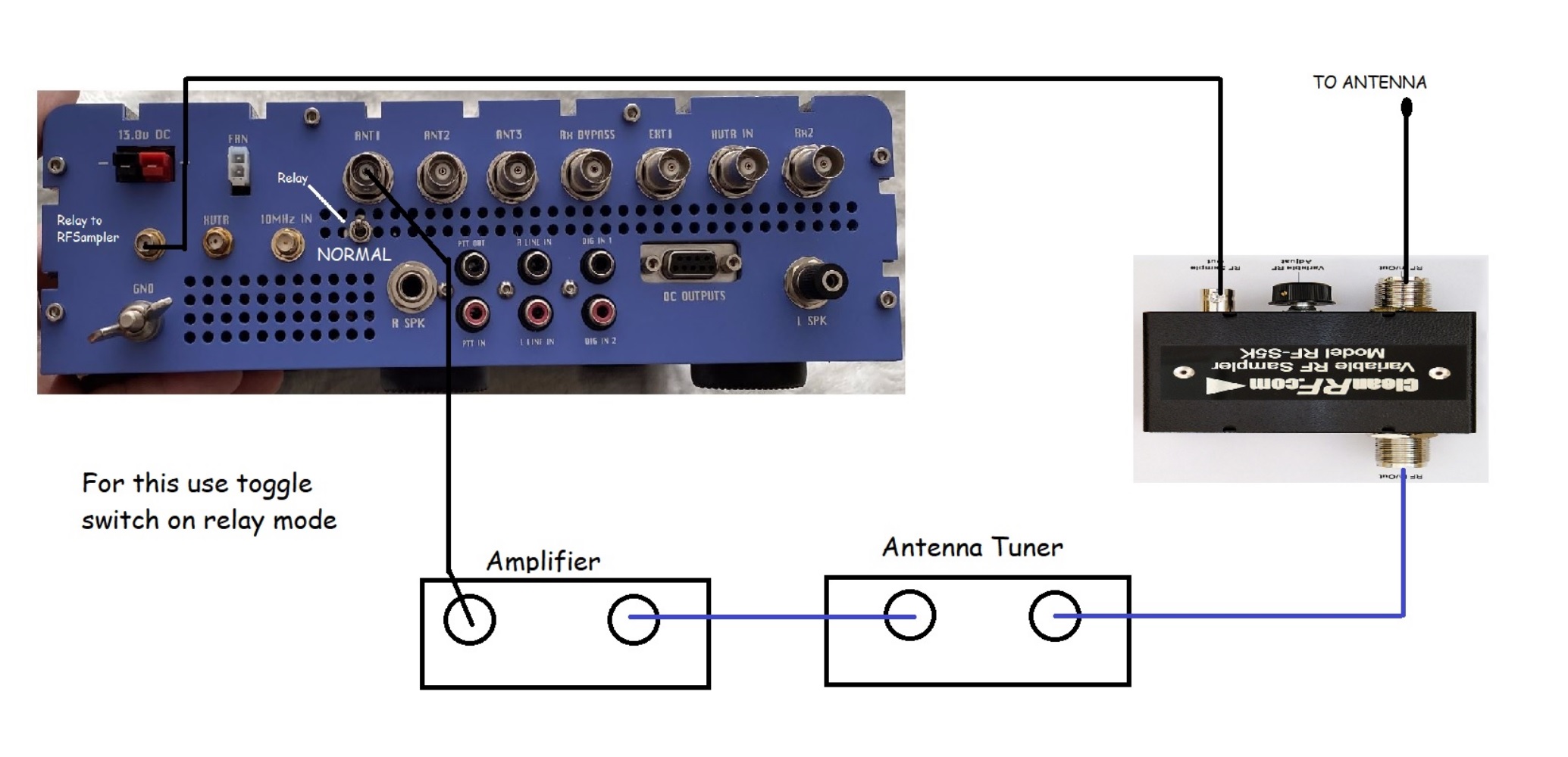

Postby tomsttsa » Wed Jan 29, 2020 3:44 am
Provide Pure Signal input from an external amplifier. I haven't really looked into it yet, I don't have an amp ....

tomsttsa wrote:Provide Pure Signal input from an external amplifier. I haven't really looked into it yet, I don't have an amp ....
That makes no sense. All 7000 series hardware is designed to do this out of the box, no modifications required. The amp coupler output goes to the Bypass input. Select "Bypass on TX" in the settings.
You should probably look very carefully at what the previous owner has done to this unit. He's already caused you one problem. There may be other skeletons lurking in there.

These pictures were supplied with the radio when I received it
Postby w-u-2-o » Wed Jan 29, 2020 4:42 pm
That's the old method that used to be used on ANAN-100D and the older -200D's that had the Rev. 15 and 16 RF/PA boards. The old revision boards had bad RF crosstalk performance which limited how well PureSignal works. Indeed my own -100D is modified this way.
But since the advent of the Rev. 24 board in the 200D that modification is no longer necessary. It is a solution looking for a problem.
It's actually a little sad that your 7000 was modified like that.
