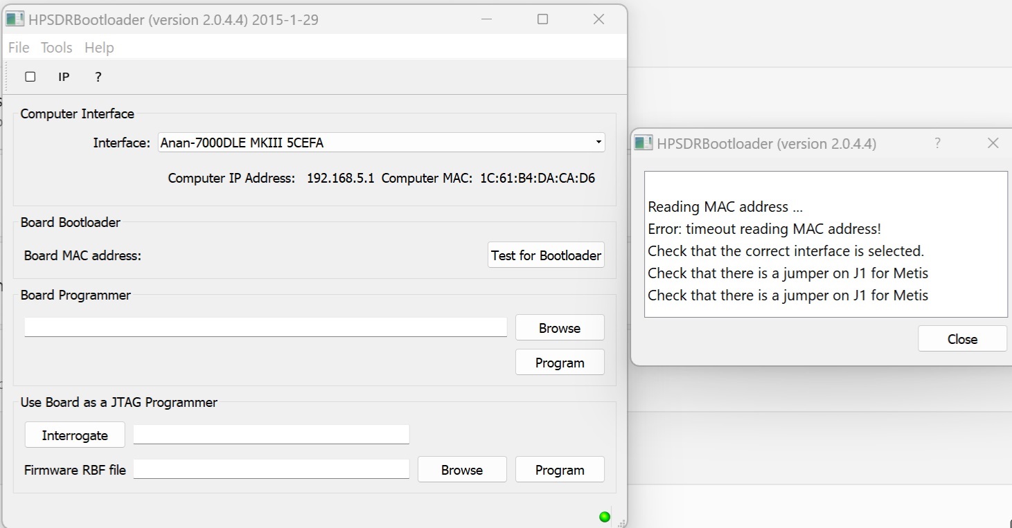

For those interested:
HPSDRBootloader v. 2.0.4.4 doesn't work on my Windows 11(Pro Version 21H2 build 22000.1098) computer, Although I run it as Administrator, when I click "Test for Bootloader" I get the message "Error: cannot open interface (are you running as root)."
In my case, HPSDRProgrammer v 2.0.4.0 worked, successfully flashing my 7000 DLE from protocol 1 firmware to 2.1.26 Protocol 2 (v 3.9).

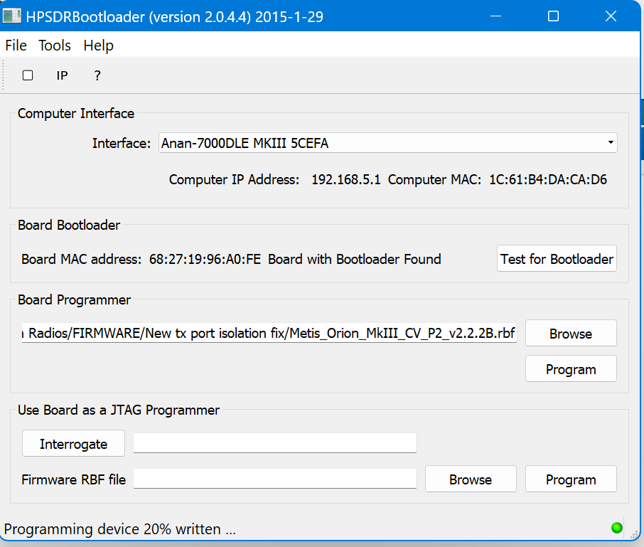

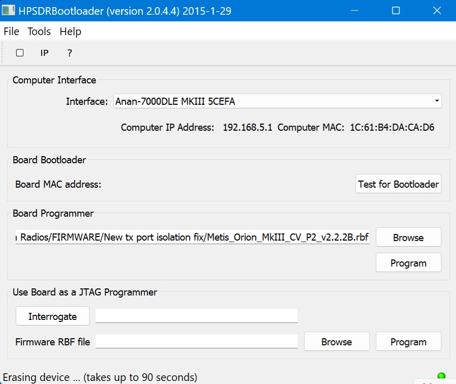

w-u-2-o wrote:Two NICs? Try disabling the NIC you don't need prior to running Bootloader (Settings > Network & Internet > Change adapter options, right click on the adapter in question). You won't break anything by doing this, you can simply enable it again when you are done.
Ok I tried disabling the other NIC. And wifi and bluetooth to be sure. But the same was happening. When I press "test for bootloader" I see the network light on radio blink.
hpsdrbootloader 2.jpg (158.9 KiB) Viewed 30426 times

Postby n2gq » Mon Feb 05, 2024 9:33 pm
Found the problem. The switch isn't working. Going to replace the switch.
