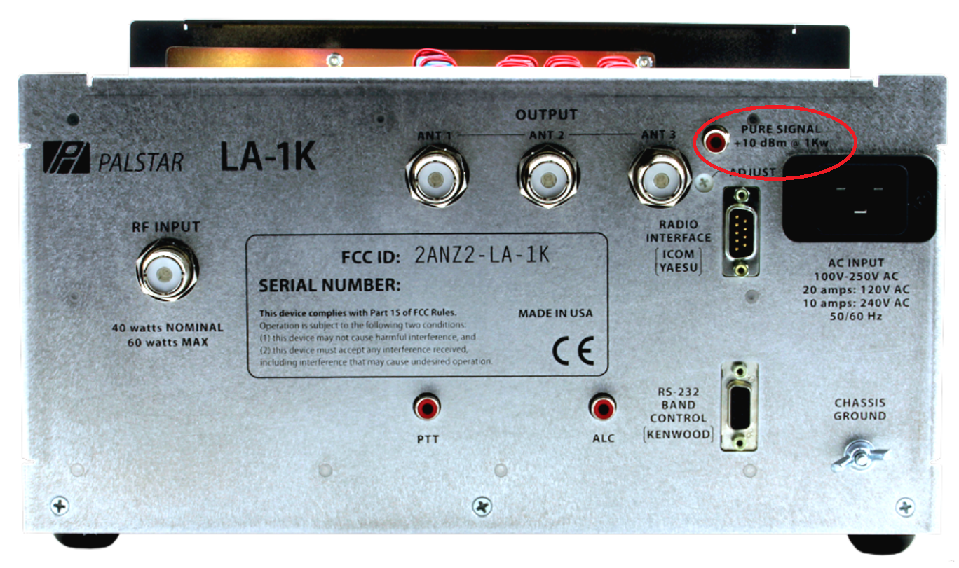

I recently just received my Palstar LA-1K and noticed it has a Pure Signal Jack on back, anyone using it and how would it connect to the Anan 7000 MKII Black?

If it were me I'd just run a cable between that jack and the Rx Bypass jack on the Anan.
It'd need to be a custom cable, with a BNC connector on one end and an RCA plug on the other end.

Mark is correct, of course.
You need to set the "Bypass on TX" option in the settings so that the radio uses the external feedback signal instead of one from the internal coupler.
