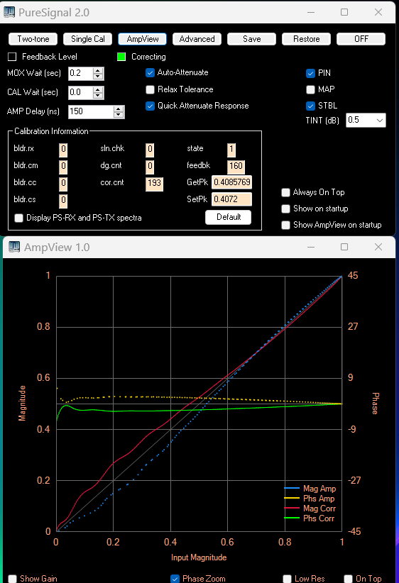

Postby lauchlin » Fri Feb 23, 2024 1:05 pm
Have not ever look at the amp view till the other day and i am sure by looking at others this is not right ?

1) What do you think isn't right about that graph?
2) Where did you get that SetPk value?

Postby lauchlin » Fri Feb 23, 2024 1:55 pm
The Dotted line dose not seem right others i have seen are solid lines ..
Setpak value i never set .

Postby K1LSB » Fri Feb 23, 2024 2:53 pm
I've noticed the dotted lines when I use TwoTone to trigger PS correction. When I'm using voice to trigger PS the curves are solid.

Postby w-u-2-o » Fri Feb 23, 2024 4:41 pm
There's nothing wrong with those results if you are using two-tone. As previously mentioned the dotted line is an artifact of the two-tone waveform. What power level was being used when you grabbed those screenshots?
However, you may want to revisit your SetPk value. Make note of the current value, then press the default button and see if it changes. If it does change, take a fresh look at the performance of PureSignal with the default setting for the 200D. If you are not happy with that then just put old number back in.

Postby lauchlin » Fri Feb 23, 2024 6:17 pm
Thank you guys i am using two tone @ 45 watts and the setpak values are my default.....

Postby Warren_NR0V » Fri Feb 23, 2024 11:07 pm
The curve shapes are very reasonable and the dotted blue and yellow lines are fine. To calibrate, PureSignal collects samples as the two-tone (or voice) goes up and down through the range of possible amplifier outputs. Since these are "samples", they are distinct points, not a curve. A two-tone is repetitive and so the samples may fall at the same places multiple times. Voice is much more random and the samples tend to be more dispersed, eventually filling in what appears to be a curve but is actually just a collection of points.
In contrast, the "correction" lines (red and green) should be solid. These are plots of the correction curves calculated by PureSignal in response to the input samples (blue and yellow) it received.

Postby Warren_NR0V » Sat Feb 24, 2024 4:39 pm
The correct value of 'SetPk' is ONLY dependent upon the firmware in use. It does not depend upon the coupler, or any other hardware or parameter. As of this date, there are three different values of 'SetPk':
ANAN-G2 (protocol_2): 0.6121
All other protocol_2: 0.2899
Protocol_1: 0.4072
Thetis should set this value automatically, depending upon the radio selection and firmware in use. However, I understand there has been a recent bug and that might not be happening in all cases.

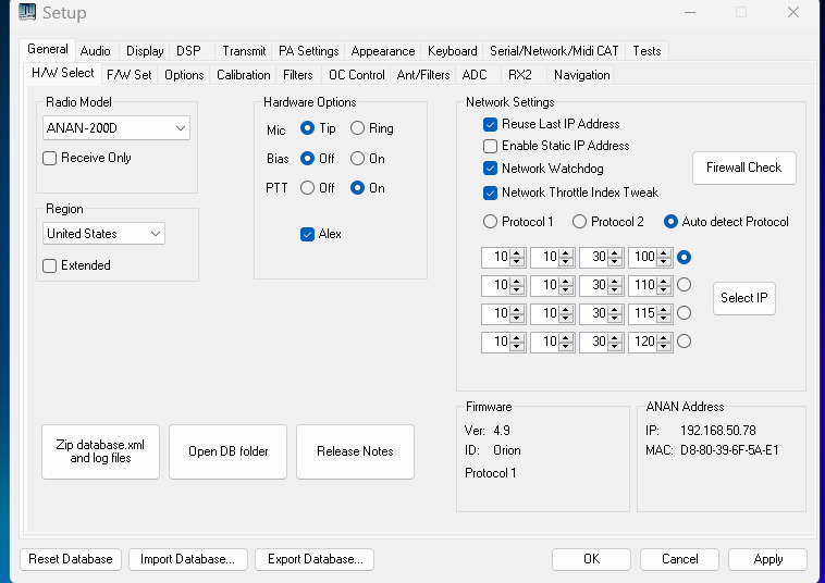

Postby lauchlin » Wed Feb 28, 2024 1:53 pm
I am running protocol 1
pro 1.png (30.9 KiB) Viewed 12556 times
Re: anan 200 d amp view
Postby w-u-2-o » Wed Feb 28, 2024 2:31 pm
lauchlin wrote:I am running protocol 1
So many of us have gone to P2 that we've obviously forgotten that .4072 is the correct value for SetPk under P1 :)
