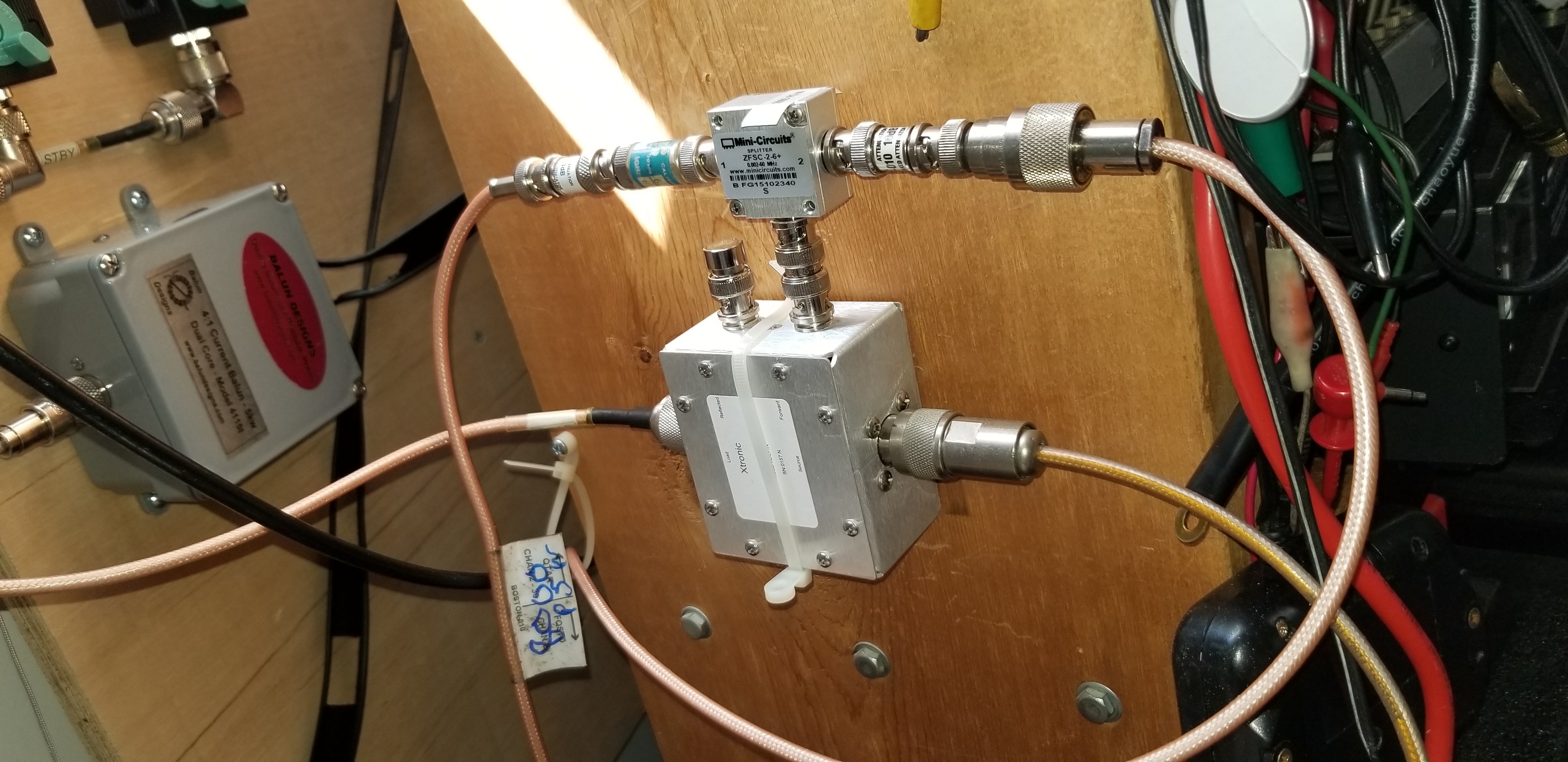

I settled on using the Xtronic coupler feeding a mini circuits 2 way bnc splitter to feed 200D and 8000. Added appropriate attenuation to each radio added to 3db loss in splitter.

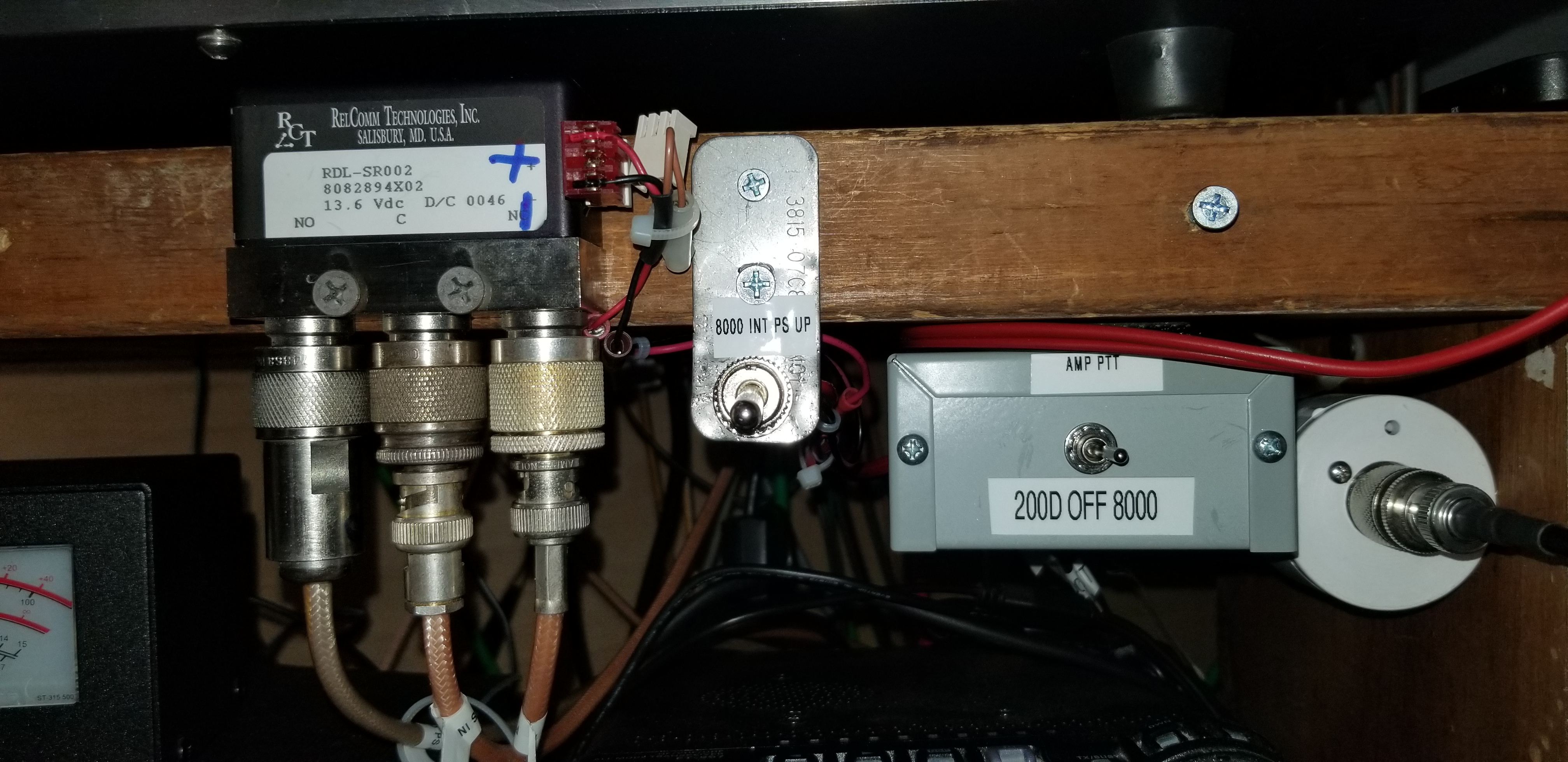

Used relay for quick use of internal 8000 ps feedback but not needing it much. Shown also Ptt select to amp for each radio.
Relay and PTT Switch

One more pic of coupler and splitter.
