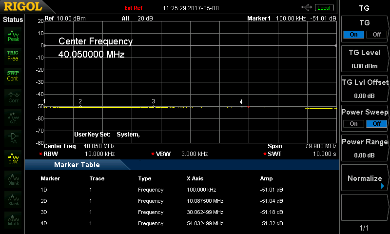

Postby FM5GB » Tue May 09, 2017 9:51 pm
Hi Liam,
Have a try with the sampler proposed by Hauke VK1HW (to be found on his site
at : https://sites.google.com/view/vk1hw/hom ... rf-sampler . It needs no
PC board and has very fews components. I built one (using an Amidon FT50-43 toroïd) and
see the flat response it has 100 kHz to 80 MHz on my spectrum analyser :
73s Phil FM5GB
Sampler 51 dB 100 kHz to 80 MHz.png (55.62 KiB) Viewed 186268 times

Re: External feedback level calculations
Postby w-u-2-o » Wed May 10, 2017 2:06 am
Beautiful results there, Phil! I wish I had a Rigol spectrum analyzer, too :mrgreen:

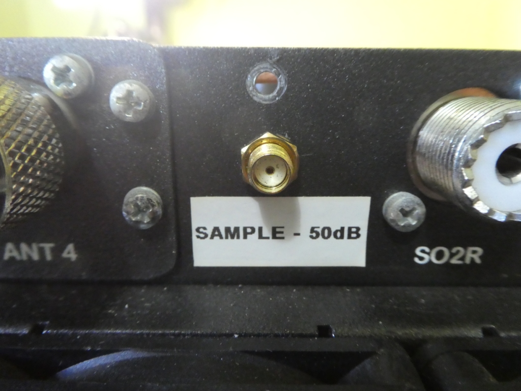

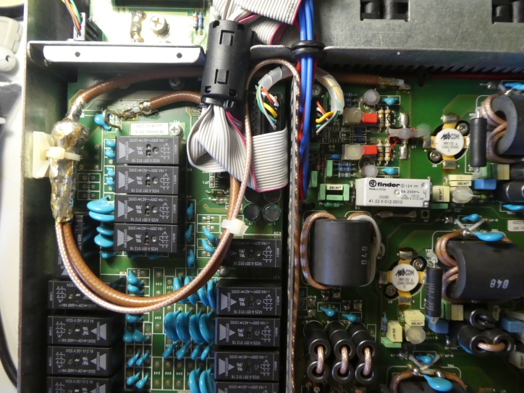

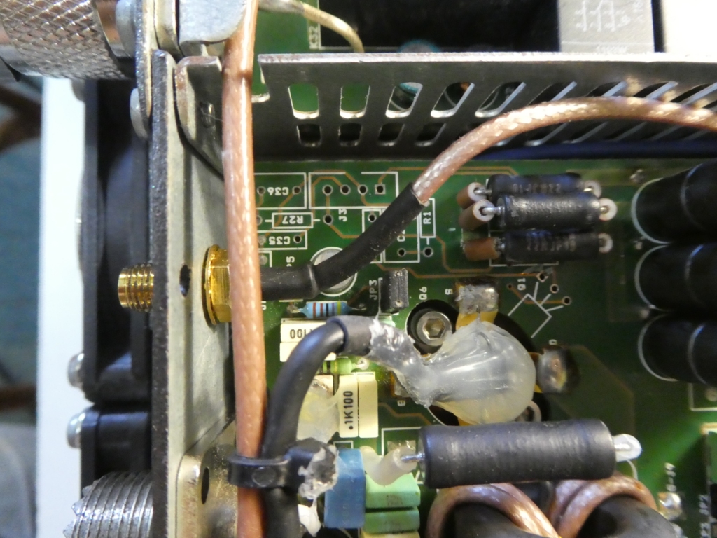

I've forgotten to post pictures of my sampler. I finally decided to built the sampler inside the SPE Expert 1K-FA amplifier.
There is not much room inside and I wanted to insert the sampler between the amp final stage and the built in ATU.
So I built it direcly on a piece of military grade coax (M17/60 RG 142 wich stands 2.5 kW @ 30MHz). The toroid and the two resistors
are wrapped in teflon tape and shielded with copper foil. Sample is 50 dB down from the outpout (that's +10 dBm @ 1 kW and -10 dBm @
10 W output) To run safe I added a 10 dB SMA attenuator in the sample path to the orion board.
Correction is green between 10 W & 1 kW; S-ATT values range -19 to 0 dB. Correction yields 50 dB suppression of 3rd order products on all bands.
Only draw back : the amp has to be switched ON (operating or standby) to have the outpout pass thru the ATU. If the amp is switched off input
is diretly fed thru not going thru the sampler.
73s Phil FM5GB
