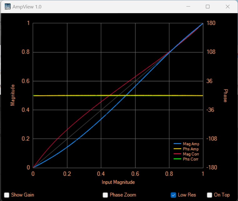

Update: Doug found a bad PA final in my radio, he replaced both finals and PS is working fine now on all bands.
Here's PS on 20 meters at 41 watts, internal sampler (curves are very similar at any power):
Thanks to everyone in this thread who offered their assistance.

as the difference between 20 m and the other bands is rather extreme, have you considered checking the filters that are in the transmit path? As a dummy load is used that would not discriminate between bands, nor does the firmware. But a faulty filter could, or a filter switch not happening and the wrong one being active.
