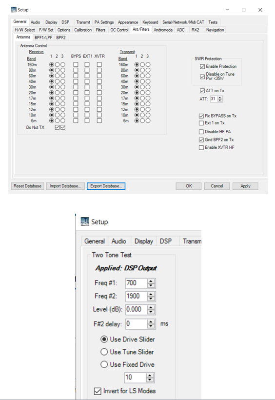

Below, see a screen capture of two forms. Should you note something that is off or incorrect, let me know. NOTE: The "ATT on TX" setting is very high. I played with it several months ago as I thought that what I was seeing when DUP on the main GUI is set (I have it ON always) was a very wide TX bandwidth, but that is only "normal" and I think I will need to adjust it back to its default value (I don't recall what that value was). I see some of you have it set at 0. When "Rx BYPASS on TX" box is checked, the transmission looks completely different of course, no matter the ATT value so I guess I don't need to mess with that setting after all.
Q1: If I have understood the PS correctly, after I have gotten the PS working at max 1.5kW RF out, can I assume that linearity of the output from the amp will be equally good at 1kW or say 800W?
Q2: I also operate CW quite often and am wondering what kind of benefits I can expect on that mode? My thinking is that the benefits are more "clear-cut" when using wider bandwidth modes such as SSB, correct? I don't operate RTTY or FT8 for instance (might, in future).
Q3: S-ATT levels: I will need to re-read the discussions on the levels as I think that I need to be careful with this parameter and how to set it correctly.
Q4: I recall seeing Scott recommending that I should be hitting the ALC hard and that I should see "ALC Group" figures of 0dB on a consistent basis and perhaps even +3dB at times. This, to enable the PS to work well (Scott had a more expert and technical way of saying this). I also see someone else talking about having the meter set for MIC, with recommended figures to hit (max 0). Which of these 2 parameters should I go by and what are the pros & cons of using either?

Thank you for your detailed and well thought-out response. Below, a couple of follow-up questions.
My current “ATT on TX” setting (31dB)
“This will automatically change under control of the PureSignal "auto attenuate" feature. If you are not using PureSignal yet, or for some reason turned auto-attenuate off (don't!), then this will remain where you set it.”
**Which form do I use to turn “auto-attenuate” ON?
**So, when I am not using PS the "Rx BYPASS on TX" box needs to be UNCHECKED. I believe that’s the default setting.
It would be nice if the “Rx BYPASS on TX” would get checked automatically when one switches to the “PS” mode so that one doesn’t have to rely on one’s memory.

Re: New to PS Use (ANAN 7000 DLE MK2)
It is on by default. The setting can be found by clicking Linearity in the top menu bar. If you don't see it then click the Advanced button to open the full Linearity menu.JJ4SDR wrote:My current “ATT on TX” setting (31dB)
That is incorrect, not what I wrote, and it is not the default setting AFAIK.**So, when I am not using PS the "Rx BYPASS on TX" box needs to be UNCHECKED. I believe that’s the default setting.
The Bypass on TX option has nothing to do with PS being on or off. It has to do with routing the feedback signal. When it is off RX1 always receives PS feedback from the internal coupler inside the ANAN. This configuration is used when there is no external amplifier or external coupler. To route the feedback signal from an external coupler to RX1 during TX this option needs to be on. So it needs to be set according to where the feedback signal needs to come from, internal or external coupler.

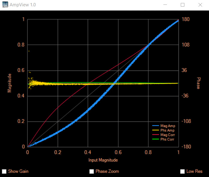

Below, see Amp view from my very tests of Pure Signal. The meter is showing +3dB (+4dB VERY rarely) on peaks when I observe the "ALC Group" parameter. Can someone comment on the graphs? Seems like I will need to do some "tweaking" somewhere. I was putting out about 1kW (15 meter band). The second image - at bottom of page - is the Amp View is when I went on 17 meters (putting out almost full-legal limit). On 20 meters, I am not getting good enough feedback at all.
Q1: Do I need to carry out the two-tone calibration for every band that I operate the amp on?
Q2: Can I assume that once I have successfully conducted two-tone tests I don't need to redo any of it and just switch Pure Signal on from the main GUI?
That's perfect.JJ4SDR wrote:Below, see Amp view from my very tests of Pure Signal. The meter is showing +3dB (+4dB VERY rarely) on peaks when I observe the "ALC Group" parameter.
In general the characteristic S shape you are seeing is very good, very normal, and generally indicative of the normal non-linearity of the average amateur radio amplifier.Can someone comment on the graphs? Seems like I will need to do some "tweaking" somewhere.
However, the data looks a little noisy.
The noisy data, combined with this statement, implies that something is not correct in your setup.On 20 meters, I am not getting good enough feedback at all.
- Is auto-attenuate enabled?
- Is Atten on TX enabled?
- Is RF Bypass on TX enabled?
- Is the cable between the amp coupler output attached to the RF Bypass input?
- Are you seeing the Feedback and Pure Signal 2 indicators turn bright green as shown?
- MOST IMPORTANT: what are you seeing on the S-ATT display during TX?
No. PureSignal is automatic when the PS-A button is illuminated. Two-tone is only for testing, or for when you want to make a manual correction using the Single Cal method.Q1: Do I need to carry out the two-tone calibration for every band that I operate the amp on?
Once you are satisfied from testing that your configuration is correct and behavior is normal on all bands, you no longer need to do any testing using two-tone. However, two-tone remains valuable for testing drive levels. My typical work flow when switching to a new frequency is as follows:Q2: Can I assume that once I have successfully conducted two-tone tests I don't need to redo any of it and just switch Pure Signal on from the main GUI?

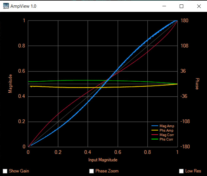

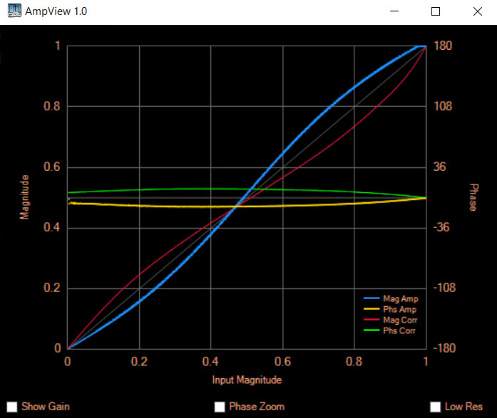

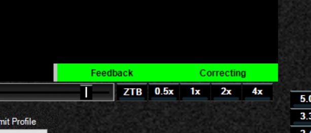

Thanks for your response.
To your 5 questions (under "Noisy data"), the answer is YES to all of them.
Went on 20 again and this time I let the 2-Tone test run for a little longer (took a bit longer than it did on 17 and 15). Both Feedback and Pure Signal2 were in the green with S-ATT reading saying 18 on that band.
The S-ATT reading says 17 (under AGC, it says "Med", not "Custom") when transmitting and Feedback and Correcting (Pure Signal2) are all green.
18 dB is a perfectly acceptable step attenuator setting for PureSignal during TX. It sounds like it is all working perfectly and you are just getting used to how it works.
Assuming you were transmitting at 1500W, the 18 dB step attenuator setting arrived at by the auto attenuate implies a 55dB loss in the coupled path from the amp output, which is exactly what you would expect, so all is well. The math can be found here.
AGC is a receive setting (obvious, I hope!) and it's just incidental that it was shown in my screen shot. Set it to whatever works best for you.

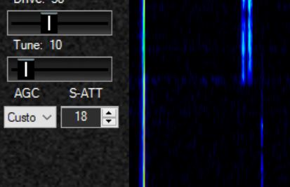

AGC: Yup.....I know. Don't know what got into me
I went on 20 meters and talked to a fellow told me I was +40dB/S-9 and had a Panadapter for visualizing my signal and when I switched the PS on and OFF he was blown away by how clean the TX looked.
Is there a way to ensure the Rx BYPASS on TX box gets checked automatically when using PS? I never had it checked prior to starting the use of PS.
Thanks again very much!
