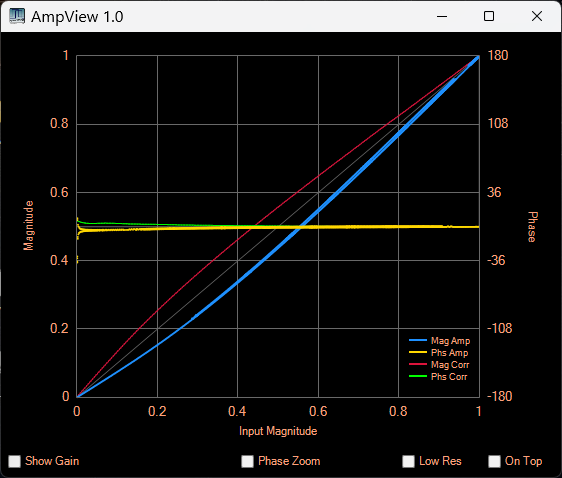

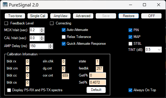

Well the p1 ver 5.0 firmware didn't do the job but I'm still looking What was strange to me was what I saw in the Linearity/AmpView screens.
The plot in the AmpView screen was no different at 100 watts then it was at 15 watts with a green/150 feedback indication. These screen shots were snapped while running PS at 100 watts.
