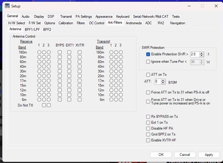

Thanks for confirming this. I do have an external amp and realise I need to use a coupler to do this correctly but in the absence of that, I imagined I would see the feedback turning blue/greep at the bottom right of the watefall, however I don't see any change when txing?
Am I missing something?
Screenshot 2024-10-27 at 14.38.58.jpg (98.68 KiB) Viewed 7082 times

g6phf wrote:Thanks for confirming this. I do have an external amp and realise I need to use a coupler to do this correctly but in the absence of that, I imagined I would see the feedback turning blue/greep at the bottom right of the watefall, however I don't see any change when txing?
ATT on TX needs to be enabled so that PureSignal can perform automatic attenuation control. And, of course, the PS-A ("PureSignal Automatic") button needs to be activated on the main console UI.
Testing is most easily accomplished by transmitting a two-tone signal with the two-tone button on the main UI.
