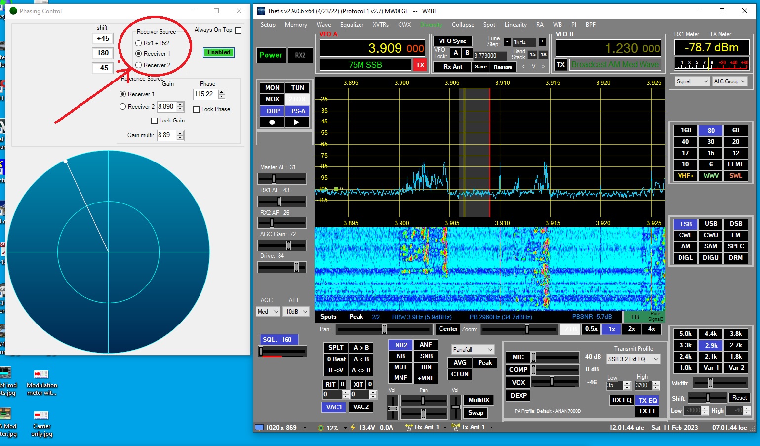

Another feature of the Diversity Tab is the ability to instantly swap between Rx 1 and Rx 2 and still retain the Display - as opposed to the split feature if activating RX2 separately (and having to select VAC1 or VAC2)
Simply select either Rx 1 or Rx 2 as the Receiver Source.
- Diversity.jpg (474.6 KiB) Viewed 19929 times
