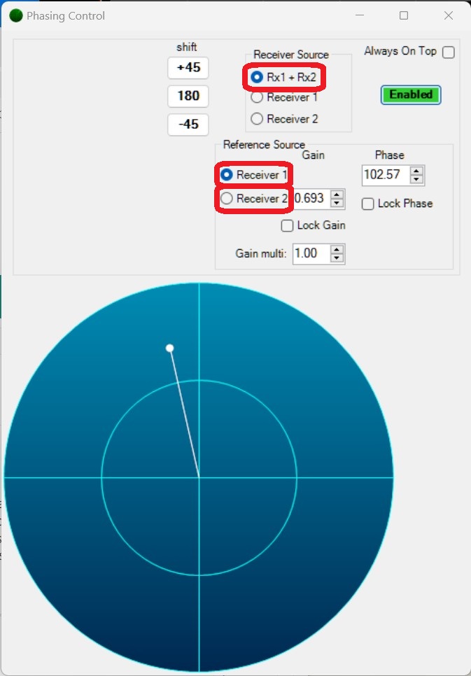

Depending on the band I'm working, I may need to change one or more of the options in the Phasing Control panel:

Hello Mark,

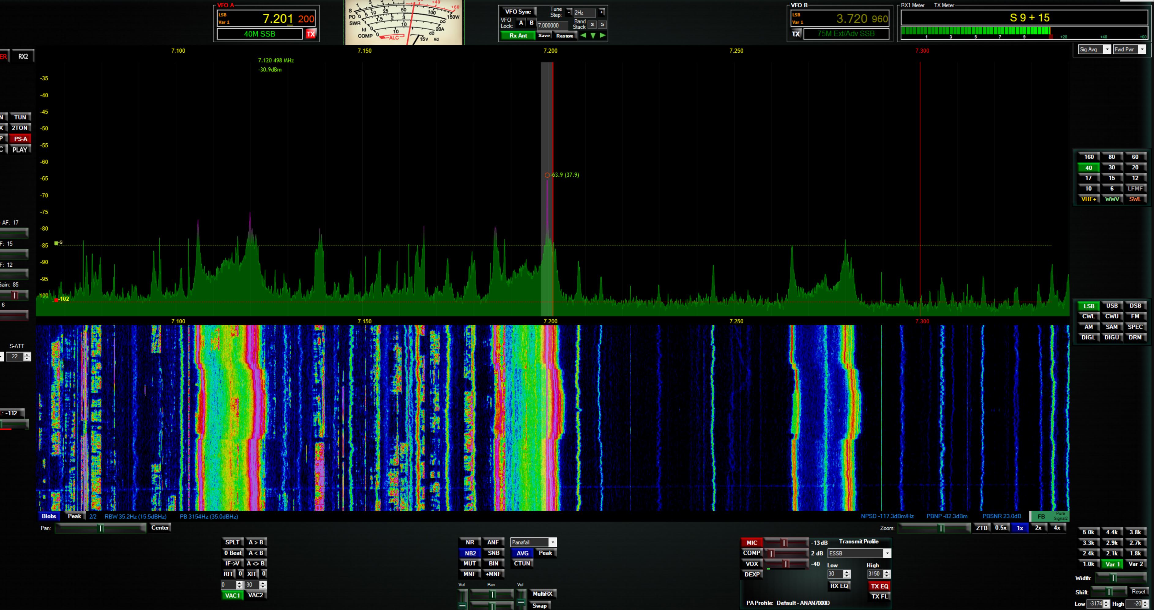

I have the same setup as shown in the screenshot. Today I switched the second antenna to the RX2 input and diversity started. work. However, this is a complicated process because a lot depends on the antenna and the type of interference. I decided to install a vertical external antenna, which will definitely improve the diversity operation to the noise coming from the outside. I am sending a screenshot of what it looks like on a day when the 80 m band is inactive. In the evening, when there is progation, this noise is less. If you have any advice on which vertical antenna to mount to eliminate this noise, please.

- Noise.JPG (786.13 KiB) Viewed 31399 times
Re: Anan 7000 DLE MKII diversity not working
Set same band on both VFOs, A and B, or diversity will not work.
Thanks for the hint. Switched from 80m where diversity worked to show noise at 40m. At 80m I was reducing the noise and both VFOs were in sync.
