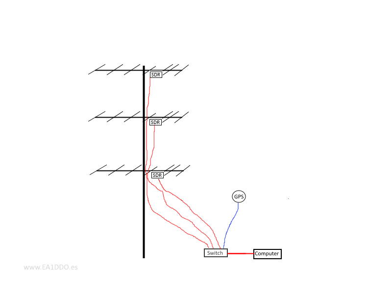

Maximo,
To be coherent, or phase and sample synchronized, you have to be much, much better than that.
Let's take a 20M frequency for example, say 14.2MHz. At that frequency, a 10 degree phase shift is equivalent to approx. 2nS.
That is why both ADCs need to be clocked from the same sample clock, and clocked at the same time, i.e. there should be no differential delay between samples.
Now our radios do allow for an external frequency reference, so you could feed each one from the same reference using a set of matched length cables. This would at least get everything on the same timebase. BUT...the radios have no mechanism for synchronizing their sample times.
That said, if you had two radios, both locked the same 10MHz reference, and two data streams, theoretically they would be phase locked at some random phase. You could then simply guess at the phase difference you needed to steer a beam by trail and error until you got what you wanted. With only two radios and two antennas this would not be too difficult. Indeed, that's what we currently do in our current dual ADC radios. Even though they are phase and sample locked, we just guess. However in your picture you have three antennas. That would be darn near impossible to guess at.

Re: Diversity Operations
So, there isn´t any way to clock two separated SDR ?
Certainly there are ways to do what you want, just not with the hardware and firmware that exists in any openHPSDR architecture radio, including Apache Labs radios.
There would need to be a sync signal in addition to the 10MHz, and it would need to be accurate to around +/-1nS, and/or there would need to be a way to calibrate the various receivers using a calibration signal to measure what the differentials are.

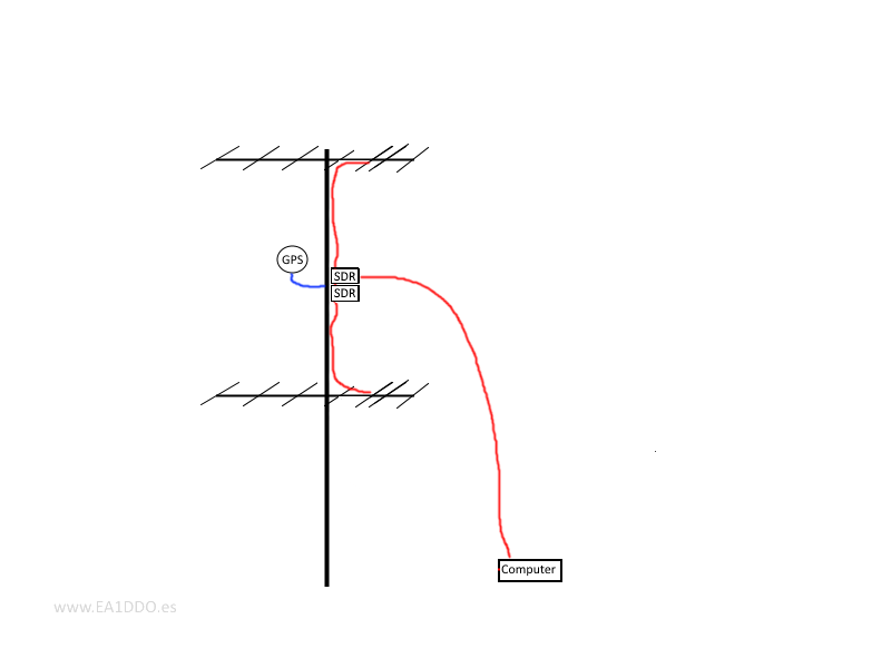

Then, an easier way; 2x SDR boards (Hermes, Orion, etc.), sharing clock, in same enclosure, let´s say back-to-back.
This way you get two coherent boards, with two coherent receivers and two coherent transmitters, starting point for beamforming.
Yes, you'd have to modify the boards to allow a single board to supply the same ADC clock to all ADCs. I have not studied the problem. Surely not a difficult technical challenge, however you may have to devise a buffer/driver circuit to ensure signal integrity.
Then there is the problem of writing firmware and software to exploit this hardware. There would need to be sufficient time tags embedded in the IF data streams to be able to match up the streams on a sample basis coming from multiple radios. Again, not a difficult technical challenge, there are thousands of DF systems around the world that do exactly that .

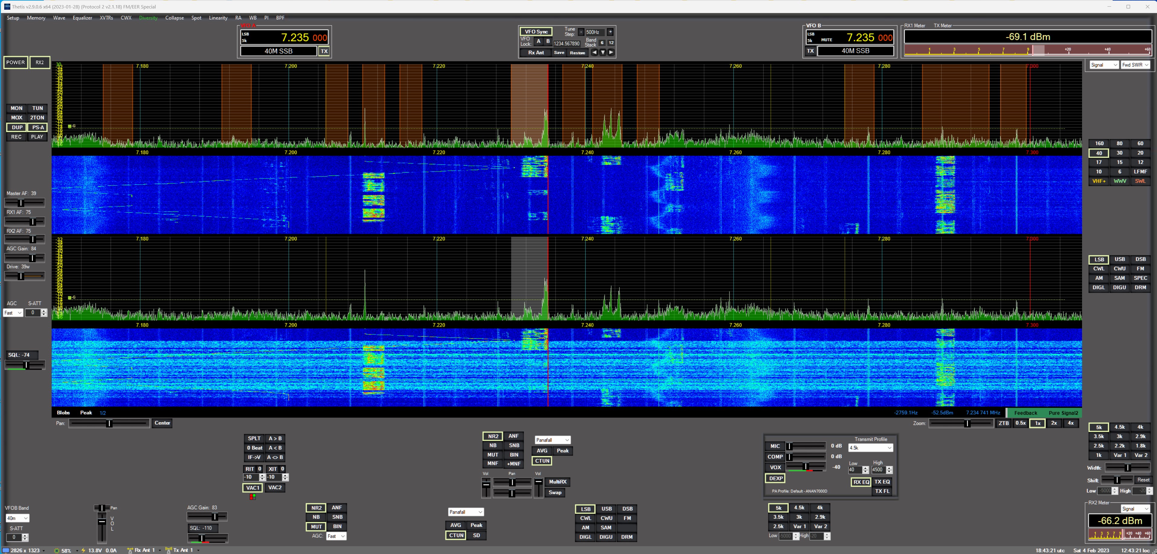

It's been awhile since I last visited this particular subforum ... I have 2 antennas on HF - for example on 15 I have 6/6 long boom monobanders and also a 4 element custom SteppIR.... so I once again revisited diversity. I have these nasty signals on 15 towards the west making difficult copy at times on SP/Asia. I'd LOVE to find out what the cause of this particular one is - its shaped like an obtuse triangle and the peak is S7 - S8 with the base being broad - maybe 5 - 8 Khz.
So I tried diversity again and WOW. FINALLY I have a way to get rid of these things .. AND reduce the baseline as well. I made a video - I'll need to figure out some way to post it to Youtube. There's no sound (I don't port sound to the PC) ... but it's pretty obvious what is going on. I found a signal that was off the center point of noise (the noise repeats as well - all up and down this and other bands) close enough such that when properly set up/nulled using diversity you can see a) that the signal does not change in peak amplitude and b) the noise floor goes WAY down - nearly 25db down! From -90 dbm to -114 (2.6Khz bw)!
I have automated all my antennas and had planned on carrying this through to allow full diversity when desired ... I hope to finish it up in the next week or two pending work load. Just need to carry this ability through to 160 and 80.
sorry - misspoke there - the noise floor does not go down by 24db ... that nasty noise signal PEAK goes from -90 down to the (new) noise floor at 0-114db. Since these interference signals repeat and are broad the overall noise floor does go down a decent amount ... looking at the video it changes about 5 db.
I've not had a chance to look in to how to do it ... besides the fact that there is no audio... so I'll work on getting something better.
One reason why I did this is because the only video (on UT) that shows coherent beamforming doesn't show it WITH a signal! So I for one was left asking : but how does it work with a signal there? Thus my desire to confirm it not only eliminates the noise but it doesn't impact the signal.
here is a Dropbox link for anyone wanting to see it now... note a couple of things - although there is a signal there (for the first 2/3 of the video) you can clearly see if it happened to be where the peak of my noise is it would have been completely unreadable, not even know someone was there... 2) even though with the noise there as is - i.e. not on the noise peak but offset on other 'crap' ... although you can see peaks I can say that that signal was still difficult to copy. 3) You can clearly see the signal is completely out of the noise when "ENABLE" is hit - easy copy!
data: when I centered on the noise peak (not quite there in the video) the signal went from a -91dbm to -115dbm for a 24 db drop... AND the noise floor dropped by 5 db. One has to keep in mind - this is MY particular ugly scenario ... the improvement isn't that it made the floor any better , rather it is that the noise was very broad and clearly raised the noise floor everywhere...
One other comment: just to be clear - this feature is only "local" in nature - in 2 ways: 1) it acts on local noise, not sky wave and 2) frequency-wise it is somewhat narrow in response so one has to optimize at a particular frequency (the one of interest)... I don't know that it is overly broad once tuned at a particular point.
Yes - very cool. I played with it on FT8 ... that 'interferer' that i have I think you'd agree is a nasty one. I'd love to find out what is causing it - Plasma TV, grow lights ... haven't a clue ... It is worst on 15 and in that direction covers the whole band with the repetitive nature seen there (the next "peak" is just off the right at about 84Khz separation from the one seen - both up and down).
anyway on FT8 it would increase some signals (S/N as reported) and strangely decrease some. Not sure what is happening there. The antennas are at different heights with the 4 element SteppIR currently at 37' and the stacks for that band at 45/90. I probably should have used the bottom antenna alone with the SteppIR ... might have been more informative... the plan is (and has been), if I can get it done the SteppIR will be at 86' and I'll add 7/7 on ring rotors at 40/75' for 10M and an 8 element LFA 6 meter in the doing as well. Just need to come up with a reasonable 'reference' antenna for the WARC bands as trying to use one of the other yagis just doesn't work. The requirement that BOTH antennas see the offender well is paramount. I have parts for a 2 element SteppIR that I might put together in to a 2 element yagi and mount it on the rotating tower for this purpose.
No, this is not strange at all. You really have no idea what the composite antenna pattern is due to the beamforming. The two-element antenna array has not been engineered. You, me, and most people are just rolling the dice and hoping we get lobes and nulls where we want them. There is generally only one, sometimes two, phase and amplitude values that cause a deep null to form in the direction of an interferer. If the resulting lobes are not commensurate with the angle of arrival of the desired signal it's not going to work very well.anyway on FT8 it would increase some signals (S/N as reported) and strangely decrease some.
The easiest array to model azimuthally is a pair of verticals (dipoles or monopoles). If you are using a set of stacked Yagis that point in the same direction your are moving things in elevation. And so on. Simple two-element array stuff.

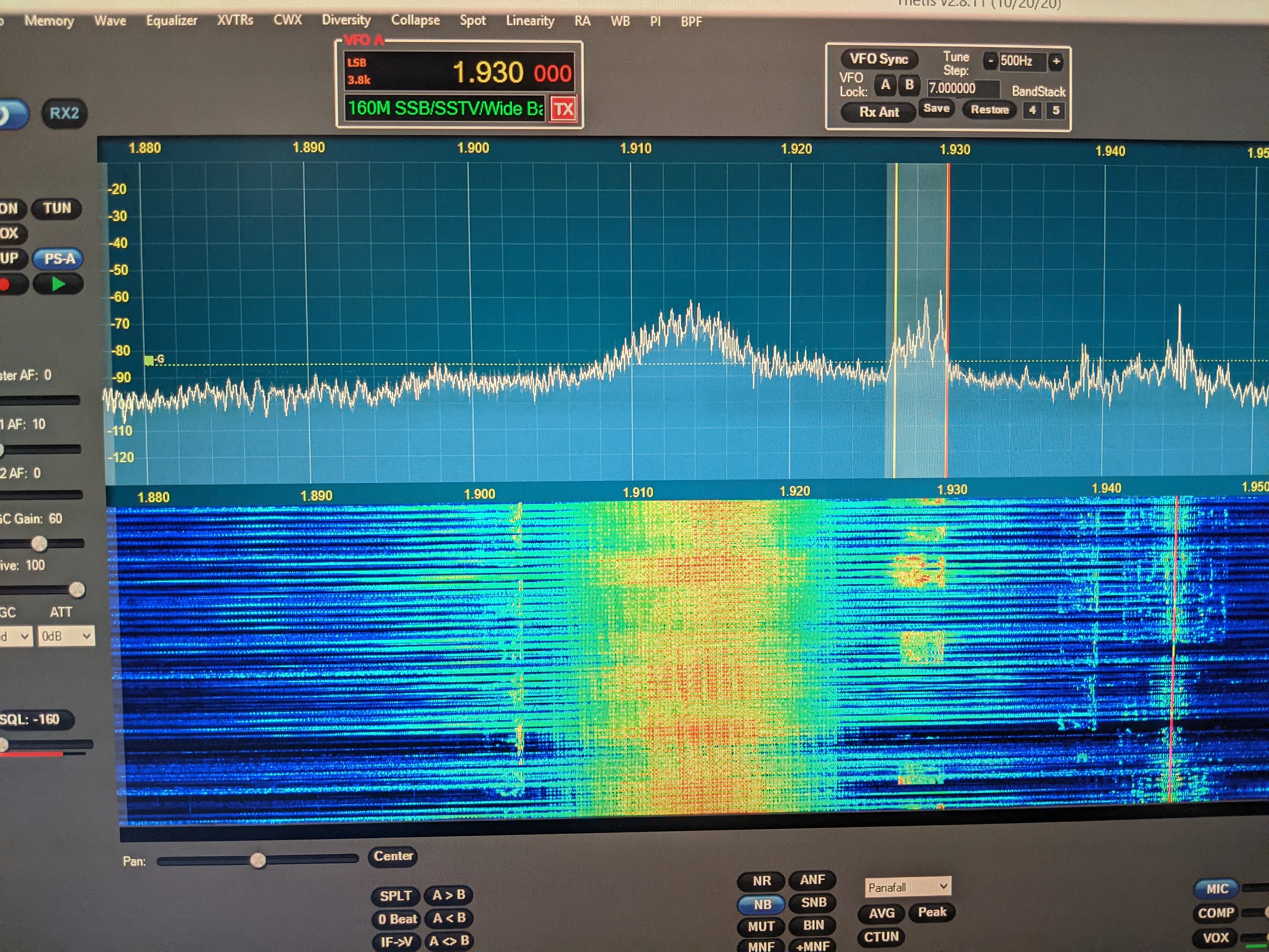

Newcomer to the forums here so pardon the resurrection of old threads...
As I've told Scott before, I've found the diversity/beamforming to be incredible. My RX1 is a big skywire loop (700ft+) and my RX 2 is an amplified 1-meter "mag loop". Almost always if there is a local interferer I can knock it down to just about nothing and still have very reasonable SNR on the desired signal(s).
Now recently it seems our Canadian friends to the north have been testing a surface wave radar system in Nova Scotia. They really like 1915kHz. Where I am on the East coast it obliterates about 25% of the 160m band:
I don't have a picture of it, (sorry) but I was able to really knock it down with "diversity". I first went out and turned the magloop for maximum interference signal (which as expected turned out to be ENE since I'm in central MA). There were some guys talking on ~1923kHz that were completely uncopiable here. With diversity I got it to where I was able to copy their QSO "through the noise". My recollection is that I was able to knock it down about 20-30dB. Of course this was all continuously variable because of the dynamics of the skywave propagation, but I can assure you that this feature can have an impact on skywave signals. I've done this playing around with AM broadcast stations at night too. It's kind of addictive for a while playing with this on random signals!
Thankfully, I have not seen the SWR signal on 1915 in several weeks...let's hope they went somewhere else!
