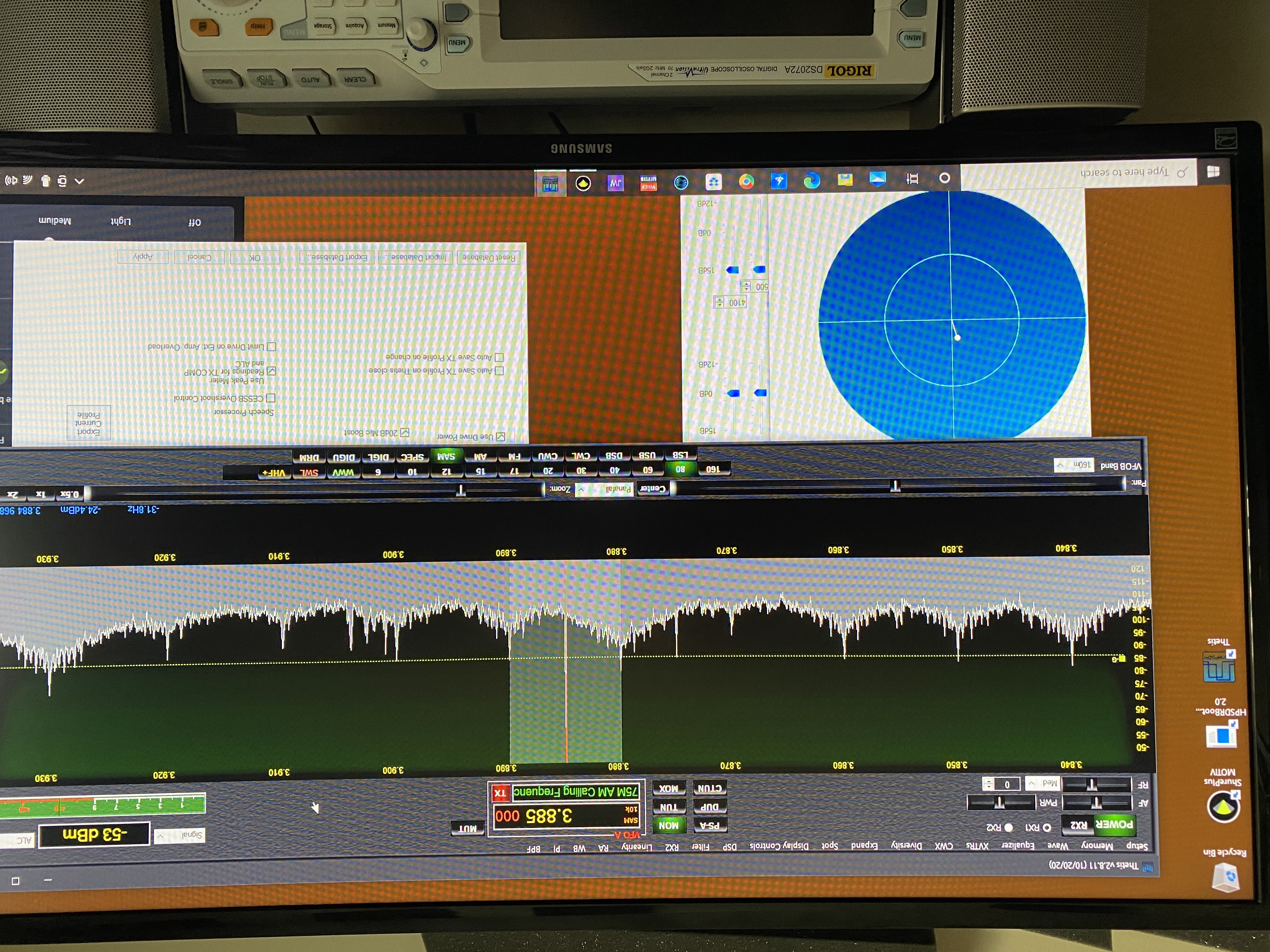

I've been running this on P2 2.8.11 for several months. All of a sudden when I use diversity, with RX1+RX2 and my second RX antenna just for this, I'm getting broadcast inference from the below 160 on all bands. I have carrier plus audio distortion every 10KC. Is this a hardware issue? I've deleted fully including databases, and reinstalled. I have noise issues here and this feature is very important too me and has worked very well since I've had the dual ADC Anan's. I'm thinking it's software, and I'm just about ready to format the hard drive and reinstall everything.
Any suggestions?

K9GAS wrote:I've been running this on P2 2.8.11 for several months. All of a sudden when I use diversity, with RX1+RX2 and my second RX antenna just for this, I'm getting broadcast inference from the below 160 on all bands. I have carrier plus audio distortion every 10KC. Is this a hardware issue? I've deleted fully including databases, and reinstalled. I have noise issues here and this feature is very important too me and has worked very well since I've had the dual ADC Anan's. I'm thinking it's software, and I'm just about ready to format the hard drive and reinstall everything.
Any suggestions?
Jerry KE9U
It looks like BPF-1 is in ByPass not on

Just as a note - this doesn't sound like software .... this sounds like maybe a bad shield connection on one of your antennas. The antenna then becomes single-ended and noise can be introduced. Check connections on both antennas. [one can check this out by unscrewing the 'ring' of a PL259 and pulling it out slightly so as to just have the center conductor making contact]

Hi Gary, that's what I had found. I noticed it was stronger during the day, when I noticed some KIWI sdr's experiencing the same thing. My receive antenna was coupling to the tower and the power lines as the bad weather had done some damage to the wire antenna. It was odd, but it manifested itself as the weather had gotten worse and colder. It was starting to overload the receive antenna port. I put up a temp antenna and verified this. So when it gets a bit better temp, I'll redo the receive antenna. Thanks for the responses.
