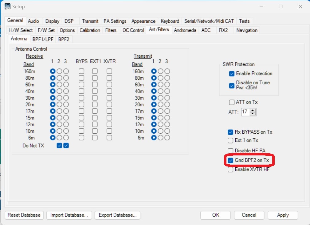

There 's an option to ground the bandpass filters for RX2 on transmit:

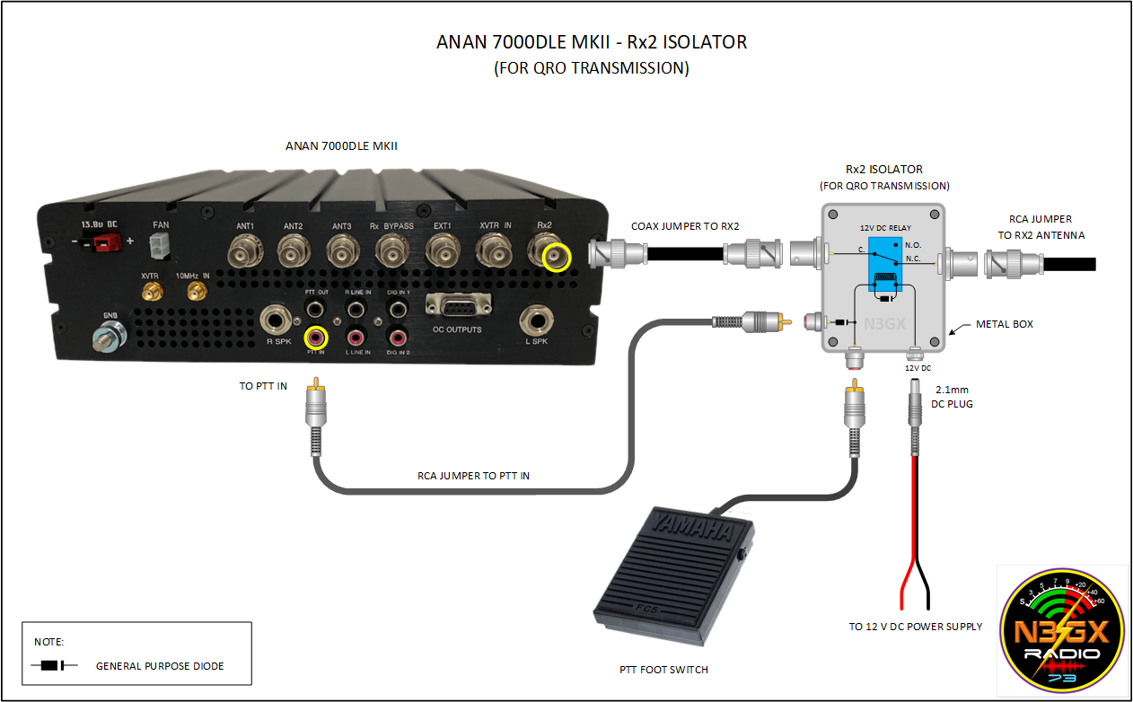

Scott, Thank you for the recommendations.
I'm thinking that I could build some relay actuated disconnect box like the one on the attached picture to resolve this problem.
- Rx2 Isolator - ANAN 7000DLE MK2.png (339.2 KiB) Viewed 69233 times

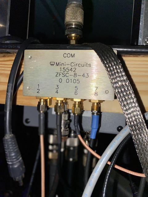

I use W6LVP Amplified RX loop antenna for CW Skimmer https://www.w6lvp.com/product/w6lvp-amplified-receive-only-magnetic-loop-antenna/
I split that connection via a Mini-Circuits and reroute to other RX antennas, i.e., SDRPlay, IC7610
My dipole antennas are in close proximity with loop in my small back yard. There is also a F12 antenna at roof top. No issues with TX.

Re "ground bpf2 on xmit
I have that checked but, when I transmit I still see a very strong signal on RX2 tuned, o course, to same as transmit frequency. I have always wondered if the rx2 band pass filter was actually grounded.

Re: Diversity Operations - RX2 protection while transmitting
You need some sort of hardware (front end protector). Ticking that setting might not be all is needed.

IMO the safest arrangement would be to have a configuration similar to N3GX's Isolator relay (see his illustration above), except that the relay type should be DPDT and the jumper feeding the Anan's PTT-IN should be actuated by the 2nd throw of the relay. That would be a fail-safe arrangement guaranteeing that the Anan doesn't transmit until after the connection to the RX2 antenna has been broken.

Rafael, that's the question. Is the band pass filter really grounded? Can anyone on the forum verify that it is?
Even if it is "grounded", there are lead/trace inductances, which will result in finite isolation. Selecting it to be grounded is a good idea, but should not be relied upon for protection when QRO using multiple antennas.

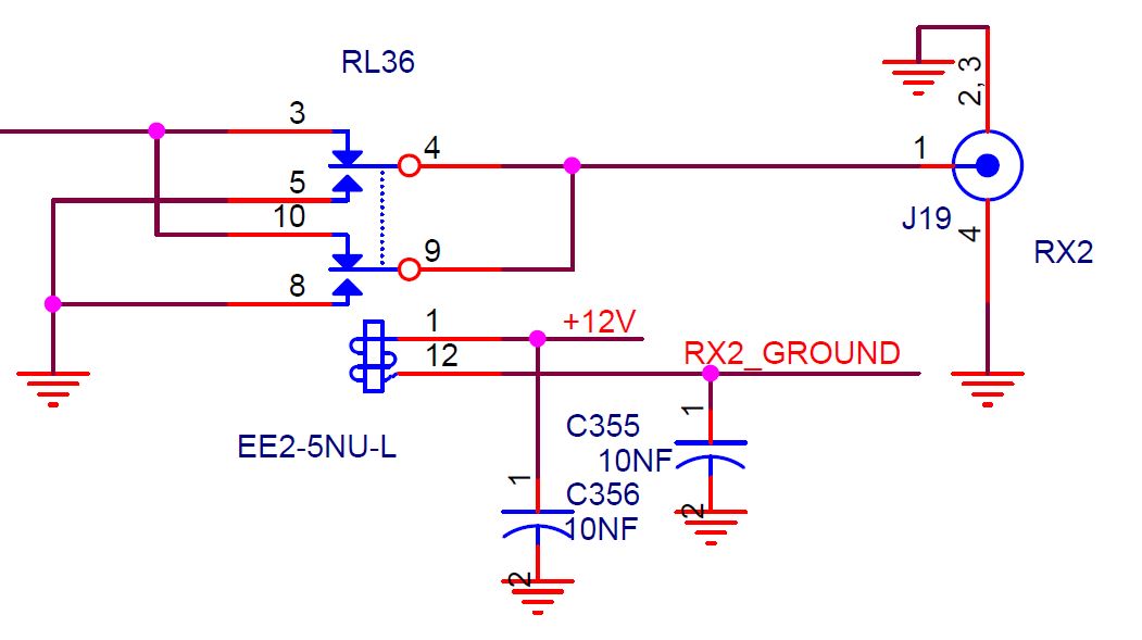

It's easy to test that RX2 is being grounded. Here is a schematic snippet from the 7000 series units:
Simply check to see if the center conductor of the RX2 input is shorted to ground during TX.
N4XD wrote:Rafael, that's the question. Is the band pass filter really grounded? Can anyone on the forum verify that it is?
Ron
N4XD
Reason dictates that there wouldn't be a "Gnd BPF2 on tx" checkbox if there was no functional selectable grounding.
Regardless, there's an easy way to test: set TX power to 1 watt and do a comparison of the RX2 received power with "Gnd BPF2 on tx" checked and un-checked.
If your RX2 antenna is too close to your TX antenna to even risk TXing at 1 watt, then transmit 20 watts into a dummy load -- your RX2 antenna should easily pick up the leakage from even barefoot power going into a dummy load. Do the checked/un-checked test with that configuration.
Good advise. I checked and indeed, when transmitting rx2 is shorted to ground. With, of course, the "ground bpf" box checked in Thetis The signal I see on thetis must be internal leakage or something like that. Not a signal present on rx2.
