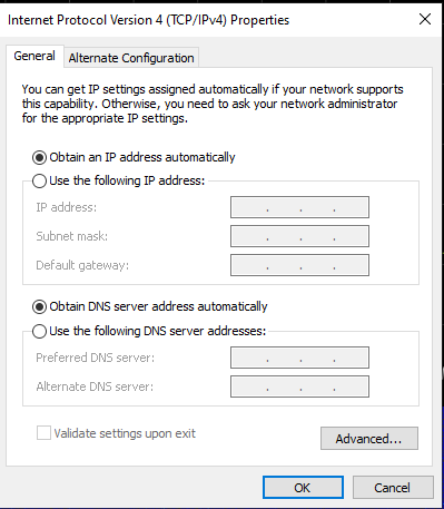

2. Set the extra NIC on the PC to DHCP mode (and, yes, that is confusing as HELL, shouldn't there be an APIPA setting, right? But NO, that's not how it works
To set the extra NIC on the PC to DHCP, on your PC, go to Control Panel (not "Settings") > Network and Sharing Center > Change Adapter Settings. Right click the adapter in question and select Properties. Select Internet Protocol Version 4 and click Properties. Select Obtain IP address automatically and Obtain DNS server address automatically. Click OK a bunch of times to close all the windows.
With those settings in place, when you power up the PC, or power up the ANAN, the network adapter will look for a DHCP server. After some number of seconds/minutes, if it doesn't get a DHCP address, it will make up it's own APIPA address in the range of 169.254.0.0 – 169.254.255.255. APIPA checks the network so that it doesn't create a duplicate address, so you don't have to worry about that.

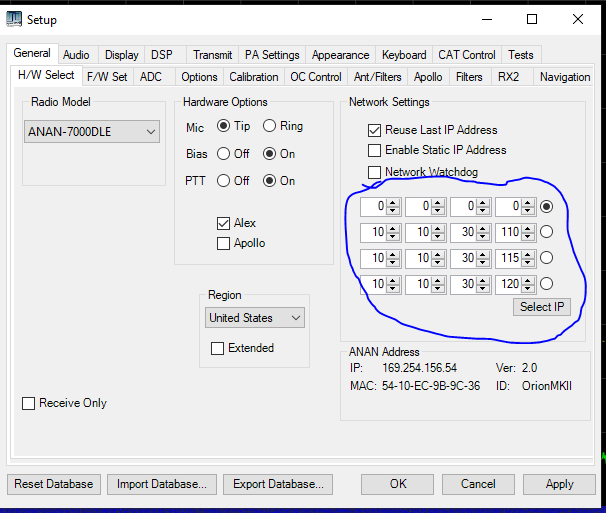

Here's one mystery for me. Why doesn't the ANAN address show 0.0.0.0 like It does when I query it in bootloader. No matter what, it says at 169.254.156.54. even through all these reinstalls. No matter what it's stuck there.
When I look at IPCONFIG from the command line I see the computer has 169.254.221.71 with subnet mask of 255.255.0.0
Shouldn't the sub addresses match? How does 221 and 156 communicate? Yet it is working now.
I can put the computer into sleep mode then wake it up a few minutes later and all is well BUT if I let it sleep overnight I have to go through this mess again.
I tried to put the image here but don't know how. It's just the setup menu showing the ANAN Address as IP: 169.254.156.54 Ver 2.0
Should I flush it out somehow? How? Why is it even working?

So here's a question:
When using bootloader... You ask it to show the IP address of the Anan. It comes back with 0.0.0.0 which is what I told it to do (DHCP)... So
if that is really the Anan's IP address, why then does Thetis show the 169.254 xxxx address? It's working now but when I let bootloader
find the IP I get the zeros. Is this some kind of bug? Why doesn't bootloader show the actual address?

n4lq wrote:So here's a question:
0.0.0.0 is not, and never is, the IP address of the ANAN. By commanding it to 0.0.0.0 with the Bootloader you are telling it to be a chameleon, either an APIPA based chameleon, or a DHCP based chameleon, depending on whether it detects it is in an APIPA or DHCP environment. When it detects which environment it is in it then sets its address accordingly, and that is the address you see when PowerSDR or Thetis makes contact with it.
Also, when using Bootloader TCP/IP is never in effect, no IP address is actually used. Bootloader works at the raw Ethernet frame level, without using any IP addresses.

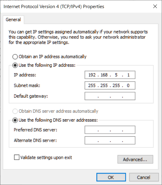

Do your NIC settings for the NIC you are using to communicate with the ANAN look like this (don't worry about the greyed out default gateway address)?
Is the NIC connected only to the ANAN?

You did not answer my question about NIC settings.
Re: Do not use APIPA when programming an IP address!
Sorry...Yes it looks exactly like your photo.

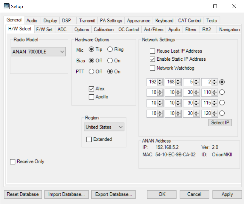

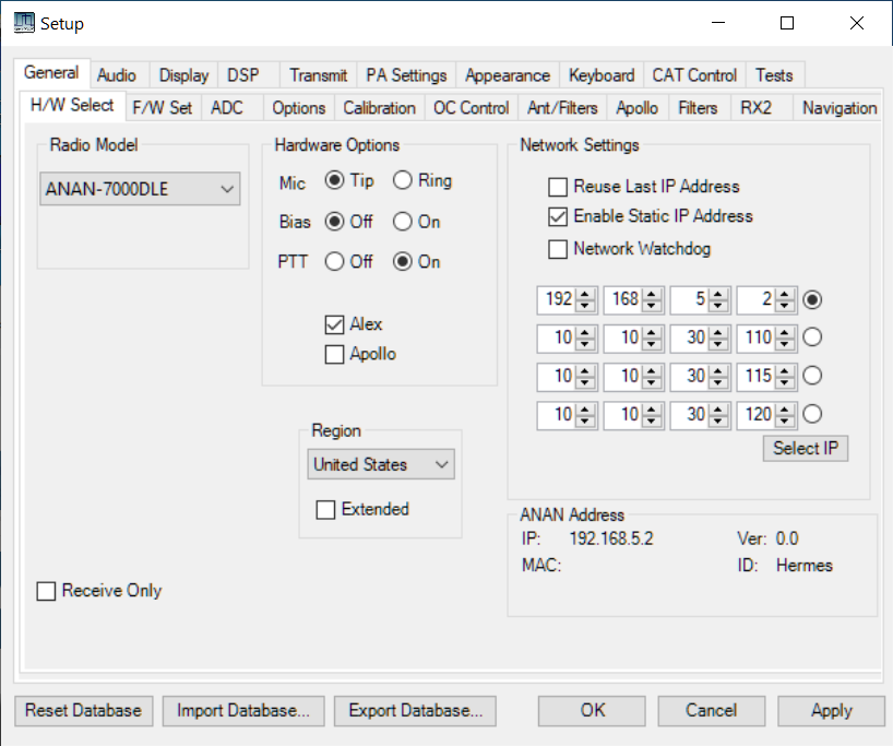

My computer and the Anan are both set to static IP addresses. They are connected directly to each other by a cat 7 cable, no ethernet switch involved (I have a separate Wi-Fi connection to the world wide web).
My habit is to leave the Anan (7KDLEMKII) powered up 24/7 unless there's a risk of thunderstorms. Whenever I leave the shack I either put the computer to sleep or power it off, such that when I return to the shack the Anan is running and the computer is either off or asleep. In any case, after I turn on the computer and open a session of Thetis it is up and running within one second or so. I've never had any problem connecting the Anan with the computer regardless of the initial state of either machine.
Here is my computer's address settings:
Here is the Thetis Setup page prior to pushing the Thetis Radio On button:
And here is the Thetis Setup page after pushing the Thetis Radio On button:
Hope that helps,

Use Bootloader to assign a static IP address to the ANAN. Do NOT use the same subnet as used by your WiFi or any other NIC on your PC. For example, if your WiFi or other NIC is 192.168.1.x, use 192.168.5.10 on the ANAN.
In the Windows control panel set your ANAN-related NIC to (again, for example) 192.168.5.100, subnet mask 255.255.255.0, and you've already apparently got a good understanding of the Network Metric setting.

In PowerSDR you can just check off "Reuse Last IP Address". There is no need to explicitly specify an address in PowerSDR unless you have multiple ANAN units on the network.

I did assign an IP address with a subnet that doesn't match my other connection although I do have separate NIC cards for this.

Back up and running now. Using static IP.
