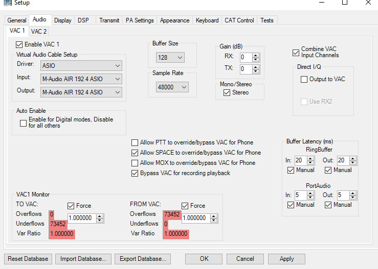

Getting extremely high overflow/underflow numbers. Reset both but the numbers went up like a rocket immediately after that again. See current numbers below.
Overflow Underflow.jpg (125.37 KiB) Viewed 9091 times
