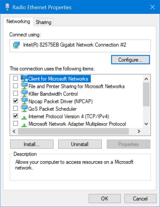

For a long time I resisted provisioning a dedicated port. My ANAN is in the basement radio rack, my PC is in a second floor studio/office. It was enough work just to run a single Ethernet cable from both locations to my main switch. But, finally, I did run another Ethernet cable, and I have to say the difference in performance was significant:
- Seq errors completely went away
- Other processes no longer caused audio artifacts on VAC audio (in particular browsers loading web pages)
- Overall operation just seemed more "solid" (obviously not a measurable characteristic)

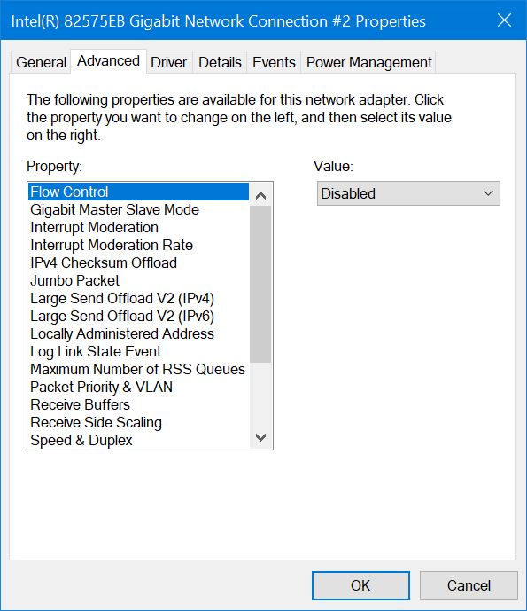

One of the great advantages of having a dedicated Ethernet interface is that you can disable all of the protocols you don't need on that specific port. I've got just two enabled:
Another great advantage is that you can tailor the interface advanced settings for maximum performance:
With the stuff you don't need disabled, advanced settings tailored (usually just a couple of small changes), and all the "normal" traffic being handled by the other Ethernet interface, everything seems to just work better.
A faster than GigE card is not necessary. However, if you plan on a fancy 2.5 or 5Gbe uplink to a NAS or something, by all means get one as long as it will auto-negotiate to 1Gbe for the ANAN on the ANAN port.
A few more tips if you do this:
1. Definitely set up static IP addresses on the second Ethernet interface and the ANAN. This makes the connection to the ANAN instant, there is no waiting for an APIPA address to sort itself out. This must be on a different subnet than the main interface. E.g. if the main interface is using 192.168.1.x the ANAN interface and the ANAN must use 192.168.2.x.
2. Make sure the network metric settings on the two interfaces favor the ANAN interface (smaller metric value on the ANAN interface). This might slow down web browsing a tiny bit, but again every advantage you give the ANAN interface helps.
3. Get a dual port NIC and, if possible, go into the BIOS and disable the motherboard NIC. On some computers this is impossible, on others it is mandatory. Best to play it safe and not have the motherboard NIC possibly interfering with things.
4. Be wary of crappy cards. There's really no way to know, but these things are all so cheap that it is possible to get bad/counterfeit product. My first dual NIC card had a bad port that would act up occasionally. If things are not working reliably strongly consider another card before blaming yourself or your setup.

This subject has opened a discussion of something I'm very interested in. Why? The never ending search for stability in VAC. I had run upon a series of tweaks that can be done on the dedicated NIC for an Anan. Scott. I'm interested in your views and experience with this. I have performed the tweaks myself. I can't tell any difference in stability of communication between the PC and radio. Then again, I was really having no issues with stability in communication between the PC and Anan 7000DLE to begin with. I also couldn't tell any difference in stability in VAC. This may not even have any relation to VAC stability.
I ran across these NIC tweaks in an article located here.
https://helpdesk.flexradio.com/hc/en-us/articles/202118518-Optimizing-Ethernet-Adapter-Settings-for-Maximum-Performance
As with any tweak or modification of this type be very careful and write your original settings down before making any changes as it may not work as expected and Your Mileage May Vary. If you particular NIC doesn't like a setting you chose it may become unstable.

Ah, yes, that old chestnut. Every so often someone rediscovers it. Or they start reading gamer websites about how to maximize game performance.
Cutting and pasting from one of my old posts:
I don't agree with all those settings, but it's a pretty good list, nonetheless. I'd leave buffer sizes at stock settings and, unless your CPU is very highly utilized, leave all offloading settings turned on. However any differences should be quite minimal either way.
Another thing that I've had good results with, if you have a dedicated NIC that is only connected to the ANAN, is to go into the properties for that dedicated, single purpose NIC adapter and turn off ALL services EXCEPT for IP4 and PCAP. You could even turn off PCAP (if installed) but then Bootloader won't work when you need it.
The problem is that many, or even most, of these "magic" or "critical" settings tend to be highly NIC specific. I've run afoul of that issue myself. You can find my post on here where I got all excited about turning off interrupt moderation only to find that it made absolutely no difference when I got a new NIC.
So all you can do is experiment for yourself to see what your NIC likes for settings. Certainly investigate other ideas, but what works for one might not work for the other.
When you are experimenting, the gold standard is a tool called iPerf. With iPerf you will get much more objective, easier to understand results. To really make this work well the iPerf server must exist on a fast machine. You can't expect grandma's old laptop to be able to hit 900+Mbit/s with the USB2 Ethernet dongle, you know what I mean? ;)
Another good tool is Tamosoft Throughput Test. It's a little sexier than iPerf. Again, you must host the other side on a machine you trust to be able to do as well or better than the machine under test.
I host my iPerf server on my NAS, which is connected to my network by a bonded pair of 1Gig ports. It has no problem proving out my other machines, I've hit rates as high as 950Mbit/s on my shack PC.

w-u-2-o wrote:You can't expect grandma's old laptop to be able to hit 900+Mbit/s with the USB2 Ethernet dongle, you know what I mean? ;)
The big question is: How'd you know my wife (grandma) had an OLD LAPTOP?
This is kind of what I thought. Since I saw no issues up front I went back and reset everything to default except for the changes you suggested. Somewhere down the road I'd have an unexpected issue and would have completely forgot I had made changes to the NIC. I did have a previous dual port NIC that was flaky to begin with. I tried some of these changes and it didn't like any of them. Any change at all and it would completely quit working. The one I have now (I forget the brand) has been working well. I had also forgot those other tweaks existed until this topic popped up. I thought I'd just try them on this NIC. I knew there were tools , but had no experience with any of them.
Being retired now I'm constantly experimenting with different things. Both with the radio and. That's why I'm not reporting a lot of issues I have. I am normally creating my own problems.
