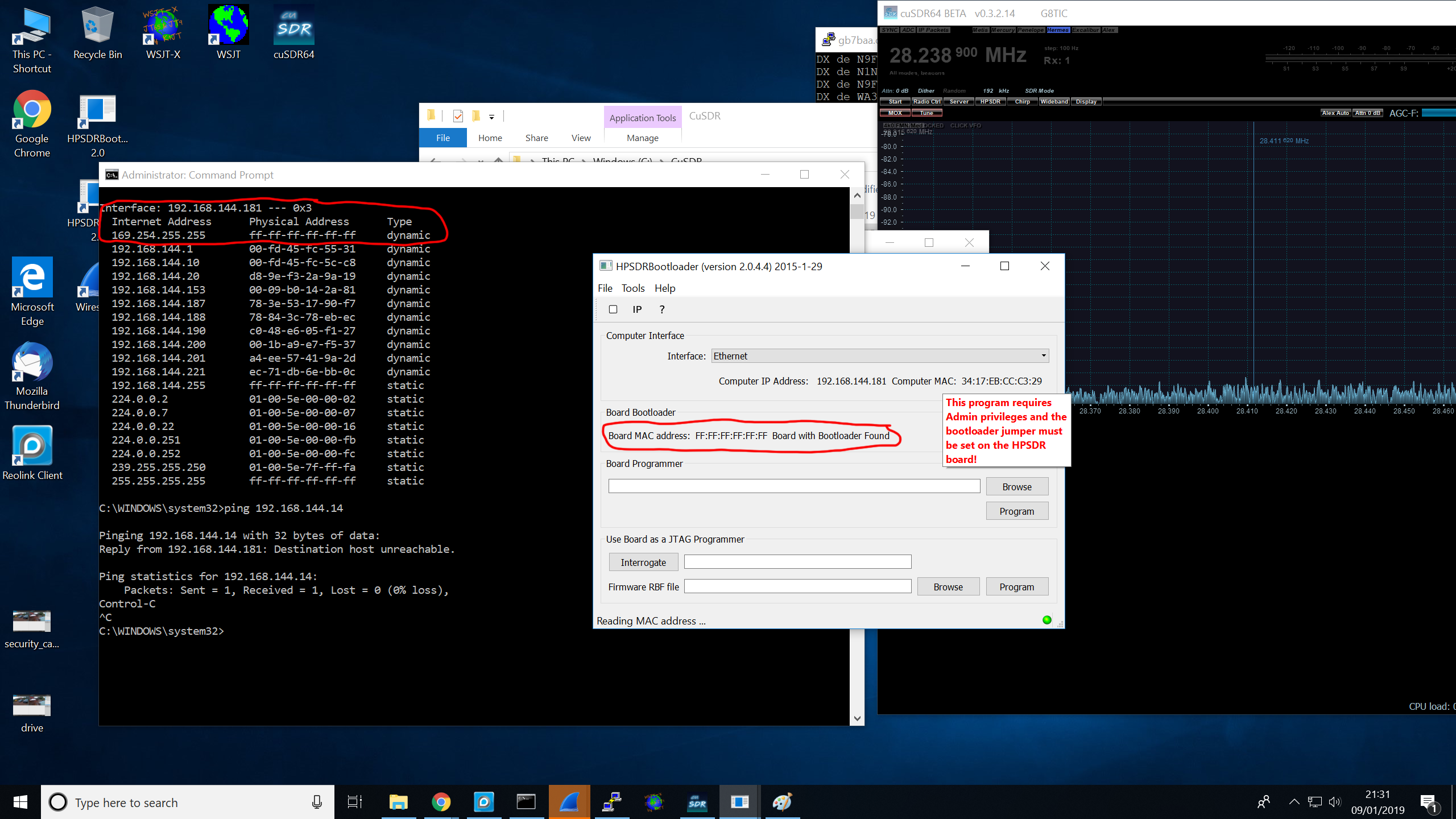

I can't see how any external issues, such as my network, would cause the Angelia to insist on using the broadcast MAC address FF:FF:FF:FF:FF:FF when it should be using its real MAC address (stored in its EEPROM).
I have attached a screen grab from the new PC adjacent to the Angelia - you can see that BootLoader says that the board is present but the MAC address is FF:FF:FF:FF:FF:FF ... you can also see that from CMD prompt I performed an 'arp -a' and that showed the IP address 169.254.255.255 mapped to the broadcast address.
I believe that the Angelia using the broadcast MAC address to be the root cause of my problems and this has to be internal to the Angelia ... possible causes might be:

Scott and others,
My Angelia is back from SMT rework and a new U15 (25AA02E48T) has been installed.
Good news! I have powered up the board multiple times connected to my dumb Ethernet switch and connected to my managed switch and it came up and worked 19 times out of 20. On the one occasion it didn't, unplugging and re-plugging the Ethernet cable fixed it.
So the board has a new MAC address (54:10:ec:9f:6a:ba) and works with DHCP and I've been able to tell my DHCP server to always had off the same IP address.
Happy the networking issues are now fixed, on to the rest of the issues ...
