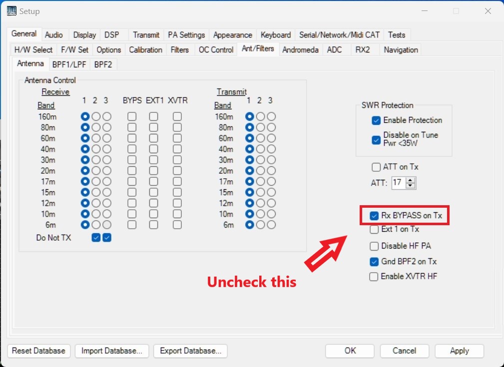

Postby K1LSB » Thu Mar 09, 2023 9:46 pm
You don't need an external sampler to test for proper PS operation, you can just use the internal sampler:
Gen Ant-Filters Antenna.jpg (116.49 KiB) Viewed 30901 times
Re: Sequence errors during transmit
Postby w-u-2-o » Thu Mar 09, 2023 10:08 pm
K1LSB wrote:You don't need an external sampler to test for proper PS operation, you can just use the internal sampler:
Unless he's using an external amplifier...
Posts: 704
Postby K1LSB » Thu Mar 09, 2023 10:54 pm
Regardless of whether he's using an external amplifier or not, he can test for proper PS operation by using my suggestion.
His PS won't correct for an external amp but it will still correct for the internal PA, so he can in fact test for proper PS operation.
