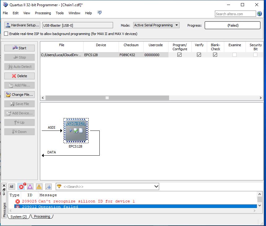

Hi, thank you for your answer.
When i open the pof file, with Quartus, it appears the indication EPCS128.
Please refer with attached picture.
The error messages are:
Error (209025): Can't recognize silicon ID for device 1
Error (209012): Operation failed

That's all the information I have. I don't know how to reconcile the difference between what you see in the code and what is on the schematic. Perhaps someone could look on their factory built Angelia and see what is there.
In any case, even if we assume the EPCS128 is the correct part, per the schematic the EPCQ128A would not work for the same reasons I already noted above.
I would encourage you to look at the data sheets and schematics for yourself.
