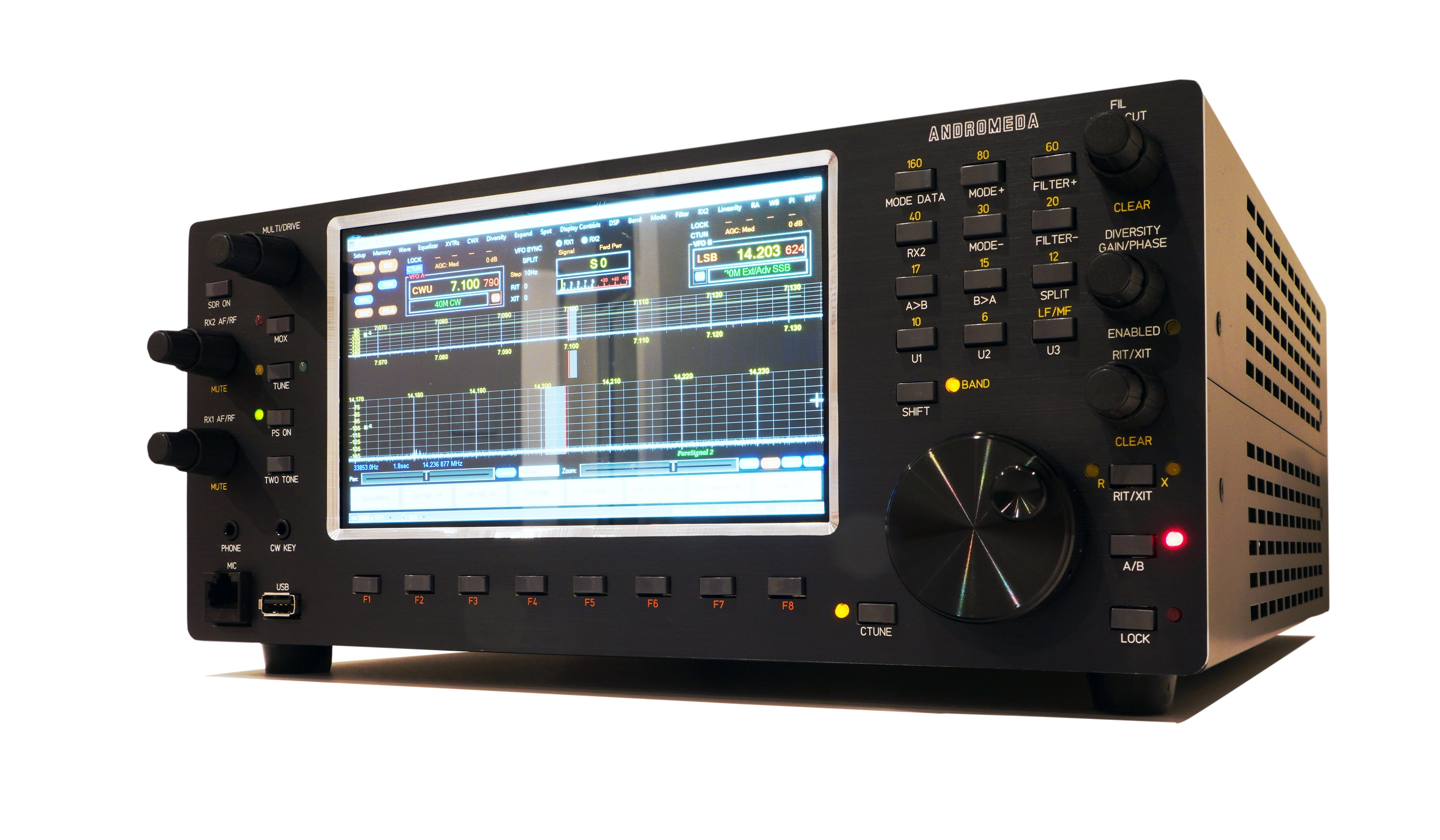

Laurence, Doug, Kjell and myself have been working on Andromeda for a while now and most specs are now locked.
The front panel implementation by Laurence & Kjell is in my opinion fantastic, the control layout is very ergonomic and all buttons/Encoders (Except for the tuning knob) can be reassigned functions by the end user.
One can choose from either the 10th GEN Intel Quad Core i5 or a 6 Core i7 NUCs, performance is excellent with lots of headroom. You can add two external Monitors via a USB 3.0 HUB (there are two 10Gbps USB 3.0 GEN2 Ports on the back panel) and one USB 2.0 on the front panel.
The GUI can be used in both Collapsed Andromeda Mode on the 7 inch touch screen or in the usual PC expanded mode on an external Display.
Andromeda is packaged in a much smaller enclosure (35.5CM DEEP x 30CM WIDE x 13CM HEIGHT), it runs off 13.8v DC
Abhi

OK, now my two cents 8-) Sorry but VFO knob are about nothing :( It's looks like cheap plastic peace. On such a rig, as well on other, it's main tool. And that is what eyes caught first. It should be something like on IC765/775 etc. Not that a size, at least design. Next, I'd prefer to buy just front panel DIY kit. I'll never buy full rig with Andromeda, I just can't afford it. And I think not only me. One more, steady signs on front panel are not the best way. If somebody would change usage of buttons and knobs, as it was promised. Better way are metallic badges with necessary signs/letters, which you can exchange 8-)
YL2GVC 73!
Re: Andromeda???
Postby w-u-2-o » Sun Jul 05, 2020 9:09 pm
I think it's a nice design. Not my cup of tea, but nice. It could use a fancier knob, but I bet that knob is more than adequate. It looks very much like the knob a lot of us used for homebuilt piHPSDR controllers and that worked very well.
It sure would also be nice to see this as a stand-alone. Same design, maybe sloped back 10 degrees, perhaps 2 or 3 inches thick with the NUC bumped out the back so you could get to all the NUC connectors without them sticking out the sides. Use a standard NUC power supply. It would be everything the piHPSDR isn't/wasn't. It clearly can work with any hardware that Thetis supports. With a USB headset it would be a killer kitchen table companion. And, with a USB to serial adapter, the ability to attach a key or paddle to the PC instead of the radio hardware unit is finally a realistic option for 200D and newer hardware thanks to the W2PA QSK code in Thetis and the firmware.

I think, it is necessary to make small clarification about front panel ;) You should go to this page: http://www.frontpanelexpress.com Download this application: https://assets.frontpanelexpress.com/fpd/Version-6.2.1/FrontDesign-US-6.2.1-x64.exe Open file *.FPD with this application and you are free to modify it and order directly 8-) But keep in mind, if order more than 10, there are significant price break 8-) Good opportunity for group buy.
Question to Kjell, I tried to check your Gerber compatibility with AllPCB service and got such notification: All the hole sizes are the same(0.8 mm). Please kindly check if it's normal? If not,we need you to re-upload the NC drill file. I think it should be OK. By the way, it offer cheaper price than Boktech. But as in all of these services, minimal quatity are 5.
YL2GVC 73!

Laurence, posted FPD differs from that what we see on Andromeda. as well there are mistake, name SHFT, should be SHIFT. Not a big deal, I already corect, but for group buy, if it will take place, should be right one ;)
YL2GVC 73!
laurencebarker
Posts: 304
Re: Andromeda???
Postby laurencebarker » Tue Jul 07, 2020 4:23 pm
Yes, I did say the texts were different. What Kjell has provided is the open source PCB and FPD; I've provided the software; but I know Abhi has made changes subsequently to make it look better (eg removing the mounting holes). None of those are a barrier to making your own!
I don't use FPD but I think Kjell's design was from a while ago, before the final text was fixed. It would be wise to check!
I haven't used the FPD but it would probably be wise to overlay it over a print of the PCB to check the positions. There were some movements of mountings and connectors at the bottom left.
