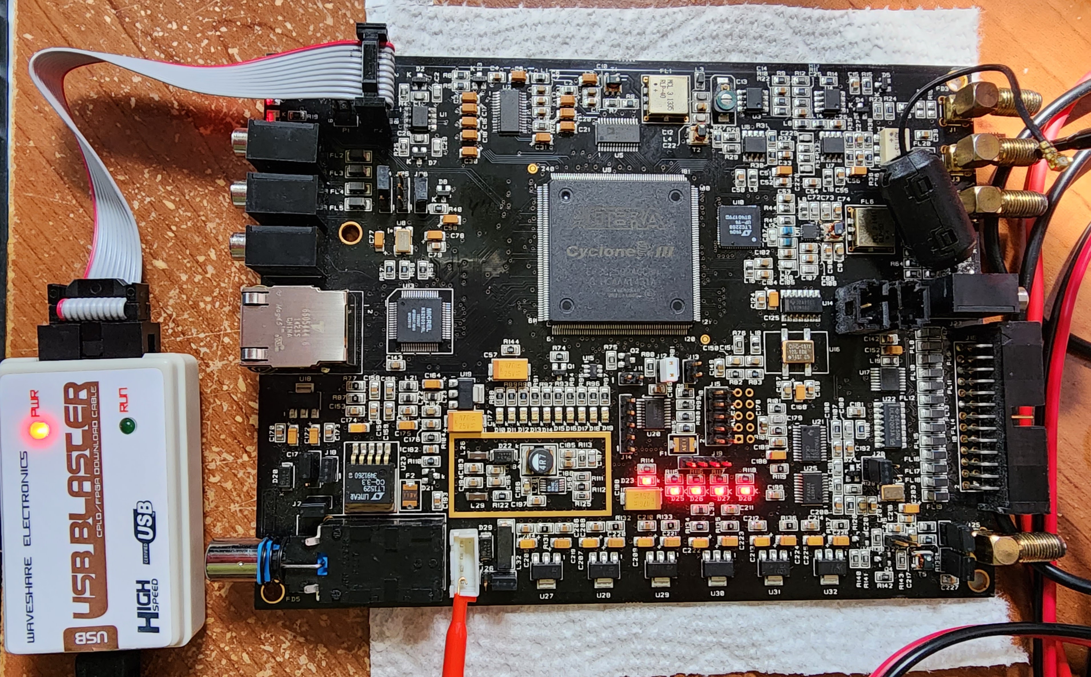

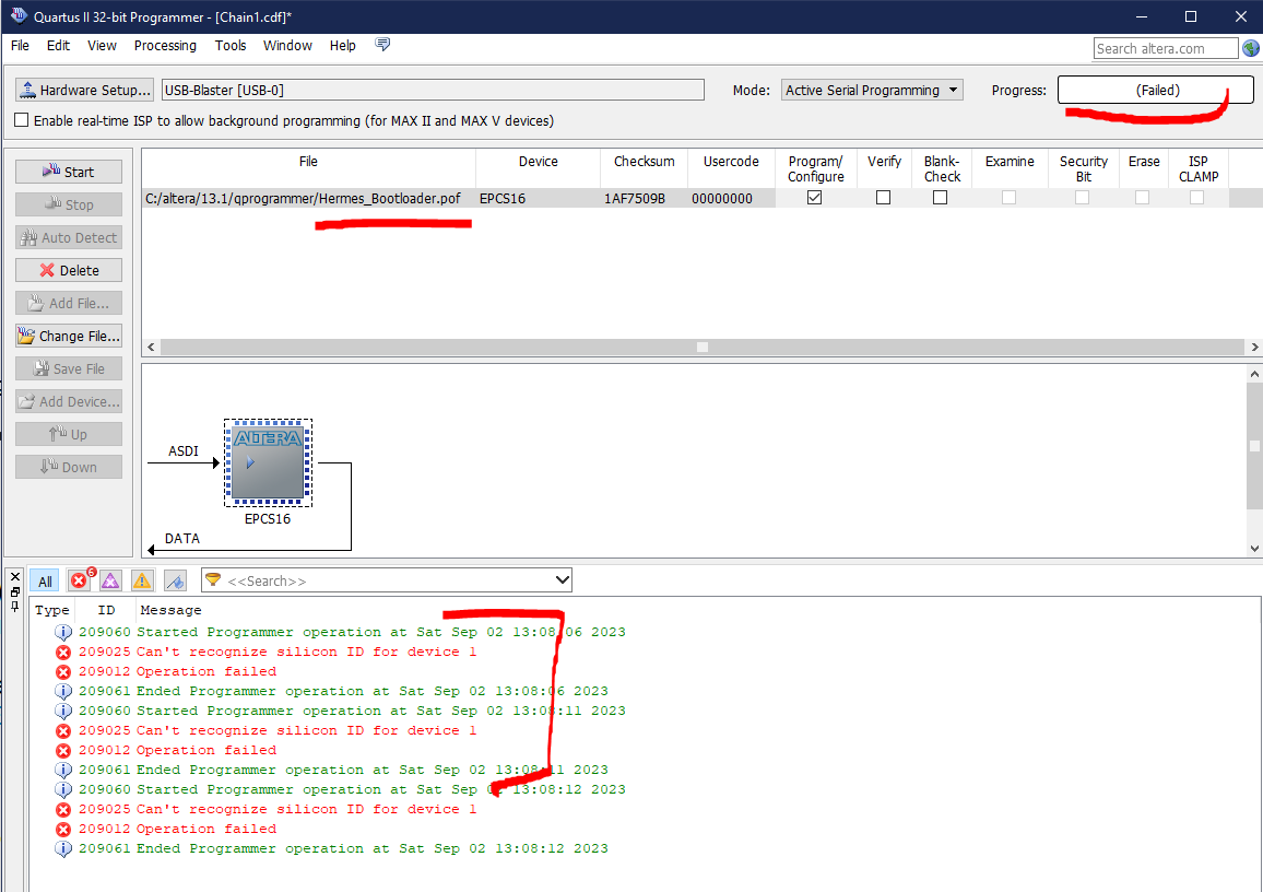

I’m going to try and summarize what has been a long, frustrating process. I got a new-to-me Anan-10 last week (not the E). According to Thetis it was running firmware 1.5 and working perfectly well. I, apparently foolishly, decided to try and upgrade it to protocol 2 firmware the very first day I got it. It hasn’t worked since.
Using HPSDRBootloader 2.0 which detected the radio fine, I uploaded Hermes10_v3.2b.rbf. It seemed to go fine. So, I powered down, removed the J12 jumper and restarted. The radio has been “gone” ever since. It doesn’t get an IP address nor can one be set since it has no address. I have tried HPSDRBootloader 2.0, HPSDRProgrammer_cmd.exe, HPSDRProgrammer_V2 2.0, HPSDRProgrammer_V2_nopcap 2.0 and HPSDRProgrammer_web.exe. None of them can detect the radio.

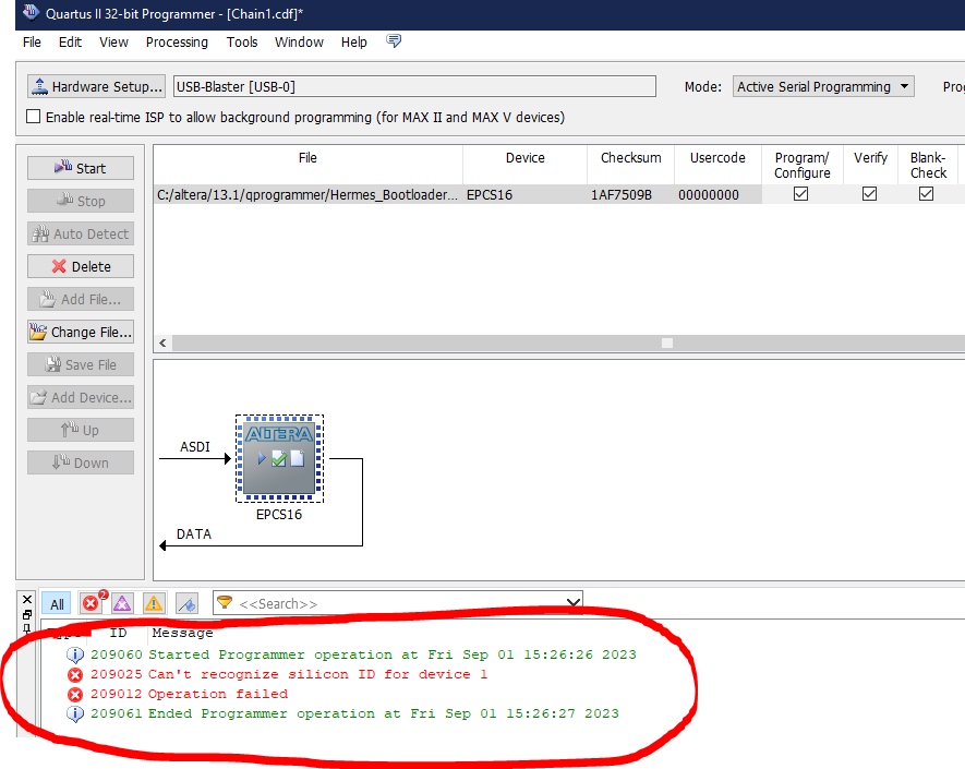

Since it was undetectable, I bought a USB Blaster clone on Amazon, a “WaveShare USB Blaster,” thinking I would connect to P2 on the board via the supplied ribbon cable and restore the bootloader code. Nope. No such luck. I’ve tried four different versions of Quartus from v10 to v22 and none of them can see the radio, either. Lack of a license, maybe?
All versions give me the same error:
I note that if I don’t even have the cable connected to the board I get the exact error seen above as well. Bad ribbon cable?? Seems unlikely but not impossible.

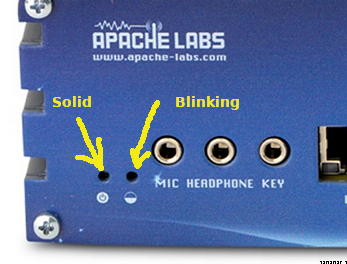

All voltage rail status LEDs show good on the board, but the red status LED on the front panel is steadily lit rather than blinking at about 1 Hz as it was when working.
It seems very likely that I’ve inadvertently done something really stupid, I just don’t know what.
Any and all advice greatly appreciated as you can imagine how frustrating and disappointing this is.

When you have J12 installed (bootloader mode) and powered up, does the front led blink?
(EDIT) oops, just re-read your post saying it is solid.

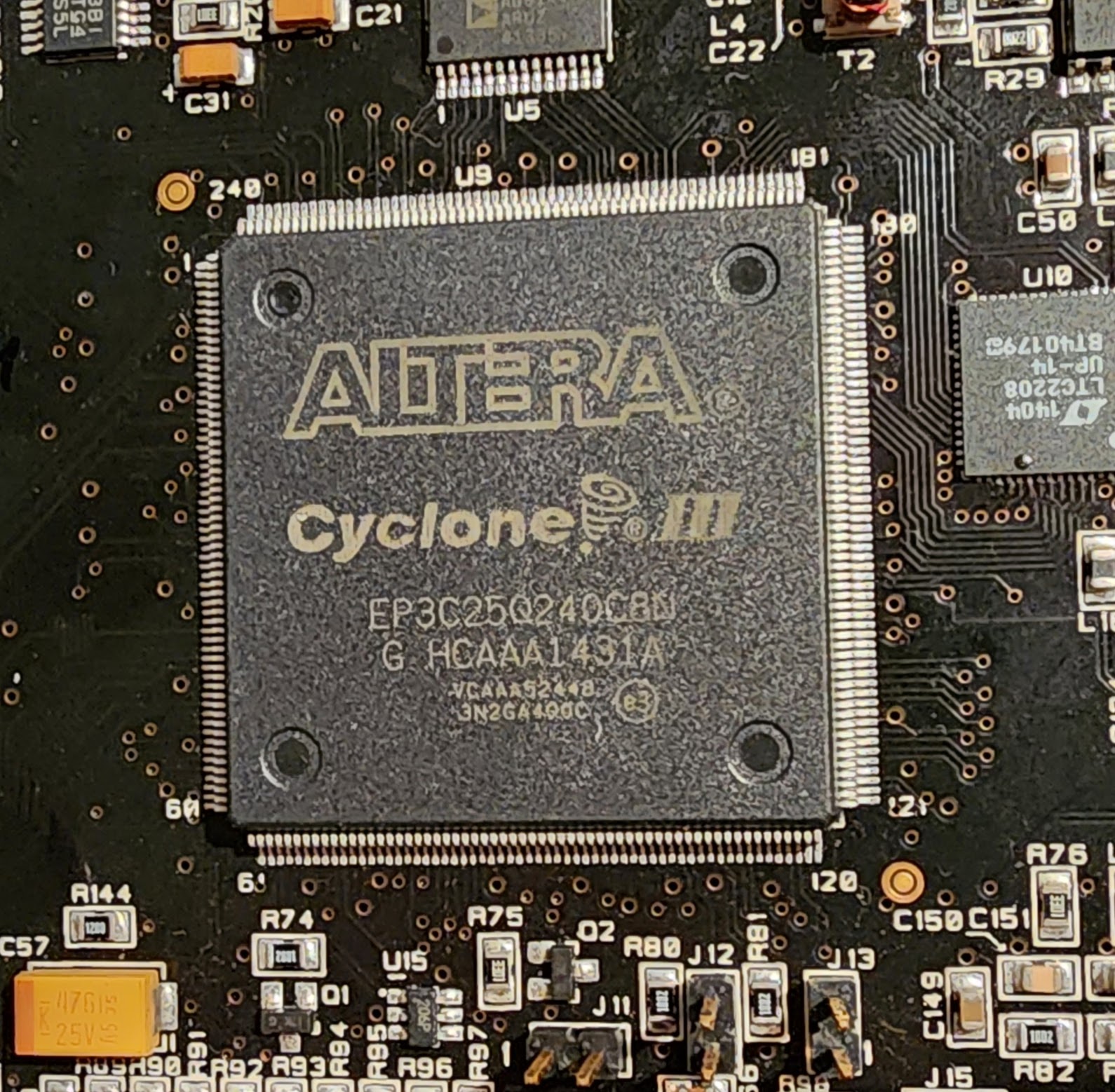

Can you double check the FPGA part number just to be absolutely sure it isn't the 10E model?
10 should be: EP3C40...
10E should be: EP3C25...
It shouldn't make a difference for the quartus programmer though since they are both Cyclone III's.

Thanks to Rick specifying the FPGA part numbers it seems that the Anan-10 that was sold to me as a "none-E" actually is an E. That's a bit annoying. I guess I'll have to assume that the guy that sold it to me didn't know, either. ...maybe. :|

I just tired re-flashing the board again. Same result.
Here's the setup:
I note that D10-D19 are NOT blinking.
I think I must have damaged one or more of the board components somehow.
--K

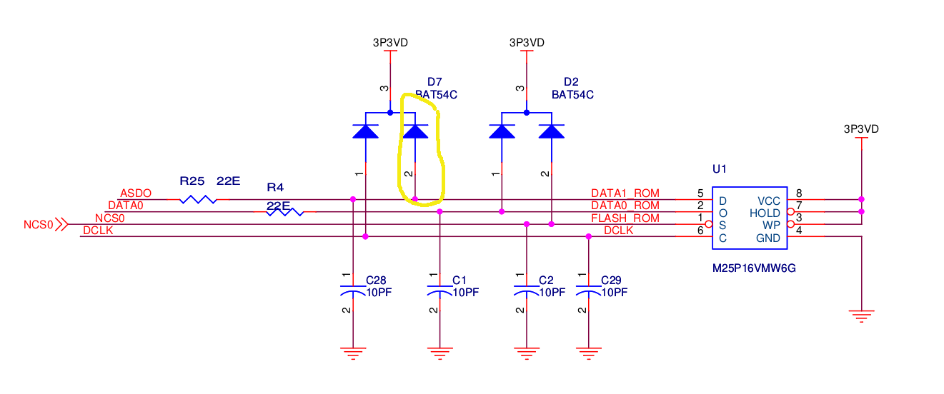

If U1, the M25P16VMW6G flash serial chip was bad, would we expect this sort of error?
--K

I have a Hermes board and U1 is marked as a 25P16VP (ST Micro). I would imagine if it went bad
you would see an error such as your seeing.

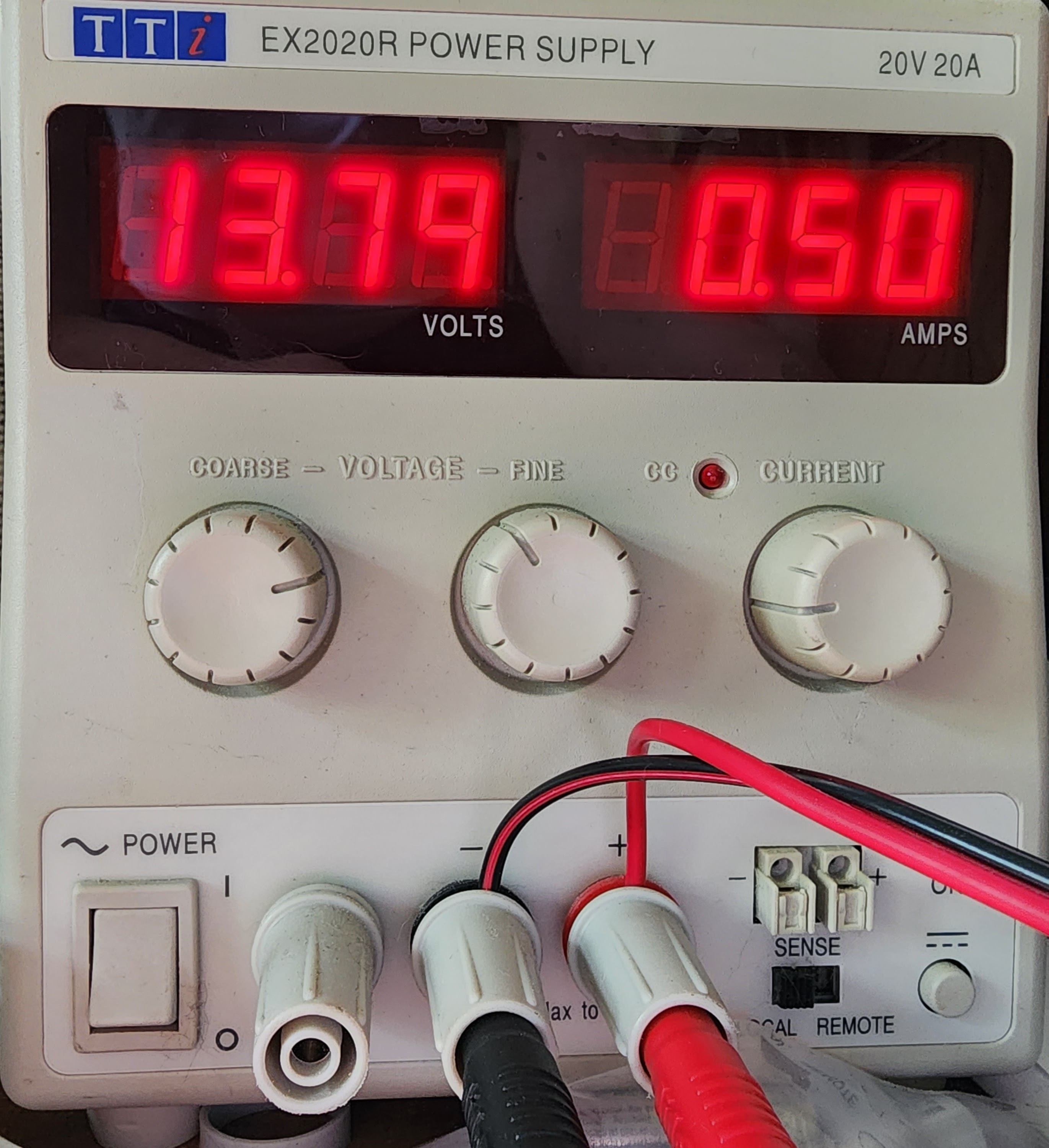

BTW, I am seeing 270ma @ 13.8v when my Hermes is in bootloader mode, for what that's worth.

Postby N0BGS » Sat Sep 02, 2023 8:47 pm
I've tried a second USB cable from the blaster with the same results.
U1 Voltages are identical with J12 jumper in place or removed.
Pin:
1 - .18
2 - 3.1
3 - 3.3
4 - 0
5 - 1.08
6 - .02
7 - 3.3
8 - 3.3
With blaster attached and running, voltages above also remain the same.
https://mm.digikey.com/Volume0/opasdata/d220001/medias/docus/4847/DS_557_M25P16.pdf

My U1 Voltages are very similar to yours except pin 5.
On Pin 5 I see nearly 0 volts either with or without the Blaster attached.
Your seeing 1.08v with or without the Blaster attached.
What if there is a problem with D7 causing the line to be pulled towards 3.3v?
Maybe replace D2, D7, and U1?
Could D2 & D7 have got a static hit when the Blaster was inserted?
As a check on D7, remove it and try programming the eeprom again.
Maybe both D2 & D7, they are only there for protection you could add
them back afterwards.

I'll try pulling D2 & D7 and try flash again.

Postby N0BGS » Sun Sep 03, 2023 1:52 am
With D2 & D7 REMOVED from circuit:
U1 Pin voltage:
1 - 3.3
2 - 3.3
3 - 3.3
4 - 0
5 - 1.44
6 - .02
7 - 3.3
8 - 3.3
Those don't seem right to me. Voltages remain the same with or without J12 in place.
Same error as always.
BTW, both diodes test good.

I see the same voltages on U1 except for pin 5.
It is near 0 with or without the Blaster plugged in
It is also near 0 with or without J12 plugged in
I don't think J12 should change the voltage readings, its used to swap the flash banks.
If the Blaster isn't plugged in, that 1.44v your seeing is probably coming from the FPGA
ASDO seeing as the diodes are OK.
I wonder if the FPGA may be in a misconfigured state (from the eeprom being programmed with
the wrong FPGA code) such that its preventing the Blasters signals from working?
Then again it could be possible that the Blaster isn't working.
There is an AT45DB161E substitute at Digikey in stock:
https://www.digikey.com/en/products/detail/renesas-electronics-operations-services-limited/AT45DB161E-SSHFHC-T/4292716
It looks compatible from the datasheet but I don't know for sure.
I've used this guide to setup a Raspberry Pi and Flashrom to program chips like this:
https://tomvanveen.eu/flashing-bios-chip-raspberry-pi/
The AT45DB161E is supported:
https://wiki.flashrom.org/Supported_hardware
If you have a logic analyzer or multi channel scope you could check out whats happening
on P2: ASDO DATA0 NCS0 and DCLK pins on power up.
You may want to contact Doug Wigley W5WC <dwigley@apache-labs.com>, he may have a better
idea what may be the problem.

I sent the 10E board to Doug, W5WC, who found that both the flash rom chip and the FPGA were bad. He didn't think it would be cost effective to replace them so I opted to purchase an Anan 10 board that he had on hand. What I did to ruin the 10E board is not clear to me but it must have been something.
So, if anyone is interested in a non-functioning but likely repairable 10E board let me know.
