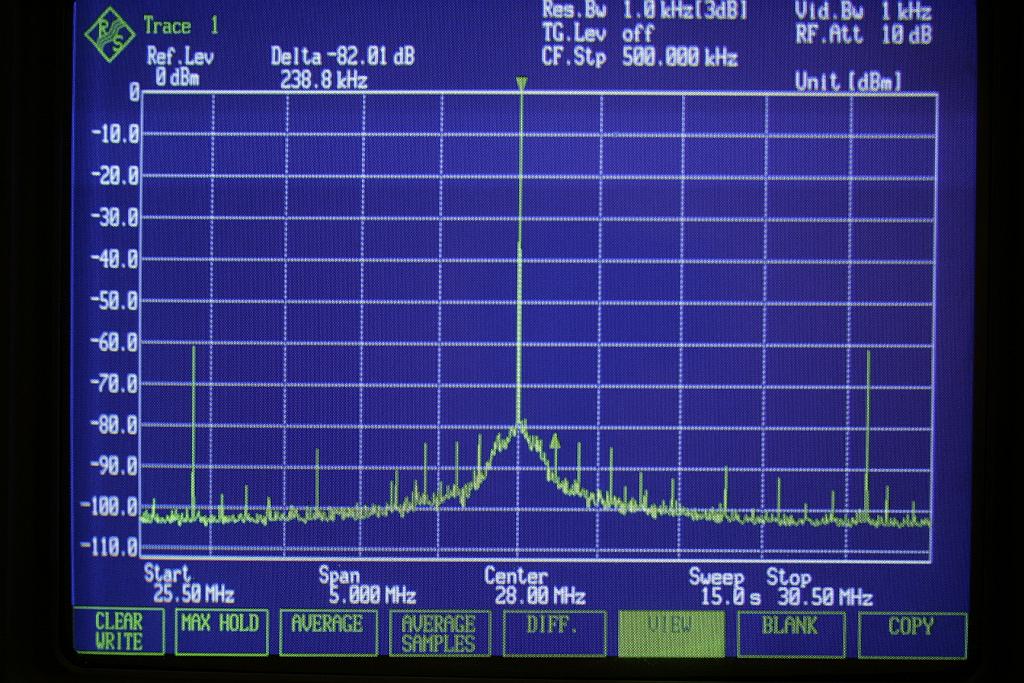

I will concentrate on in band TX spurs which are at an unacceptable level for my intended application. I suspect that the problem can be solved by better filtering of a yet to be determined SMPSU device.
For all these tests a clean linear supply was used. I investigated the problem as a result of communication with other ANAN-10 users one of which shared plots when running from a battery. Suffice to say that the problem is not from a external supply.
The single tone was generated using the TUNE control in PowerSDR mRX V3.4.9
Here is the first plot at a fairly wide RBW at 8W output.

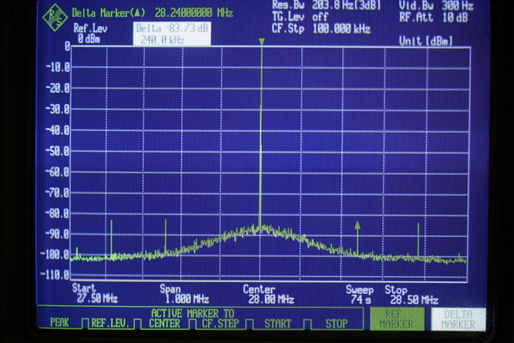

I decided to investigate further at different power levels and so that I could see deeper I decreased the RBW of the spectrum analyser.
This plot is at 3W out
Now 1W output
Finally from the TX out with the PA disabled.
This is unacceptable for serious VHF use with high power and high gain antennas. Due to the low noise floor of other users at least 90dB suppression of all in band spurs is required. I am quite sure that this can be achieved and that this is just poor filtering of an SMPSU device or ground issues on the 3V3 domain. I would like Apache or the designers to investigate and maybe offer some suggestions as to what modifications may be helpful. I suppose that this is very low priority as it will not help new sales.

The spurs are from the HP-8562A! Here is what it looks like with a proper spectrum analyser, as I expected it to be.
I am not ashamed to admit that I am wrong.
Conrad PA5Y

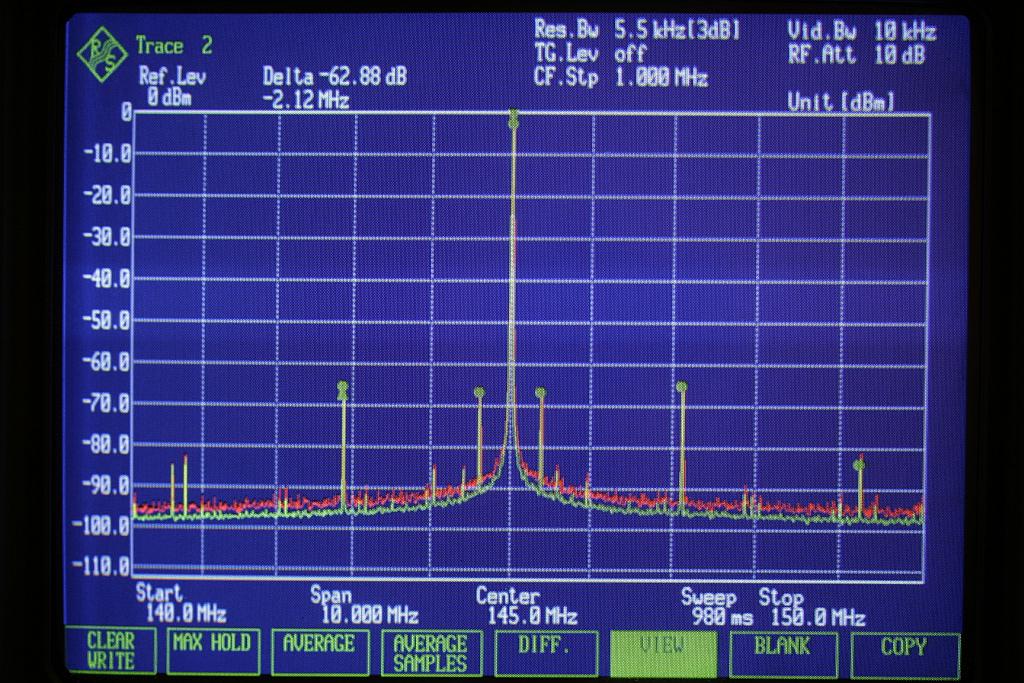

f6dro wrote:... for the strongest one + and - 385 Khz from the carrier...
Maybe you missed the +/- 2.112 MHz ones ?
ANAN100 attached to 2m transverter:
144mhz 1min.jpg (141.48 KiB) Viewed 47035 times
Ok, there are spurs, but they are below legal limit. What would you expect on a pure digital system?
On the other side we have world-class low IMD thanks to adaptive predistortion, nearby perfect bandpass filters and also extreme low phase noise.
Regards Walter

Postby f6dro » Thu Sep 20, 2018 5:48 am
Hi again ,
I got some time yesterday to run more measurements.
You are rigth , spur content depends on sampling. With 384K spurs are -72 (10dB better) , still not enougth and worse than Conrad anan10.
A strong signal on the band is something like -30dBm in the offended receiver , then we get 4 inband spurs at -102dBm , giving respectable jaming signals on the band.
I don't remember wether my anan is a 10 or a 10E , I'm not at home at the moment so I can't verify , maybe it could explain the difference with you and Conrad? Anyway , even -84 db down still jams.
I wonder wether DAC output filter modification could improve the situation ? -100dBc would be nice.
