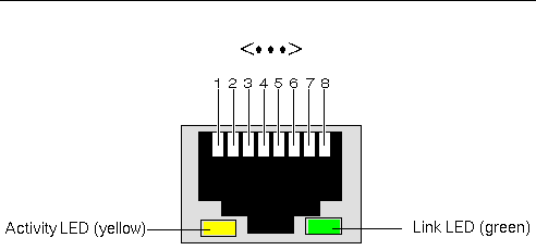

Skip the router for now, connect the PC directly to the ANAN. You may have to wait a few minutes for link lights to appear. Once you get two good link lights, one on the PC and one on the ANAN, then you can try Bootloader.
As for Ethernet link lights: if you don't understand what these are then you are in a very early place on your learning curve. You do need to have some knowledge of networking, PC's and Windows to get these radios to work properly. It might be worth your time to sit down and study some of these subjects, particularly Windows and Ethernet networking.
Just about every Ethernet network interface port is equipped with two LEDs. The colors and the positions may be a little different, but they are almost always part of the port assembly. One LED will come on solid if the link is good. The other will blink when traffic is being received or transmitted.
Example:
If you do not see at least one solid LED illuminated at both ends of the Ethernet cable, then either one of the ports is broken, the cable is bad, or the ANAN is broken/bricked.
So, again, do you have good Ethernet link lights at both ends of the cable?
Do you know if you have WinPCAP or NPCAP loaded so that Bootloader will work properly?

I think I mentioned that the lights blink. Power lights remain on on both ends (left light ) (right light) constantly blinks . winpcap was loaded each time ... Also tried NPCAP removing WinPCap first and then installing NPCAP. The activity light constantly blinks on both ends .
