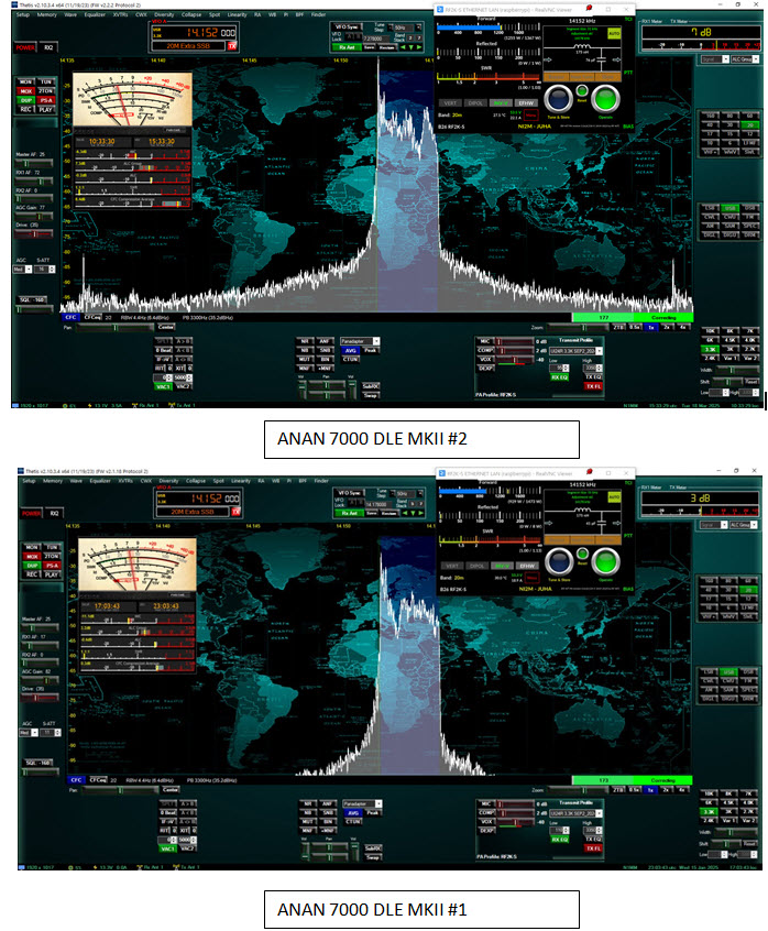

I have two 7000 DLE MKII radios and I believe both have the same FPGA ( EP4CGX150F896 Cyclone IV series FPGA) in them as well although I am not 100% certain. One radio runs on FW v2.1.18 P2 ("radio #1" in the screen-capture below) and radio #2 runs on FW v2.2.2 P2. Note, I tried FW v2.2.2 on radio #1 a long time ago, but went back to FW v2.1.18 as From/To VAC underflows/overflows showed huge numbers acted pretty bad!
Observe 2 "spurs" (for lack of a more appropriate term) when using radio #2. They appear around 15kHz above and below my actual TX frequency. This, regardless of whether I am on CW or SSB or band. Granted that the strength of the "spurs" is fairly low and 99% of the time, they won't be audible. However, why would these rear up their ugly heads only on radio #2? :? The station set-up is identical as I have only swapped radios.
I suppose I could roll back to FW v.2.1.18 on radio #2 and see if that makes any difference!

Re: Different versions of P2 firmware causing this?
Postby w-u-2-o » Tue Mar 18, 2025 9:07 pm
You are on the right track. Put the same firmware into both boxes and see if things look similar. You can put both on 2.2.2 or both on 2.1.18, etc.

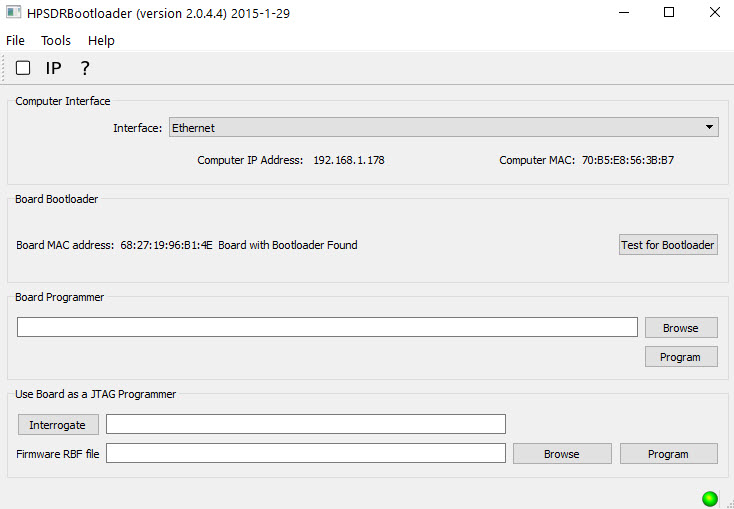

I HOPE that I didn't BRICK radio #2. When using Bootloader, it does find the board and before programming it says "Erasing device...." or something like that and that it might take up to 90 seconds......ALL seemed to go well, with no errors reported. Exited, switched OFF radio and put Bootloader switch to OFF position, restarted radio. Thetis can't find radio #2 no matter which P2 FW version I try. I was expecting that Thetis would find the radio with the original FW v2.2.2 P2 programmed into it. :cry:

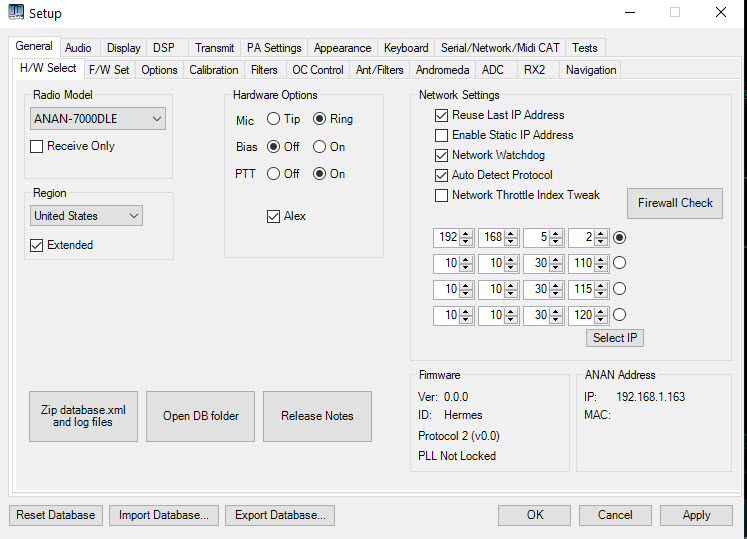

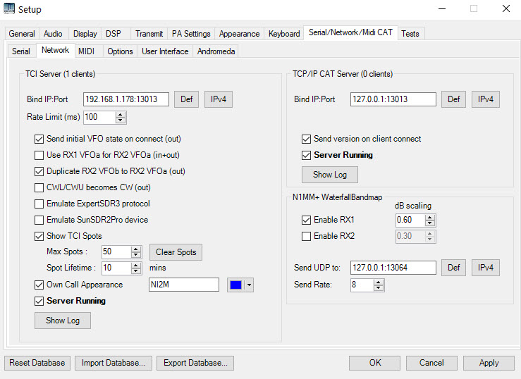

I use CAT8 (overkill) cables. Put in radio #1 in line this morning and all works very well. Using an unmanaged Ethernet switch (have been for more than 3 years now) capable of 1 GBit/s speed.
With regard to P2 FW, I tried several of them. Radio #2 had been running well on FW v2.2.2 for quite a while so I don't think it has to with FW. There is no confusion about the FW at all. I even tried Protocol 1 FW, but no joy.
IP address: Why would the IP address be a problem all of a sudden? I guess it is possible. ;) NOTE: I only have one radio on the network at the same time. I have made copies of AppData\Roaming\OpenHPSDR for both #1 and #2 in a safe place. Now, when I swap radios, I purge out the entire AppData\Roaming\OpenHPSDR for the radio I WAS using from the PC. Before I put the other radio in line, I move the entire AppData\OpenHPSDR Folder for that radio from that "safe place." Is this an incorrect way of doing it?
Below, see Hardware, Network Forms and Bootloader View:
Network Tab #2.jpg (121.35 KiB) Viewed 11681 times
Gen HW Select #2.jpg (115.33 KiB) Viewed 11681 times

I tried using Static IP address as well, just for grins, but no joy :cry: !
After having flashed a FW version on it and having switched the bootloader to the OFF position (included in the FW versions, v2.2.2 that worked beautifully just a few days ago) and powering up the ANAN, the right red LED stays solid, no blinking. It is blinking when I use the Bootloader to flash the FW as I believe it should.
As soon as I see that solid right red LED, with no "heart-beat," I know that Thetis won't detect the hardware. Also, there is no audible click when I am starting up Thetis. According to Doug: "That’s the firmware setting the relays to a known configuration. If the firmware is not running then no relay setup." (and, so no click/my add!). => So, the firmware(s) that I have flashed are not "running." :(
Update:
Bootloader switch is working. Switched it to OFF position, went into Bootloader and it didn't find the radio (board). Another good friend suggested that I check if all of the SMA connectors are snug. It is just such a bear doing that...... ;)
Postby w-u-2-o » Thu Mar 20, 2025 8:52 pm
Does the Bootloader still find the board, or has that started failing, too?

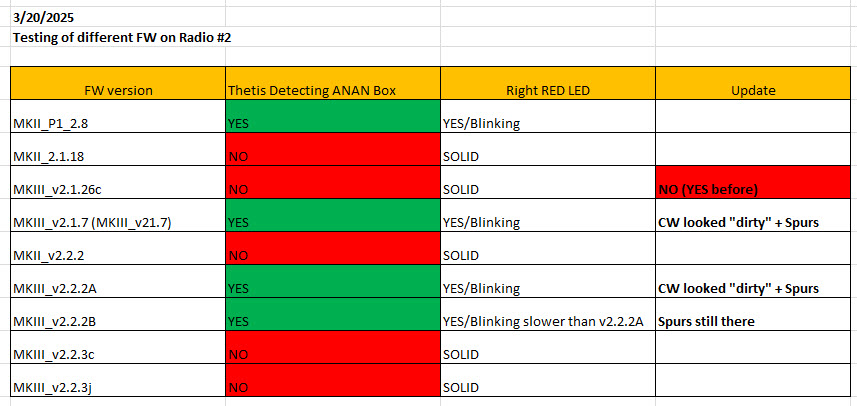

Spoke with 2 other fellows about this as well. And, I must give Doug many thanks :) :) ! He was incredibly generous with his time and suggestions! It seems that the FPGA is a Cyclone V series one to boot which belies the S/N on the bottom of the radio. Some repair had been done in the radio so that threw me completely.
Your comment about the IP address did the trick! For a foolish reason - yes, I am not afraid to man up to that - when tried using Static IP at one juncture I likely reprogrammed radio #2 with the "wrong" address. I corrected that by putting all ZEROs in the IP address field and I am using Dynamic IP. Perhaps learning from my mistakes might benefit someone else.
Below, see results from tests I ran today. Now, I am hoping to settle on a working FW (not going to Protocol 1 though!) that will not generate those "spurs" that I reported in the first post.
Update: Made a mistake in the Excel table, but included the correct one below. The spurs are still there for all the working versions of FW though! No change at all. Also, CW is either "dirty" or "clean" depending on the FW used. "Surprisingly," I see "dirty" CW gets "cleaner" when PureSignal is engaged :? ! I was under the impression that PureSignal mainly improved SSB transmissions.
Update on FW Tests on Radio #2.jpg (106.12 KiB) Viewed 11062 times

As I had suggested two days ago, when I wrote "then In the spirit of Sherlock Holmes, maybe, just maybe, there was some confusion about what firmware was, and what FPGA is, in #2. It might be worth rolling through the three different versions of firmware for the three different FPGAs just to confirm that this is not a problem".
This is all a matter of how well the timing is closing in the FPGA as part of the physical gate floorplan, which will obviously be different in both FPGA variants, and a factor of minor differences between circuit boards. Hence it is not surprising that #1 and #2 provide different performance.
