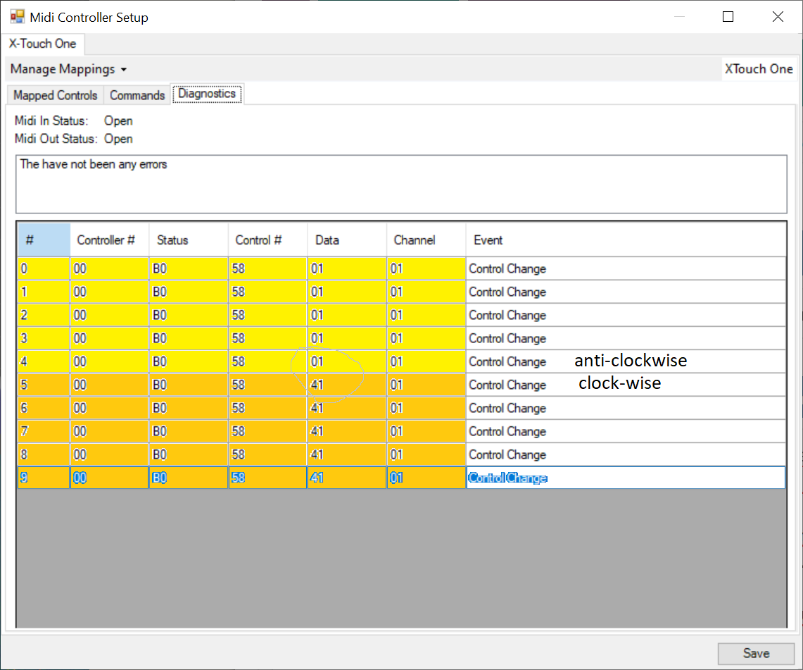

Hi, i allready mentioned this issue end of last year.
I have a problem with a MIDI controller Behringer X-Touch-One.
All buttons, knob and slider works well but...
the wheel does not want to do "VFO freq down"... the VFO freq just doesn't change.
VFO "up" does work well but the wheel works anti-clockwise.
I use the X-Touch-One standard Midi setting but all other build-in modes (Midi-Relative, HUI, MC, CChgRel) have the same problem.
This controller (incl the wheel for VFO) works perfectly with SDR-Console (!!).

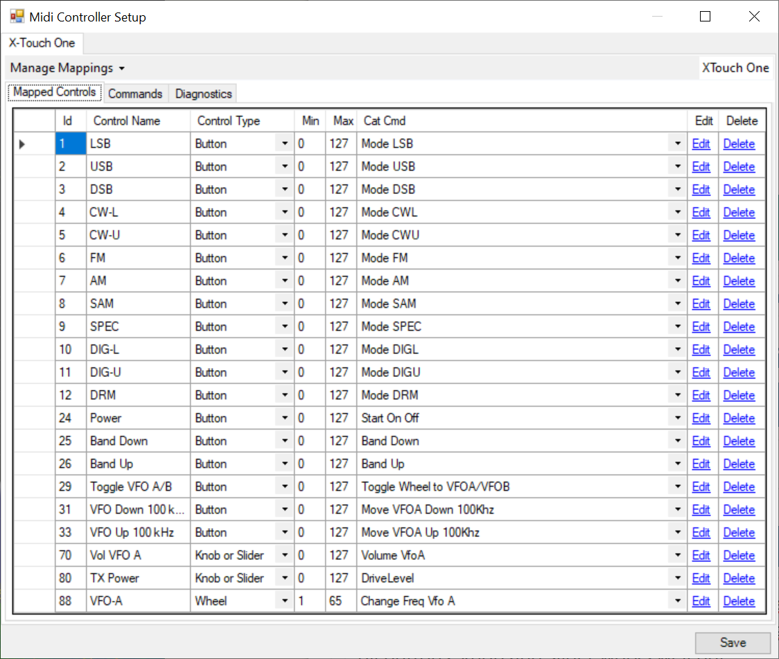

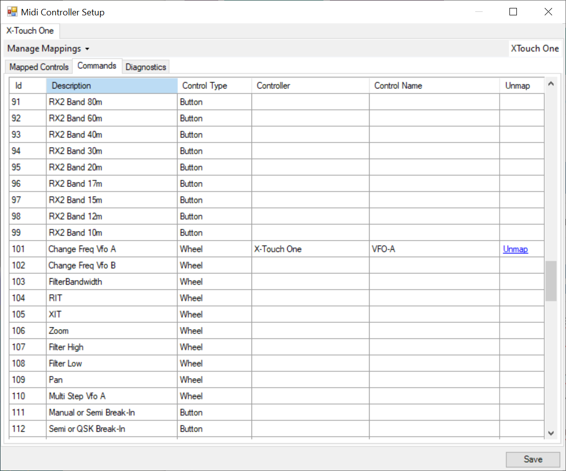

I added a few pictures of the Midi Controller Setup.
Hopefully someone can help me out to get this working in Thetis. (i use 2.7 a3)

Fixing this will require changing the software. Right now I don't know if there is anyone currently working on the MIDI part of the codebase.
