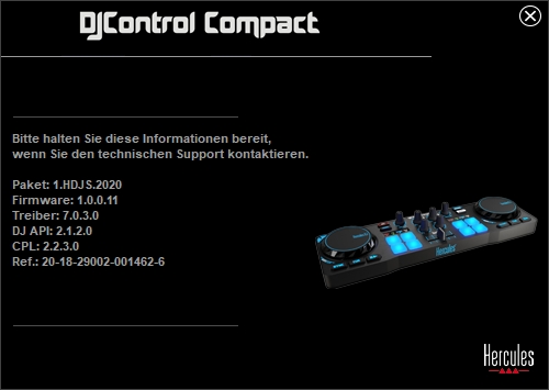

I have to control drivers at this point.
Have you installed the Hercules suite of DJ controller or only the USB driver that is automatically installed by Windows when you plug in the first time the controller USB cable?
Re: Slowing Wheel Tuning Speed
Postby oe3ide » Mon Jul 05, 2021 9:40 am
I have also installed the Hercules software.
Image 4.jpg (57.16 KiB) Viewed 10193 times

Postby I2NOY » Tue Jul 06, 2021 7:52 am
Set one Hercules button to toggle between fast and slow rotation of wheels and Min/Max to 9 and 10.
Now wheels work as expected. :D
