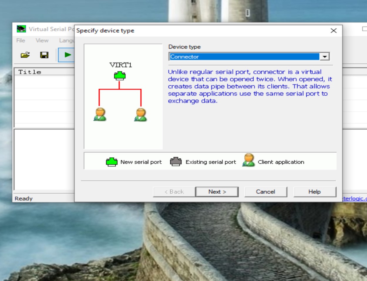

I have the TMate2 working with PowerSDRmRX. I setup a virtual com port using VSPE (com 0 com should work.) I called it COM 7. Then I open Tmate2Console and set the com port for COM 7. When I start PowerSDRmRX, I goto setup and CAT Control and Enable Port: COM7.
These steps allow the Tmate2 to work just fine with the program. you have Mute, Noise Blanker ANF, Volume, Band changes, and VFO control using the Tmate.

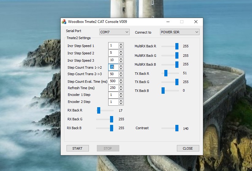

Yes, I set the VSPE for COM7 and then set the TMATE2 Console program for COM7. The CAT setup in PowerSDR mRX is also setup for COM7.
The VSPE and TMATE2 Console program run in the background. I start VSPE then TMATE2 Console than then run PowerSDR mRX.

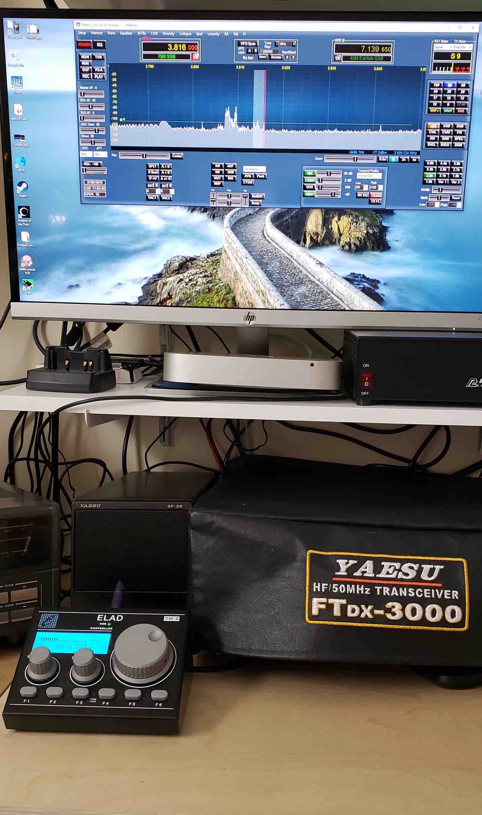

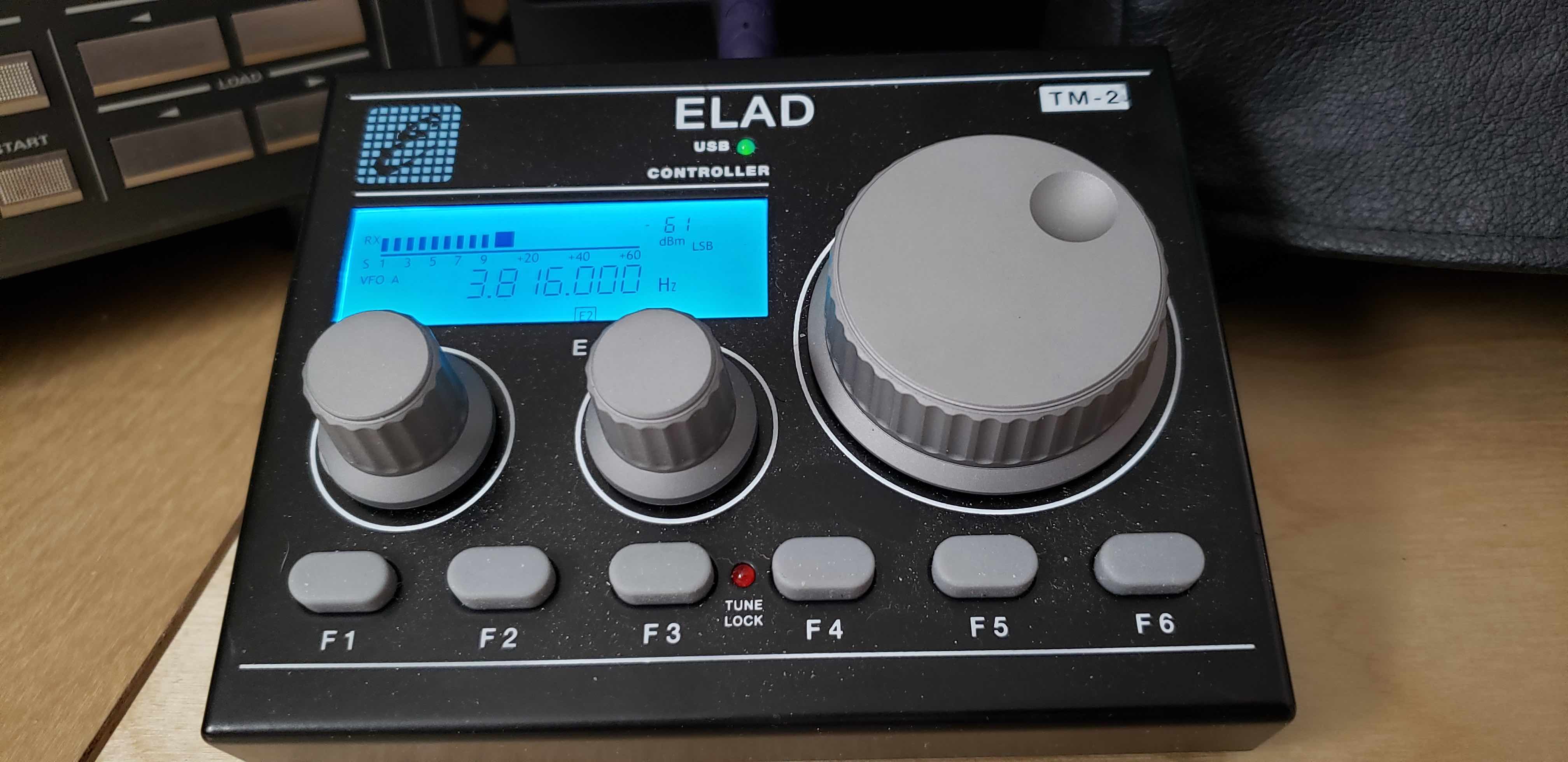

Here are a couple of shack pics showing things working. I am now using Thetis and it works fine with Thetis also.

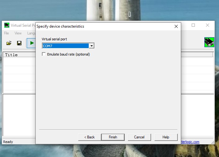

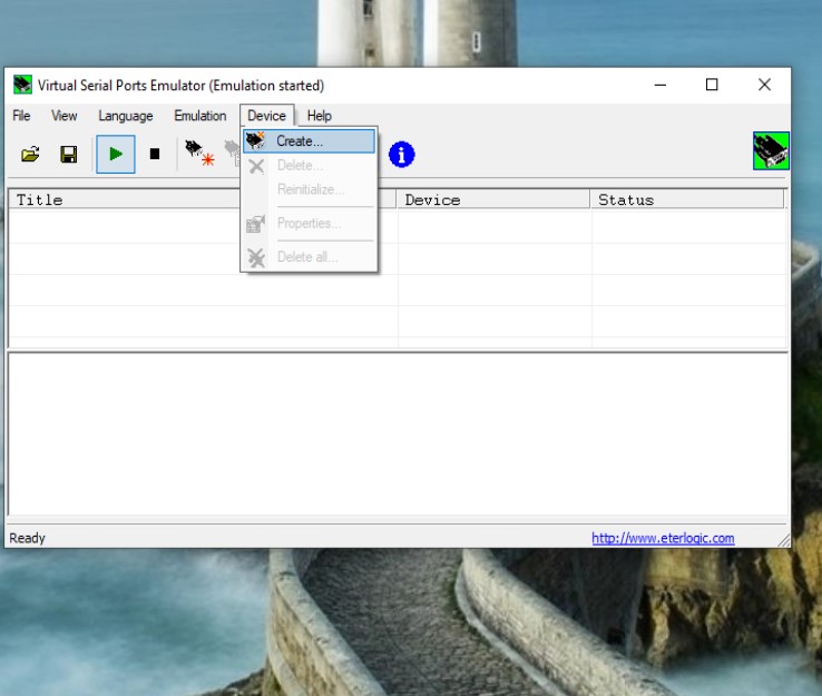

Using VSPE for creating a Virtual Com Port for TMATE2
I downloaded and am using VSPE as my virtual com port program. You can set any com port number not already used by Windows. I chose Com7. Attached are screen shots on how I setup the program. When you hit Finish, just minimize VSPE and let it run in the background.
Next, you run the TMATE2Console and set the same port as you set for VSPE. Lastly, Run PowerSDR mRX or Thetis and goto Setup/CatControl and
Eanble CAT for the port you assigned the TMATE to. You should be all set!

Ah, that explains it. Most people use port pairs. I believe only VSPE allows "connectors", one of the reasons I use it myself in order to allow two apps to connect to the same source of data.
