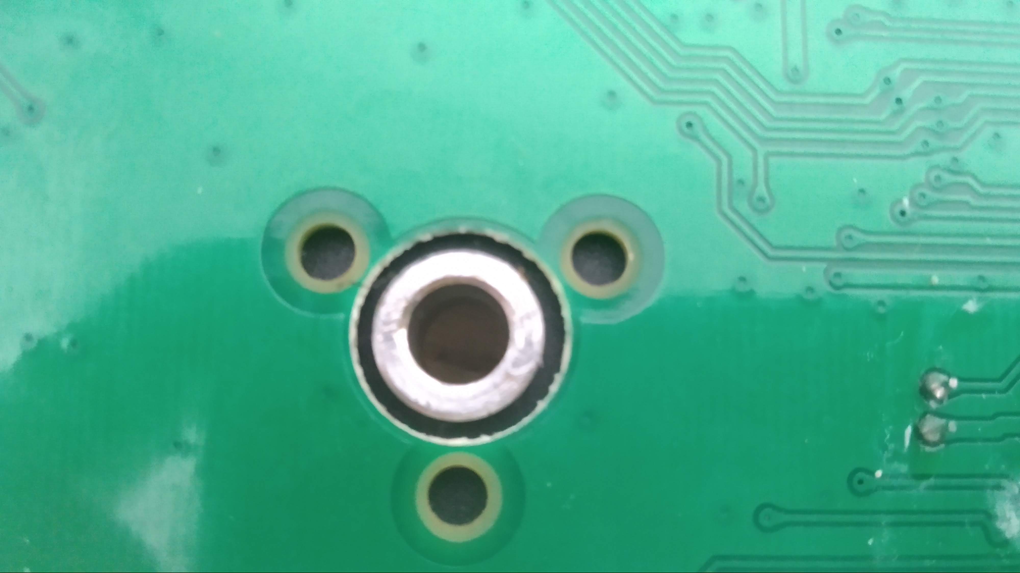

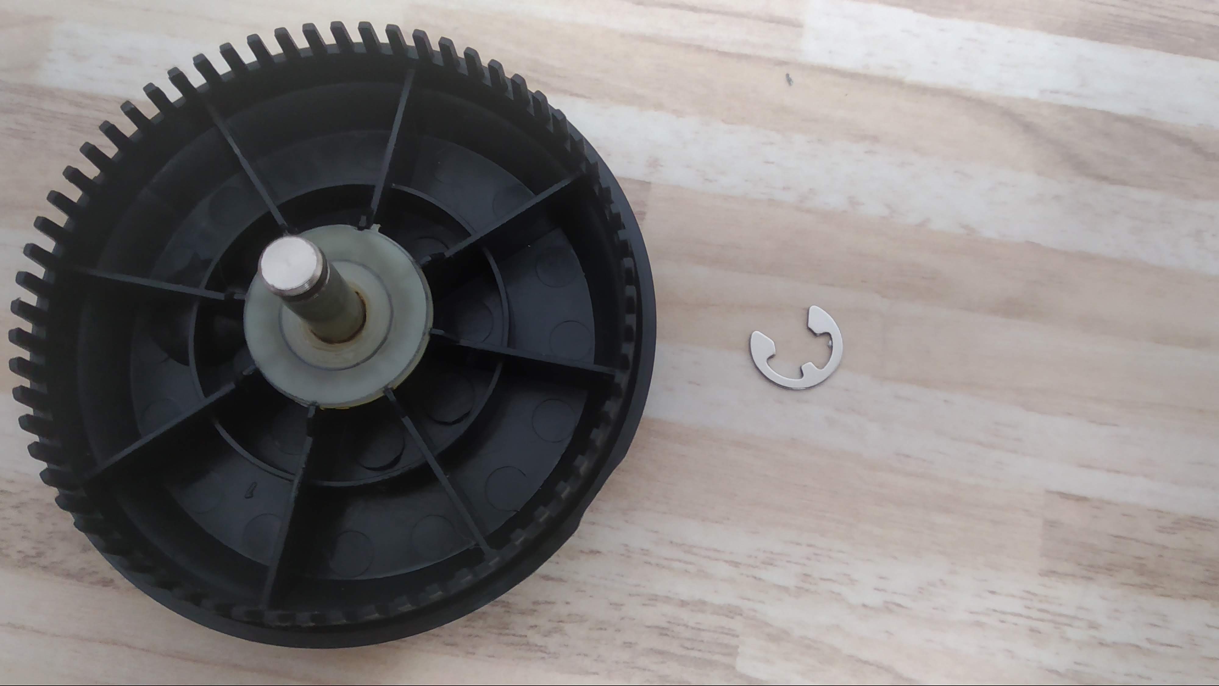

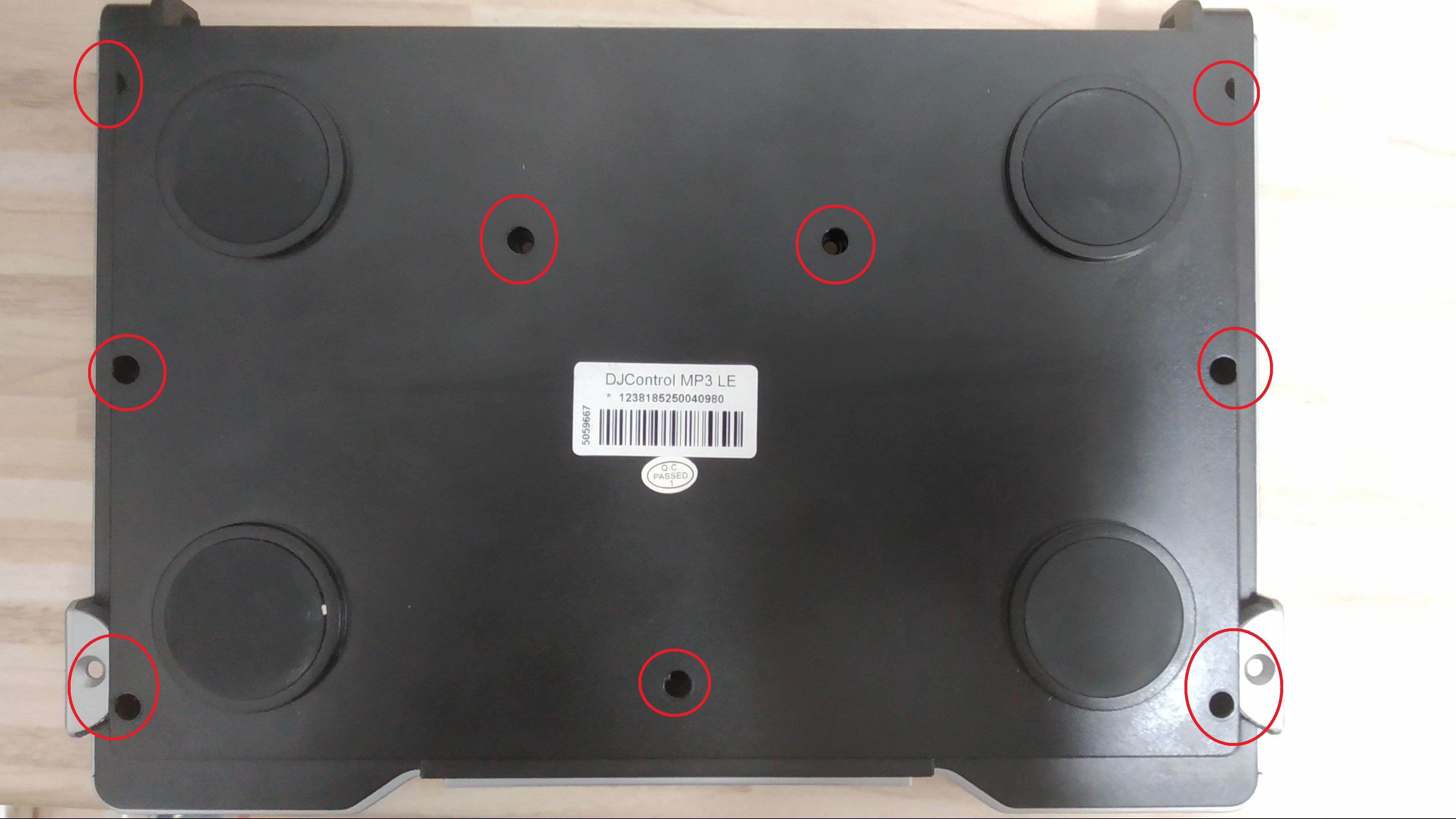

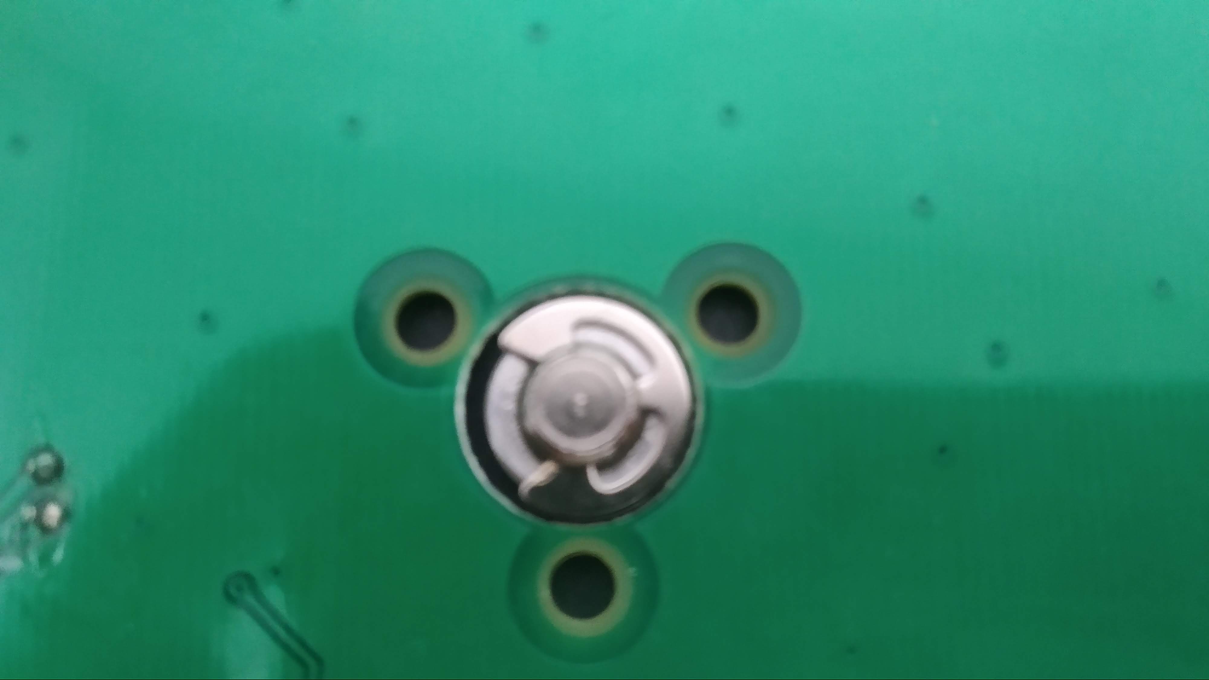

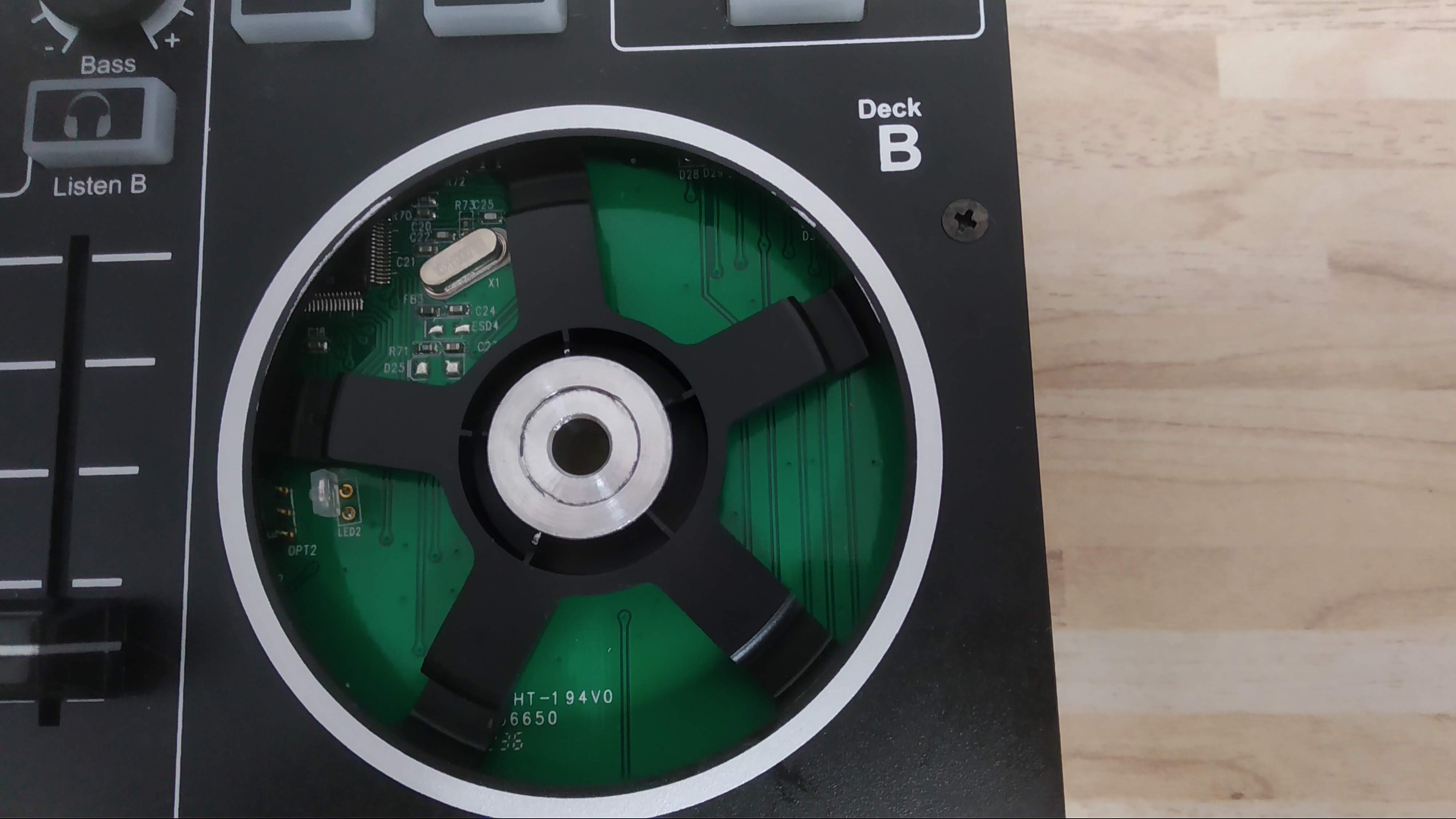

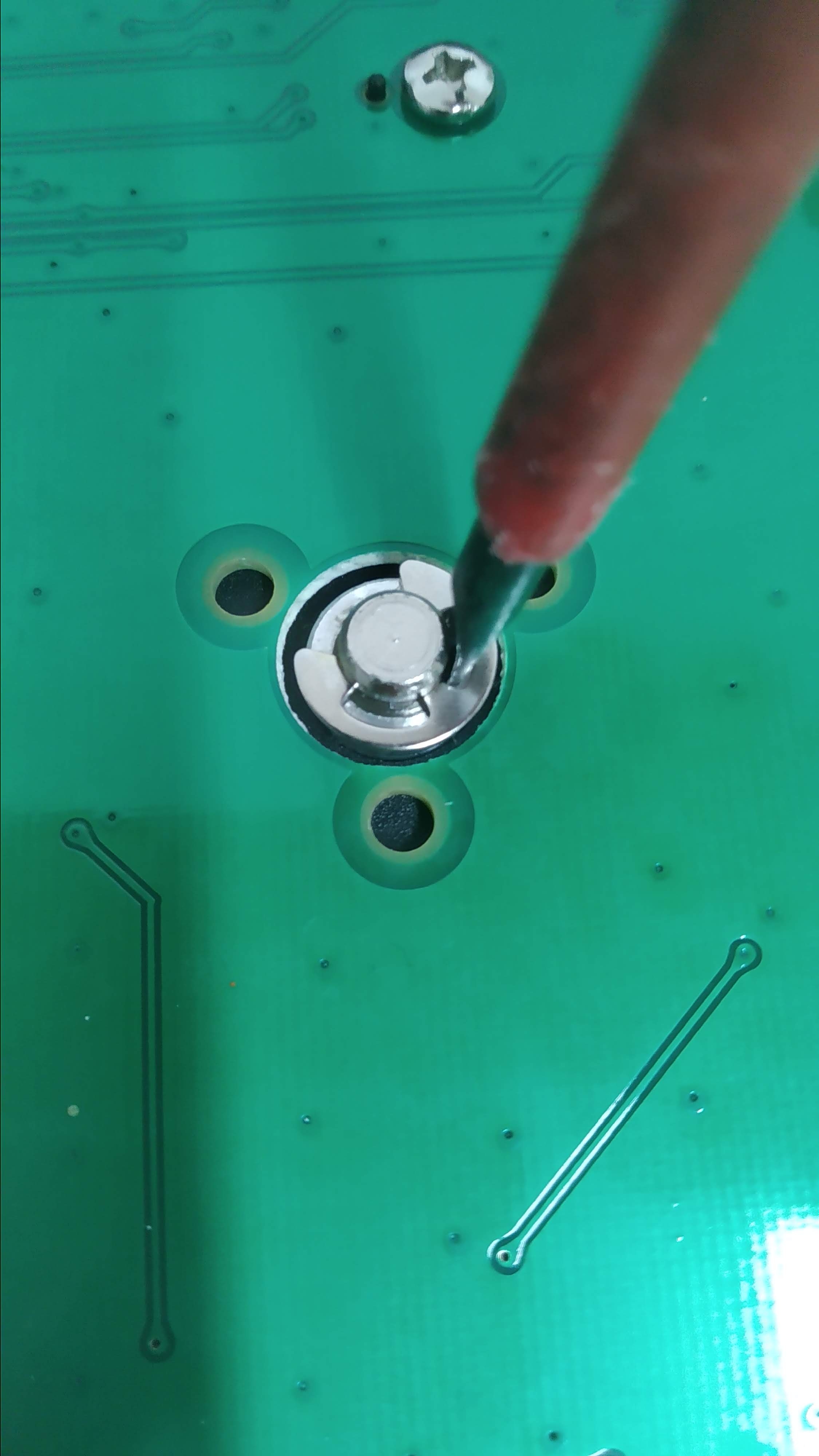

Hello Paul,
Unfortunately, the VFO wheels cannot be pulled off from above.
To dismantle the large wheels, you need to remove all screws from the back, then carefully separate the case halves from each other. Now you can see the back of the PCB.
There you will see a so-called C-clip. Remove this C-clip with a screwdriver, now the wheel can be pulled out upwards.
On this occasion, the shaft can be lubricated with graphite, for example.
It would also be possible to weigh down the inside of the housing with a small iron plate in order to give the deck more weight and thus increase the stability.
Incidentally, the C-clip can be easily reassembled with a pair of pliers.

Norbert: I can only suggest covering or replacing the rubber inlay as a quick solution. I will see what is involved when I get mine apart, maybe a 3d printed turnwheel with a grooved bolt could be a long term fix for you.
Sigi: Thanks a lot for the great pics and I'm so happy to know how to(this forum is ace). Looking at the wheel I presume those spokes are triggers for the VFO wheel to count ?

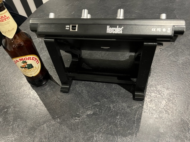

Postby PaulManc » Sun Nov 28, 2021 3:36 pm

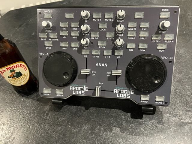

Little progress....
Modeled Part
Printed PLA Parts
In Place
3d Files attached as STL. Costs around £8 in material if you get someone to print for you.

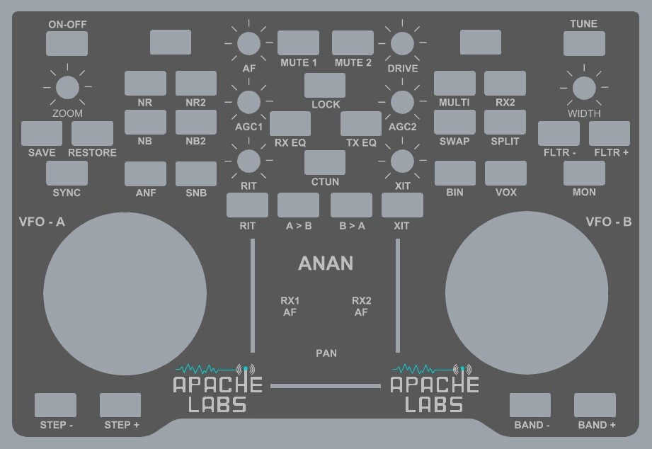

I have a CAD file done for the Hercules MP3 E2 facia vinyl but cant decide on layout yet!!. Will post back final version here in a few formats when done.

Postby PaulManc » Sat Jan 29, 2022 6:53 pm
Updated 4/3/22
For those of us using this older controller I wanted to share the vector file and image for anyone wanting to do their own version. Both files are to scale 1:1
Im having the vinyl printed next and will post back the final results shortly.

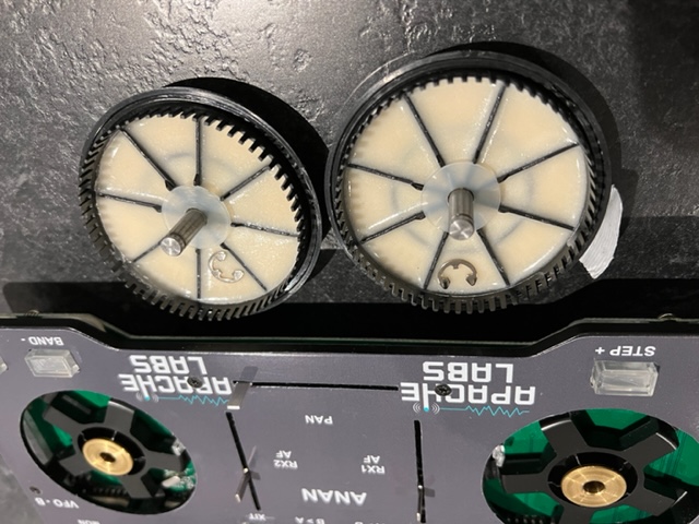

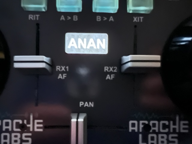

Postby PaulManc » Fri Mar 04, 2022 8:35 pm
Now lashed together see pics. Tnx to those in the thread that offered advice.
p.s The Moretti was worth the wait!
Weighted VFO.jpg (149.47 KiB) Viewed 14654 times
30gms Per VFO of epoxy resin & filler. Feels lush :)
Paul
