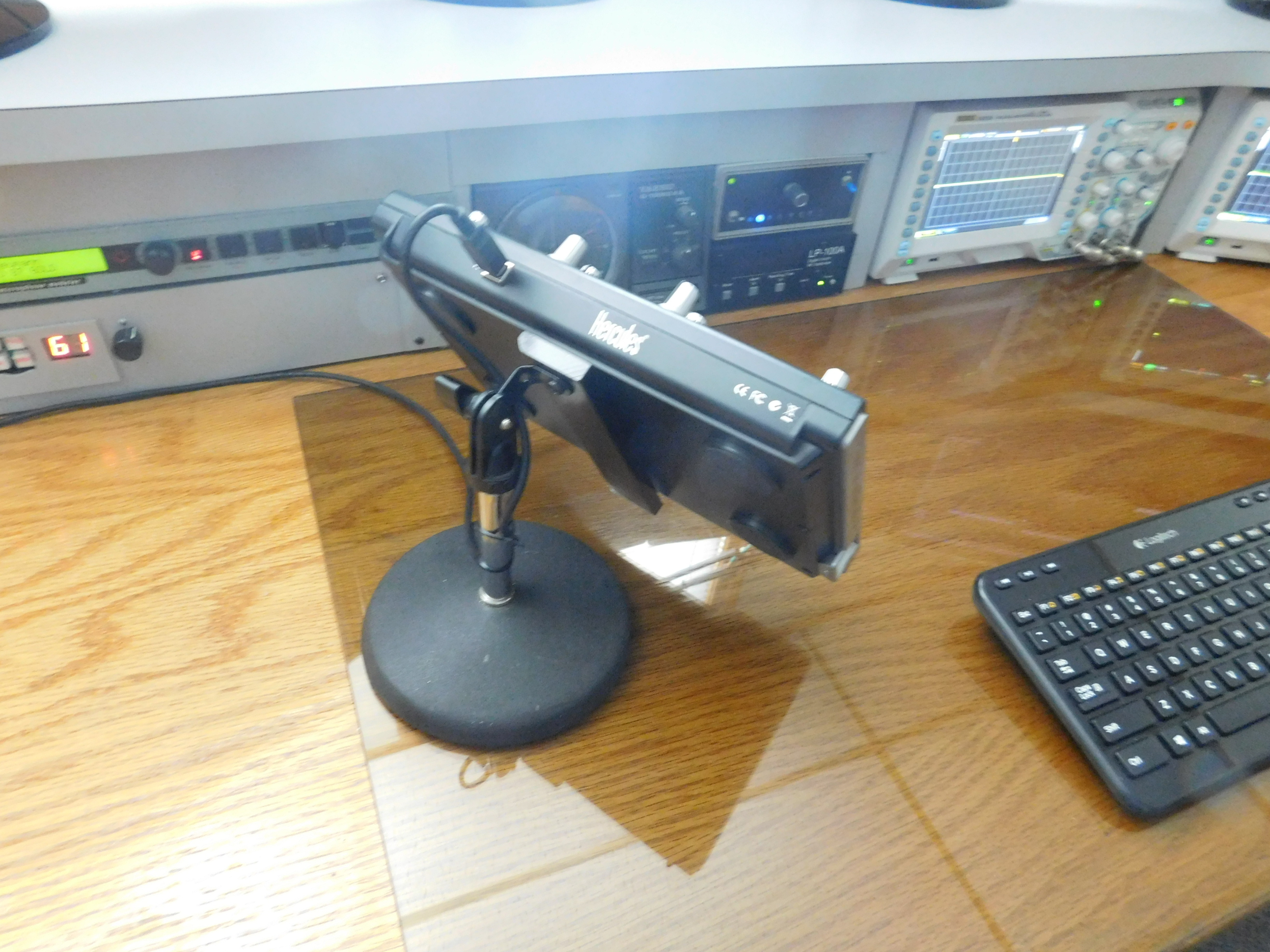

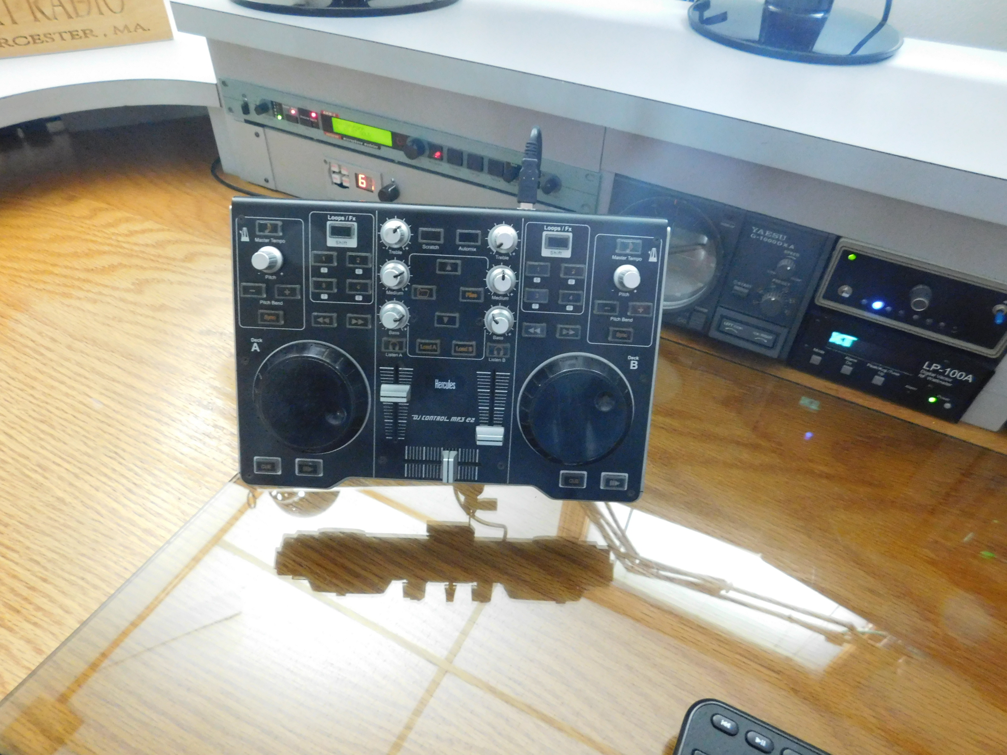

My DJ console support.
oxt
Re: My latest MIDI controller opus
Postby w-u-2-o » Sun Apr 21, 2019 3:55 pm
Very slick, Gary!
I have a block of wood that holds mine at a 45 degree angle but then I can't slide it out of the way under my monitors. But for serious use it attaches with Velcro.
Now I'm waiting for you to put that on a boom mount :D

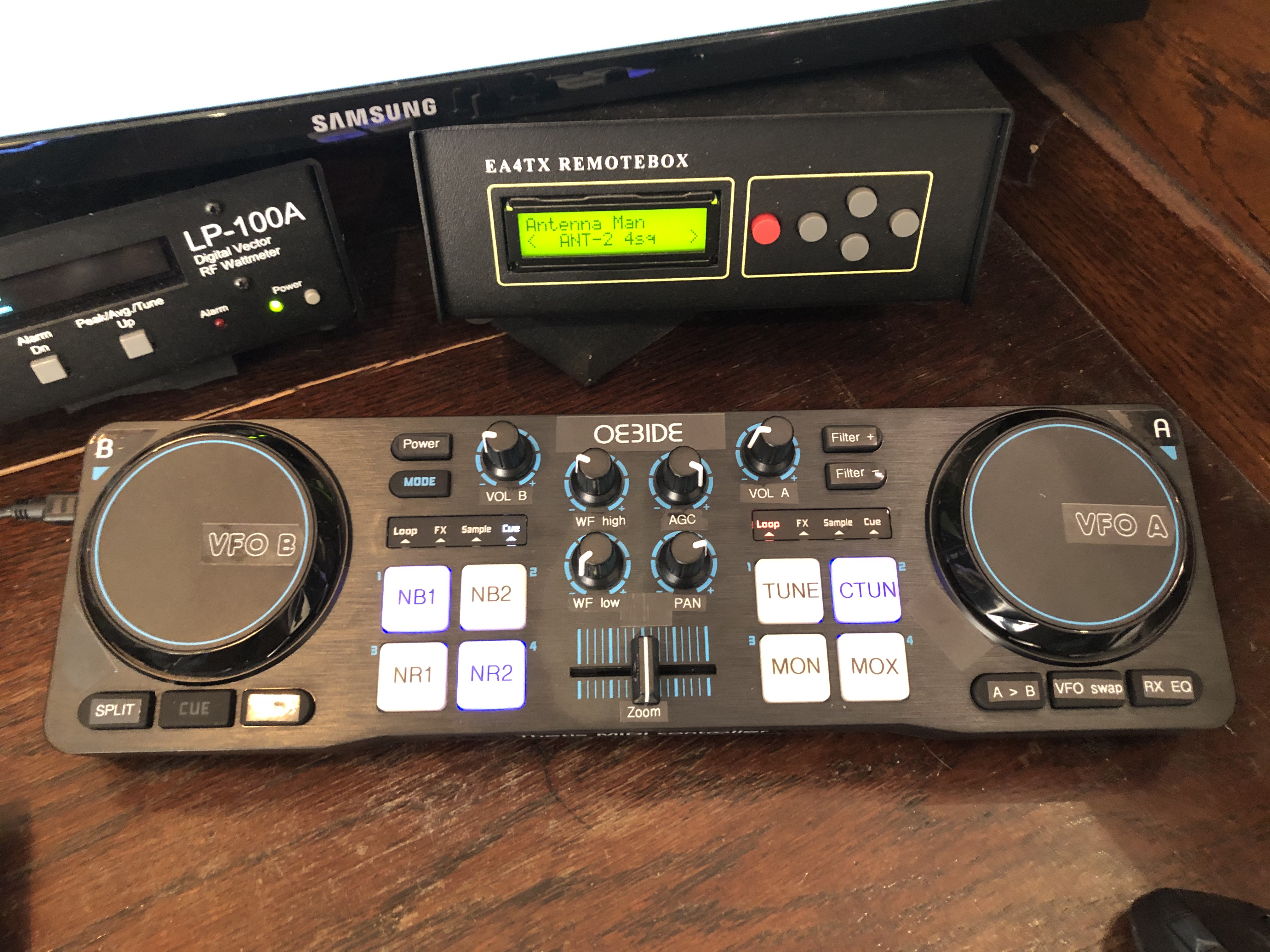

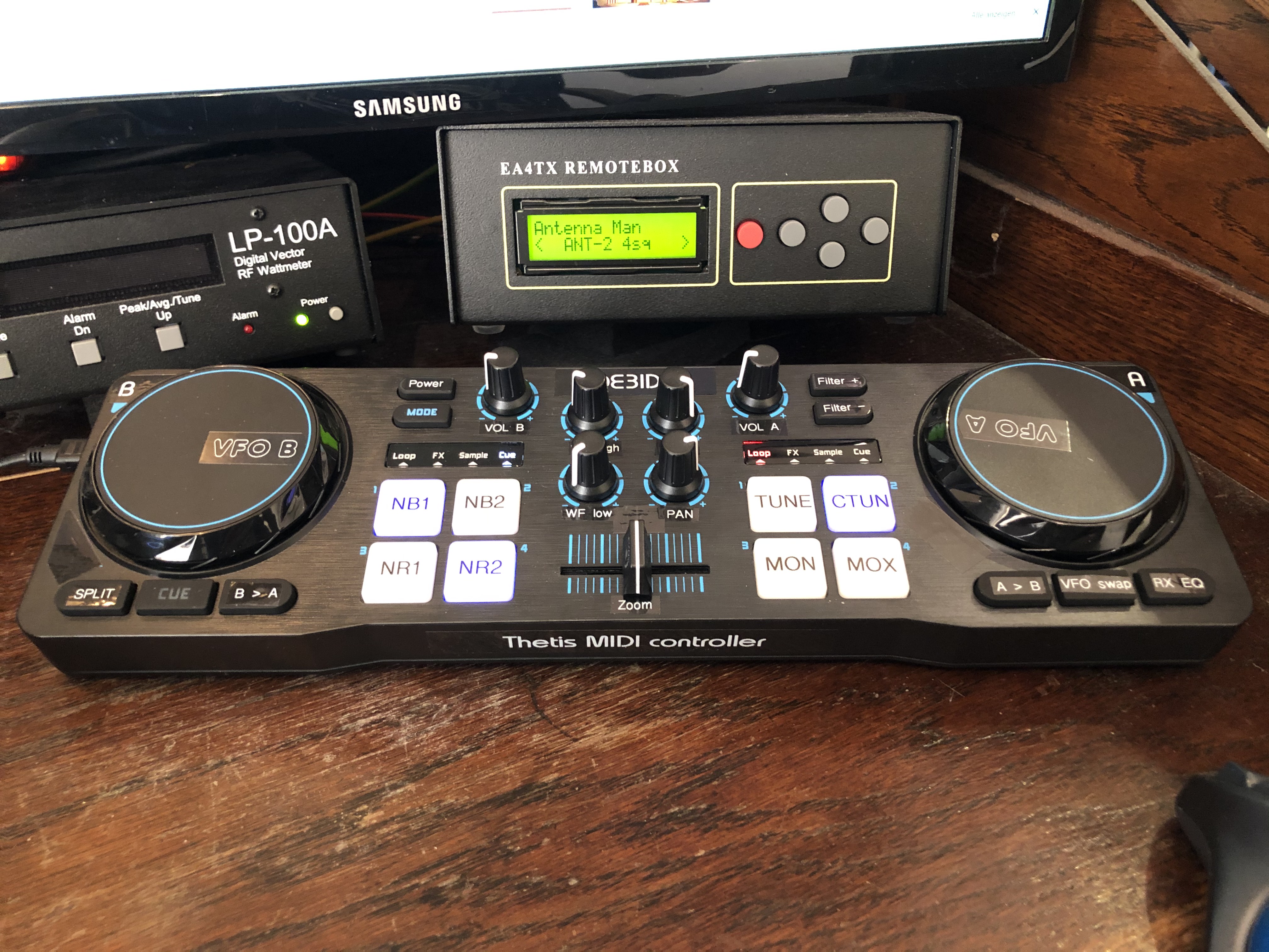

Postby oe3ide » Sat Jun 05, 2021 10:53 am
My latest addition :-)
Postby w-u-2-o » Sat Jun 05, 2021 11:11 am

ok ok nice! You pushed me to order a labeler at last ;)
