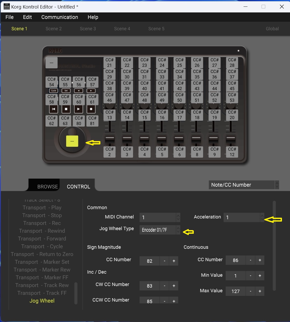

Third, just enter these settings with the yellow arrow.
Korg Kontroller.jpg (222.74 KiB) Viewed 20463 times

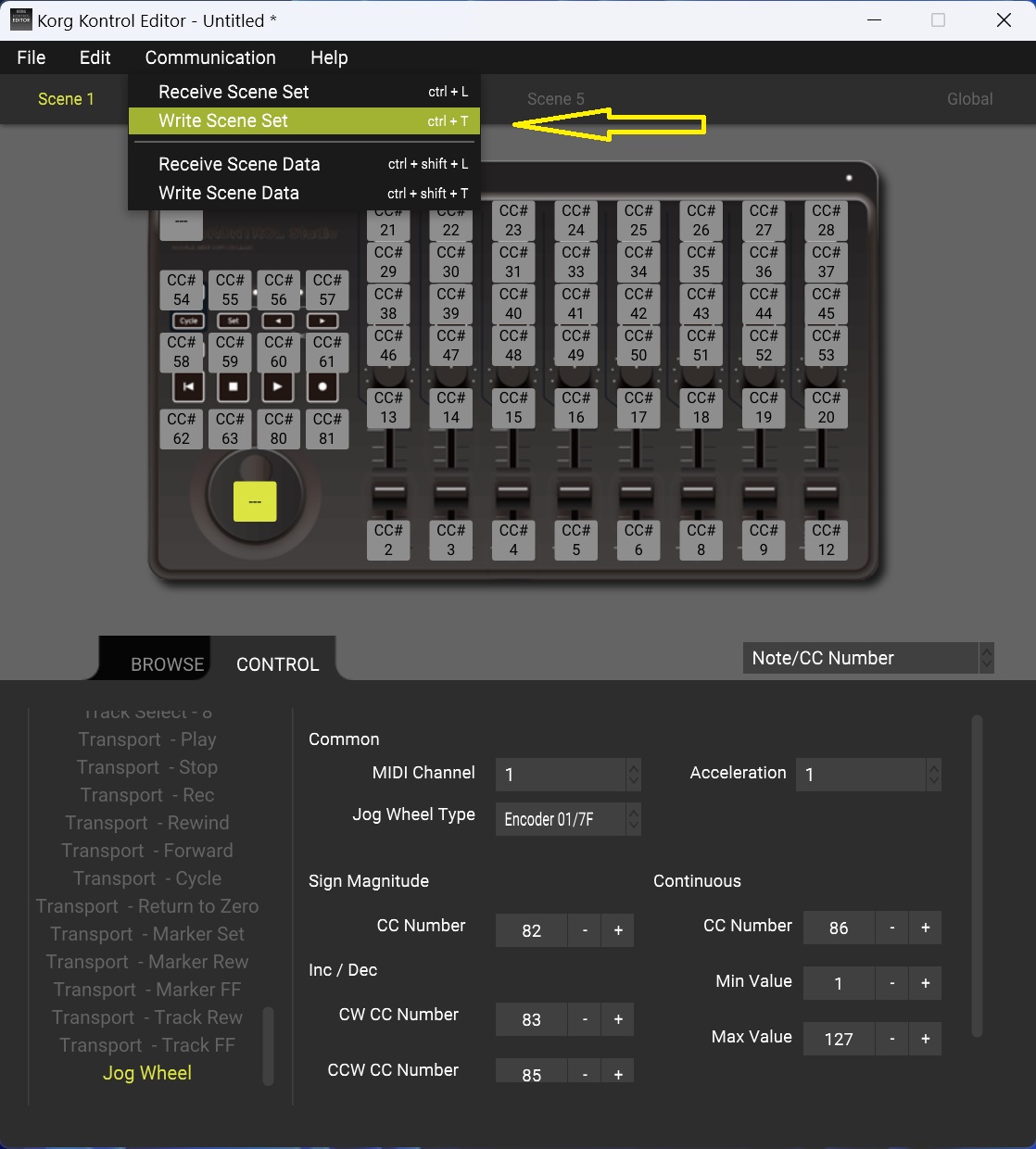

Four, just follow the usual steps to write to the device and save your work.
[attachment=0]Korg Write Scene.jpg[/attachmen
Always use the same USB port or it will lose connection.
Korg Write Scene.jpg (231.48 KiB) Viewed 20463 times
