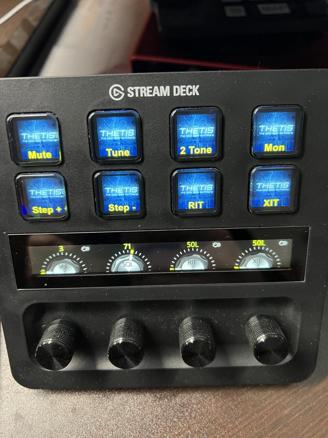

Rock Solid for me so far.
- StreamDeck.jpg (193.63 KiB) Viewed 16112 times

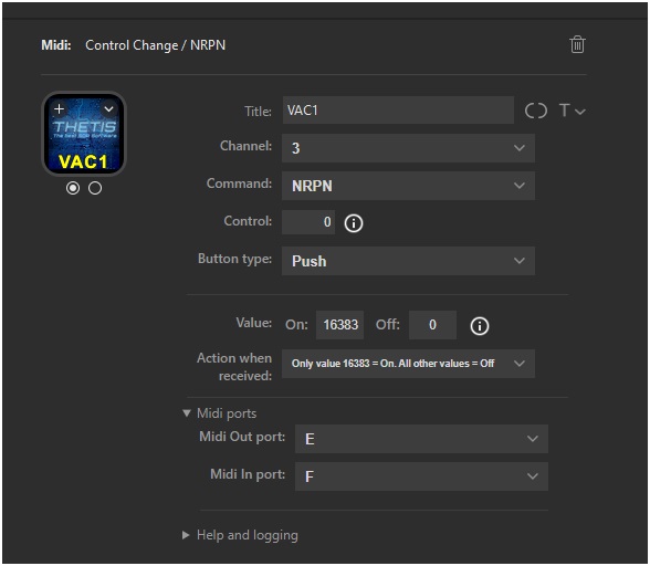

This is how I make it work and I may not be doing it the most efficent way.
NRPN Channel number has to be unique or the function will be the same on all buttons. 1 to 16 channels per LoopMidi pair, then create another pair and start over with channels 1 to 16. I don't do anything with the Control number in the StreamDeck Button Configuration. I don't pay any attention to the ID number in the Thetis MIDI Mappings.
- button config.jpg (41.26 KiB) Viewed 13985 times
