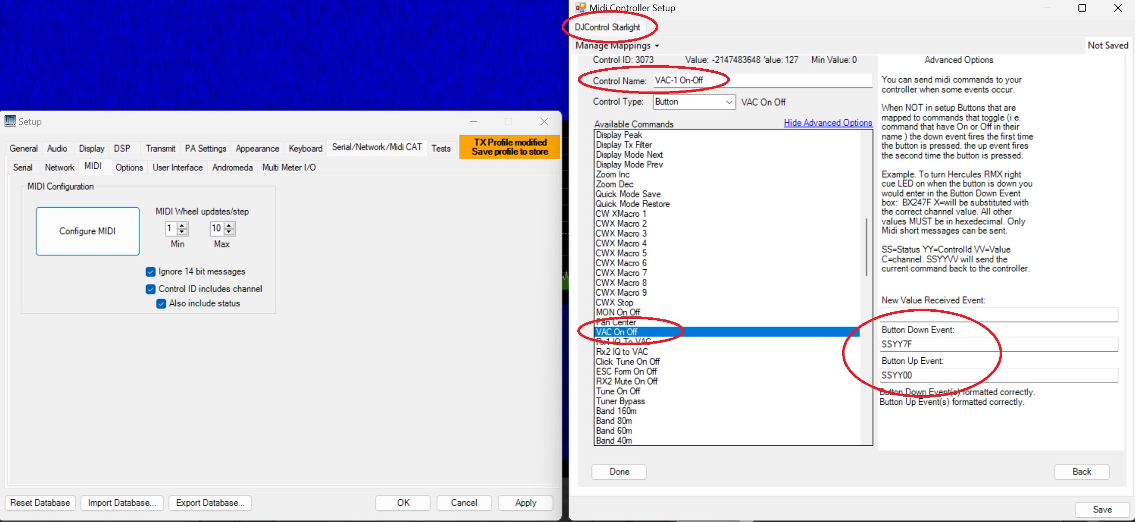

In a few older posts a misunderstanding has been created about the LED's addressing for the Hercules controllers.
For the Hercules Starlight (and possible previous models):
The LED ON code is SSYY7F (So, not F7 as posted before!) (7F is 128 decimal)
The LED Off code is SSYY00 (zero-zero)
See attached screenshot for a button example (VAC on/off) but these "codes" are the same for all buttons.
So you don't need to address each button with a different HEX code, just SSYYxx will do.
JUHA thank for your patience and help,
Regards, Leon
