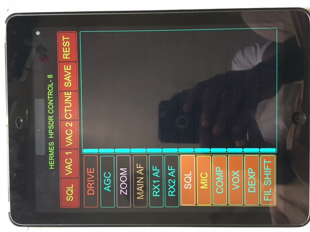

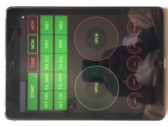

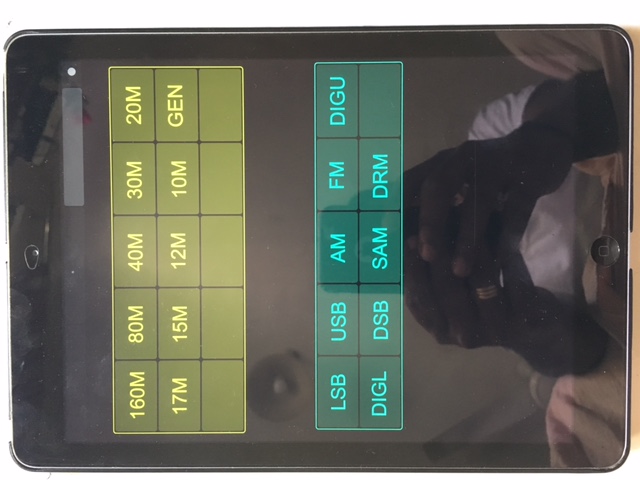

I designed my OSC layout which cover most of functions on PSDR screen.
I like to add option to display VFO Freq display in OSC layout. Is that function available ??

How about posting a screen shot of your layout?
Prem
Posts: 76
Joined: Tue Apr 11, 2017 11:57 am
Location: UAE
Re: TouchOSC custom tablet MIDI control surface
Postby Prem » Tue Dec 05, 2017 9:15 am
So we cant do the frequency displayed in OSC screen.
Please find attached the layout details I prepared modifying your layout and referring to some other sample layouts.
I have 3 Pages in my Layout as attached. If anyone interested, I can share the OSC design data file.
73s
Prem

Posts: 5922
Postby w-u-2-o » Tue Dec 05, 2017 1:12 pm
Great job, Prem! Excellent use of the multiple screen capability of TouchOSC, too! :) :) :)
