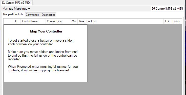

I was just watching Scotts video on how to set this up on my 8000 DLE, Im running 3.4.7 and when I click on Setup/CAT Control/ Configure Midi I get the screen from the video and I get the screen with the DJ Control MP3 E2 tab and Im asked to move the sliders or knobs, but when I do the window below mappings all goes blan. I am unable to map any of the buttons or knobs.
I have tried resetting the database and trying from scratch without putting any settings at all but I get the same issue.

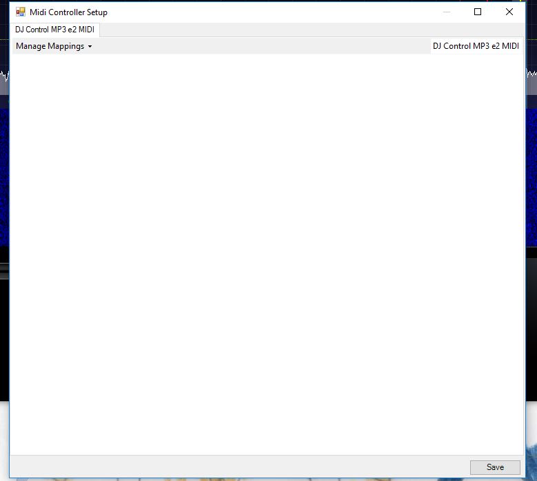

No I dont even get that. Hopefully the attachment will get through this time. Te first one is of the Configure Midi screen when it first opens, as you can see it recognises the DJ controller, the second screen is of what happens when I touch ant control, slider knob etc on the DJ controller.
I have done a database reset and tried it with the same results. I am running Win 10 Pro 64Bit with all the latest updates. I found the latest version of the DJ Controller software labelled 2018_HDJS_1 on the Hercules website which I installed.

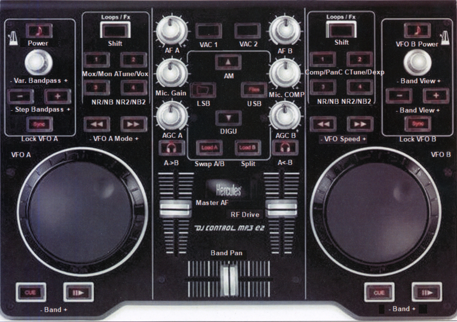

I picked up The Hercules MP3 E2 at a hamfest last weekend for $40 This thing works great with PowerSDR 3.4.9 although I did have some issues getting the drivers installed in Windows 10 Enterprise. I ended up using the disc that came with the controller and although Windows 10 does not identify my controller the way the manual shows with Windows 7 it ID's as "USB Composite Device" it works just great. Got everything mapped up and this thing works Awesome with PowerSDR 3.4.9 & my 8000DLE. Very well spent $40 making the DLE-8000 feel just like a dual VFO radio!
Attached is a template for my button mapping as well as my mapping file for anyone interested.
Nick
Nick
