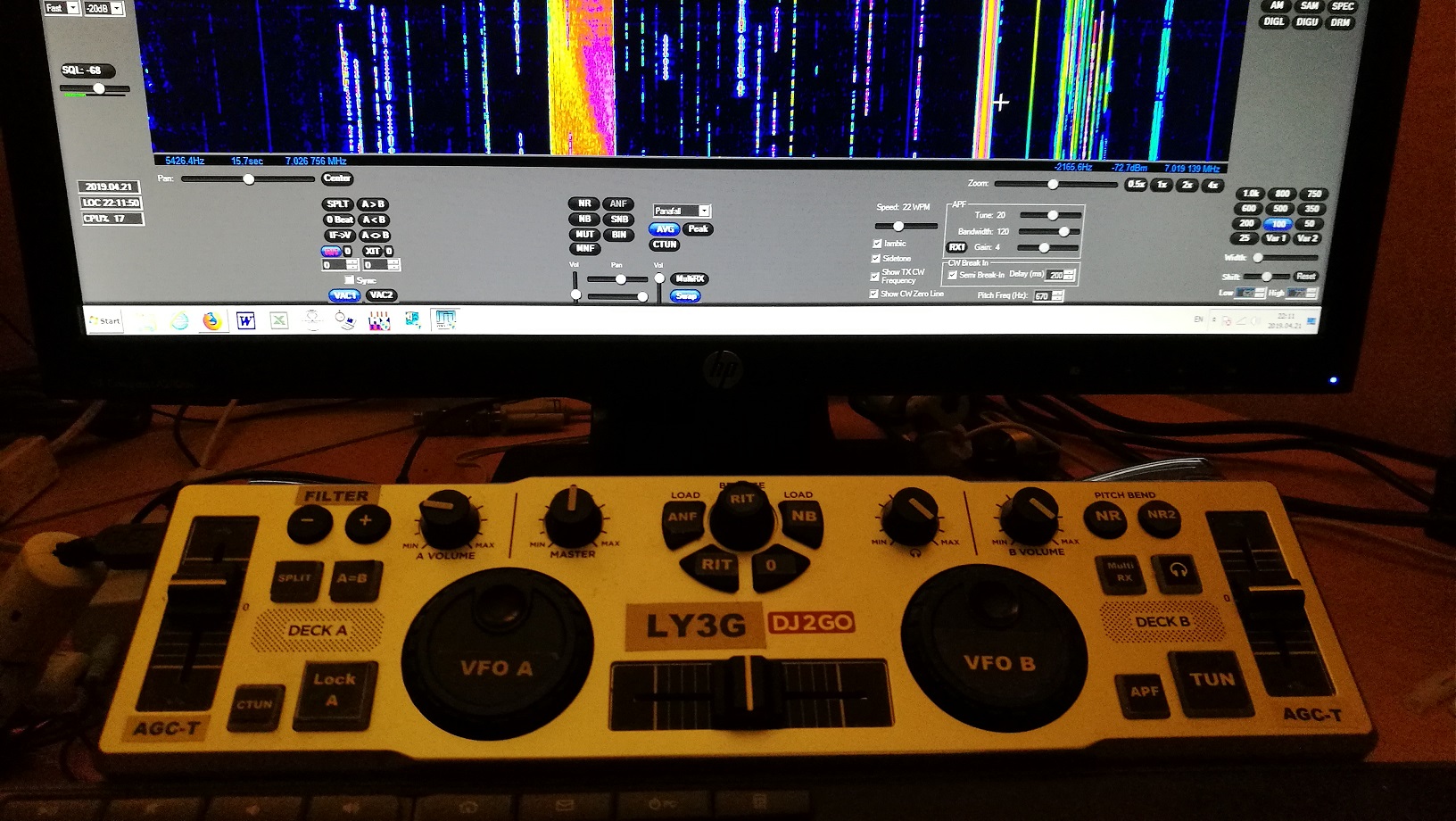

I am using a different version of DJ2GO. Everything is programmable and works great, there were no problems. Of course now I would like a Behringer CMD 2a, but mine is good too.
73! Gintas
73! Gintas
- DJ2GO.jpg (487.83 KiB) Viewed 13949 times
