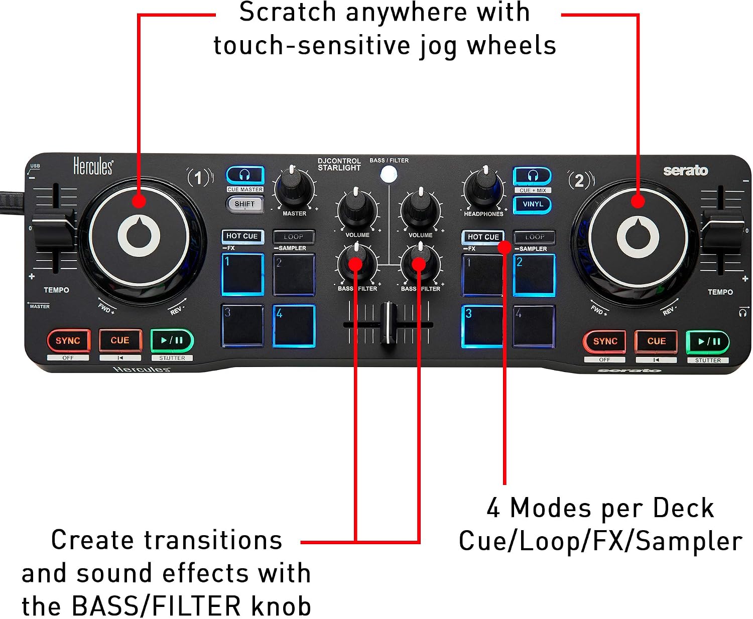

Hercules DJ DJControl Starlight - ahh, I do see its a little different from yours. I will figure it out!

Hello NIOZ, do you have a list of the LED (hex) codes for the Starlight?
Or would you be so kind to share your midi config file as a reference?
I have searched the internet for a long time but can't find anything.
Thanks & regards PD3LK (Leon)
Re: Two Way Communication
Posted: Sun Aug 11, 2024 9:44 pm
by PD3LK
In a few older posts a misunderstanding has been created about the LED's addressing for the Hercules controllers.
For the Hercules Starlight (and possible previous models):
The LED ON code is SSYY7F (So, not F7 as posted before!) (7F is 128 decimal)
The LED Off code is SSYY00 (zero-zero)
See attached screenshot for a button example (VAC on/off) but these "codes" are the same for all buttons.
So you don't need to address each button with a different HEX code, just SSYYxx will do.
