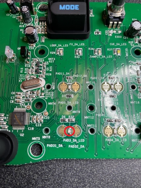

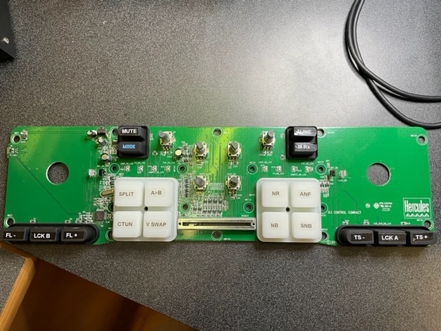

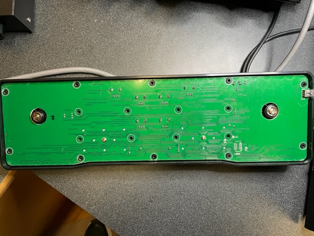

The images below show the DJC-Compact's internal PC board. Disassembly and board removal was easy and only took a few minutes.
The first image shows a red circle highlighting the defective LED. Before removal, I verified that the series current limiting resistor had not changed in value; it measured identical to the other current-limiting resistors.
The LED was swapped with an alternate on the board that's only pulsed periodically. It's a temporary fix until some industrial-grade LEDs are received from Mouser. The blue LEDs are standard 1206 SMD/SMT. I'll report back with the Mouser P/N after replacing all affected LEDs.
I'm not sure why these LEDs are failing apart from manufacturing defects. They're operating well within a normal forward current range.
