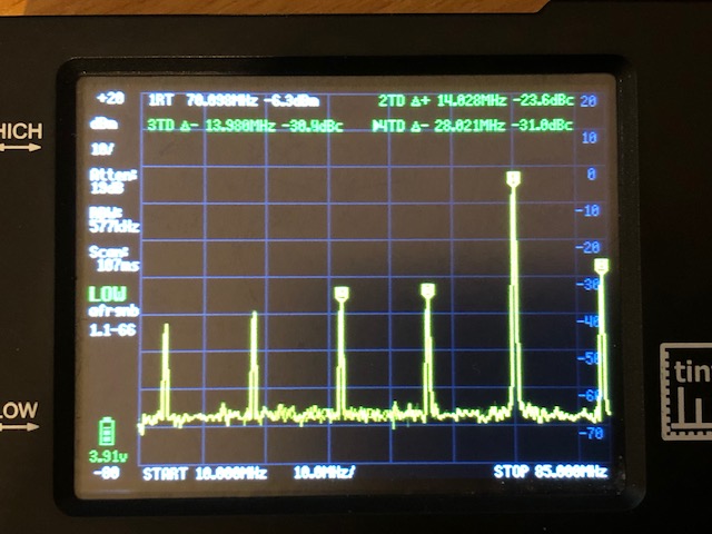

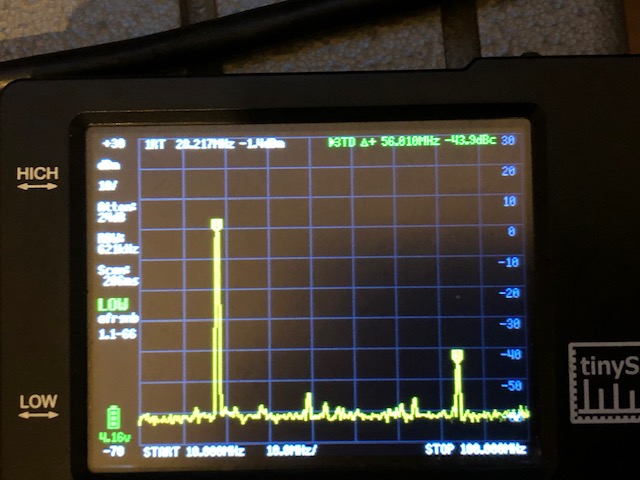

I noticed some unusual peaks in my 28/70 MHz transverter TX output. As well as the main 70MHz peak I also see peaks at 14, 28, 42, 56 and 84 MHz from the transverter- some at -25dB down from the main peak (picture attached). When I checked the purity of my 200D XVTR TX output it had no detectable 2nd harmonic (56MHz) but the 3rd harmonic (84MHz) was clearly there at -40dB (see 2nd attached spectrum). This caused me some confusion because the LO in the transverter runs at 42MHz (to give 70MHz) so 84MHz would also be a 2nd harmonic, so two potential sources of this peak.
So, for those who have used the ANAN XVTR out port, do you see a clean spectrum at 28MHz? I am now starting to believe that at least part of the bad TX spectrum from the transverter is caused by the 84MHz peak from the 200D XVTR output. You can do the numbers with the 28, 42, 84 MHz signals to generate all the peaks in the bad transverter output. The final transmitted signal after my 70MHz PA is not so bad because of filtering but the unwanted peaks between 14-84 MHz are still present at around -40dB.

Yes, you are right the VHF gain does directly effect the XVTR signal- I should have realised this! For HF we adjust gain to correct the power output (to 100 drive=100W normally) but what do we adjust gain for at VHF? I can't find any information. I can see the effect on XVTR power out as I change the setting. There is also a big change in the 28MHz XVTR TX spectrum with it being much cleaner at lower gain numbers. Maybe we should use the same setting as for HF 28MHz?

Now I have done some IMD measurements. On the Ukrainian XVTR the best I see is IM3 -30dBc, IM5 -38, IM7 -47 at gain=50. This is at 1-1.5W out, which is what I need to drive my 70MHz PA. Actually there was little difference in IMD with the 200D gain settings over 40 to 70 range at 1W from the XVTR.
At these settings the spurious peaks at 42, 56 and 84MHz from the transverter were all more than -40dB down from the main 70MHz output. No 140MHz signal detected at all.
So overall, perhaps not too bad. With the XVTR driving my PA to 100W I see IM3 -30, IM5 -27, IM7 -35. At 200W this is IM3 -20, IM5 -36, IM7 -35. These are not great but the PA and transverter are still open on my bench, so I hope once they are housed properly the IMD may improve a bit.
