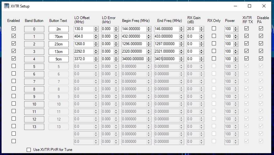

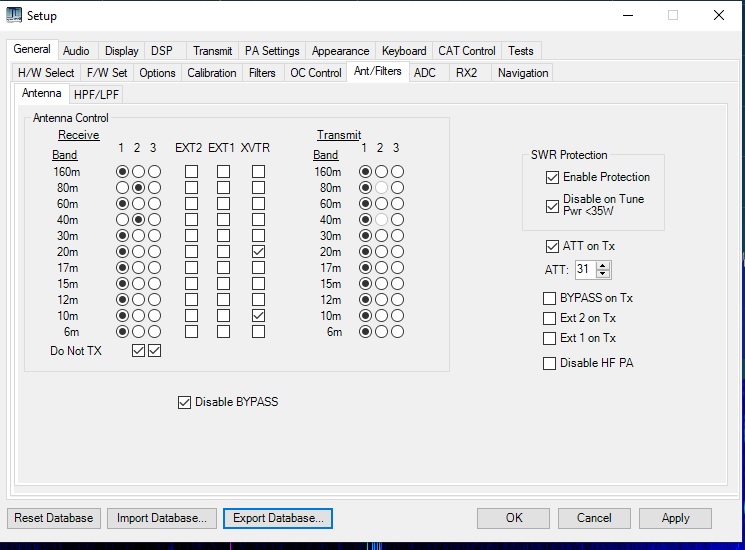

I thought I would try Thetis(v2.9.0) with my 100D (Protocol1) instead of my usual PiHPSDR and mk2 controller.
I mainly use the Anan as a transverter driver for VHF and up and but also have a 40/80m dipole connected to ANT1 and a RX antenna on ANT2.
It works as expected with the controller but when I try to duplicate it with Thetis, I don't seem to be able to get the antenna configuration correct and when using a transverter I get the RX from it mixed with the IF RX. This doesn't happen with the controller. Maybe I missed a setting but I cant find it and any help would be gratefully received.
