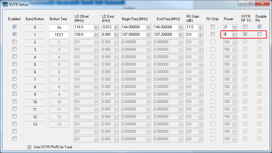

the SMA XVTR output is for max. 0.5W only.
If you need more you have to use the internal PA on one of the three ANT x BNC's.
Use the setting below for PA activation:
5W XVTR.png (44.07 KiB) Viewed 46642 times

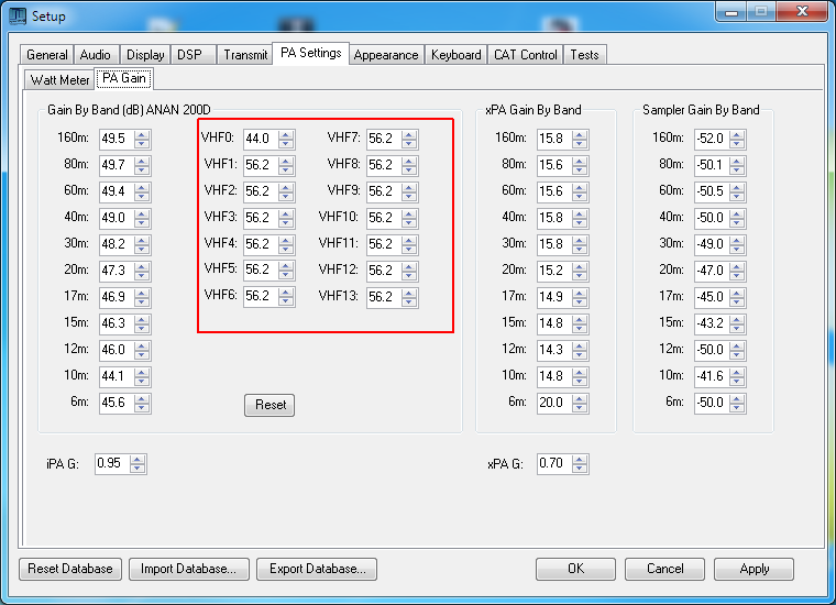

Don't forget to calibrate PA Gain for maximum allowed input of transverter:
XVTR PA CAL.png (41.75 KiB) Viewed 46640 times

Hi Walter, Thanks for your informative reply, and the setup screen pictures really help.. I would like to see how you would select the antenna routing? I don't see options for the VHF+ buttons to route antennas through 1,2,3 BNC ... It seems to me that if I use a 28 Mhz if transverter I would loose regular 10 meter coverage unless I pull the transveter out of line, or somehow the vhf buttons have their own connector assignments?
I don't see anything other than the HF bands on the connector assignment setup screen... /where do I need to look or can you provide a screen cap of the menu where I might assign a connector to a VHF only button?
