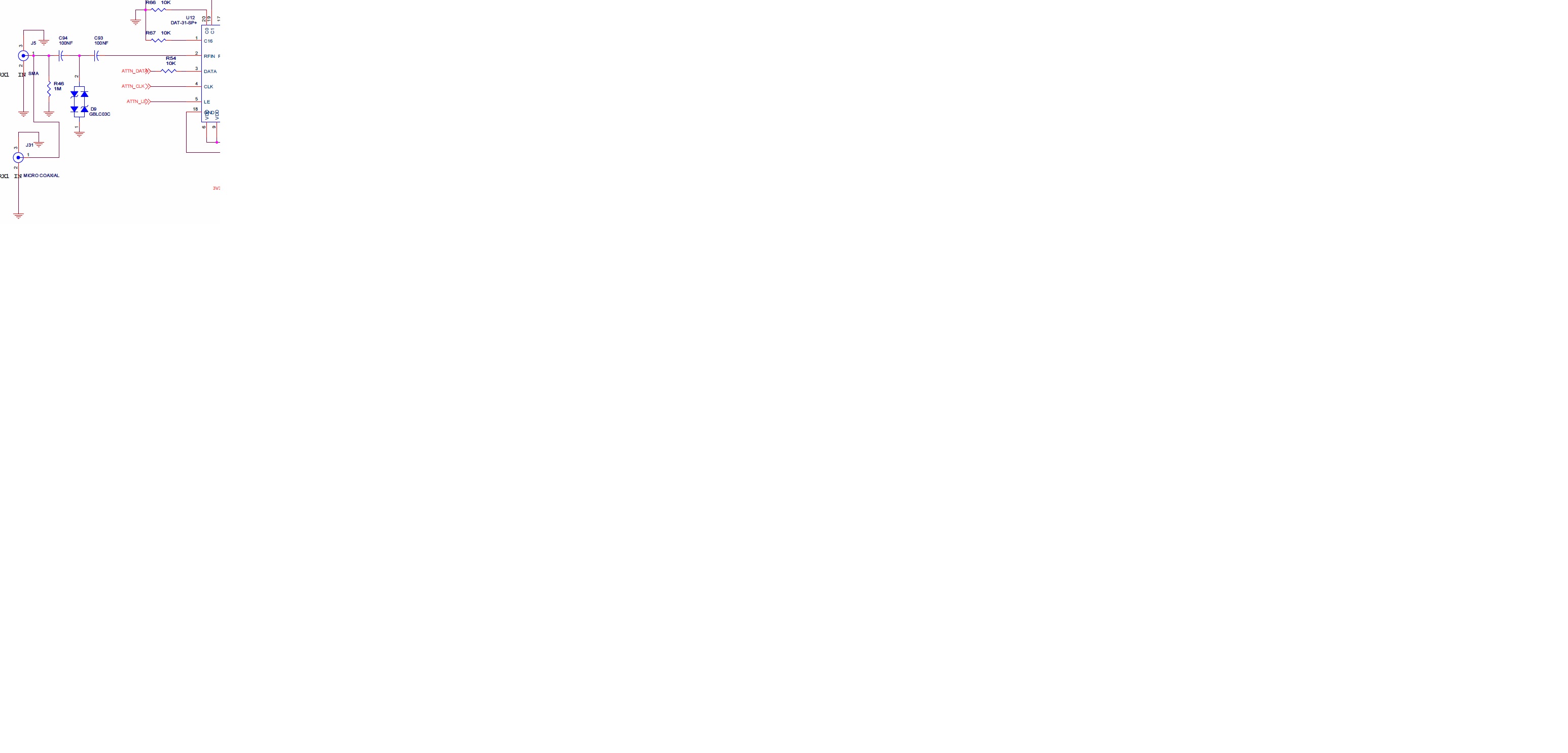

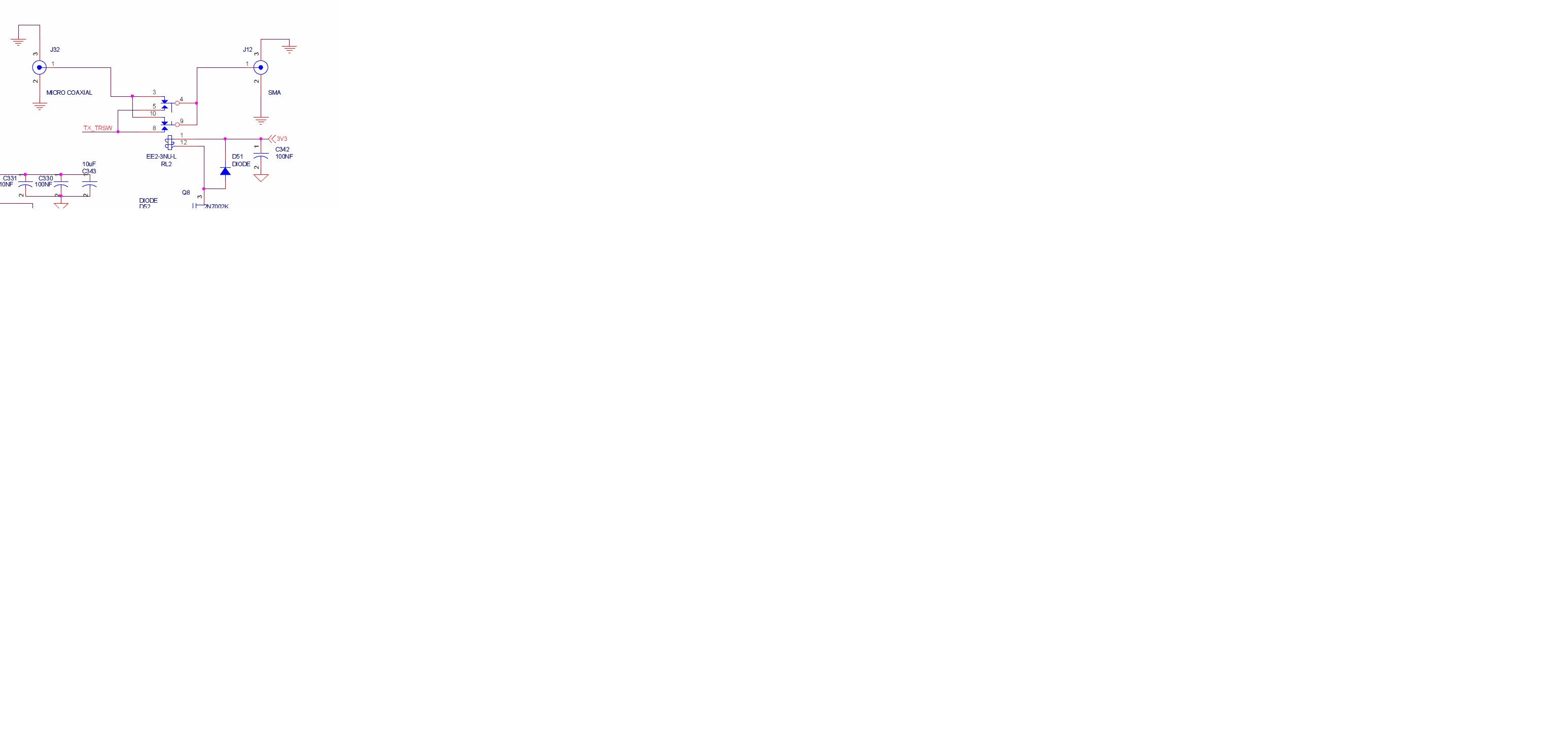

i presume the board you have is the Orion II board??
I have the schematics, if you want them,basically u need a micro coax jumper jumper between j32 and J31
this will allow use of the transverter port rx/tx, as you want , using the single connector.
I use separate ports for my transverters so i did separate mine, its pretty fresh in my mind.
Be extremely careful with the micro push on connectors, you can easily damage them.
73's
stu ve2xx
73's
stu ve2xx
