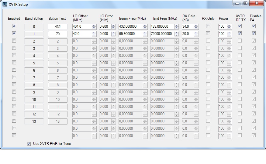

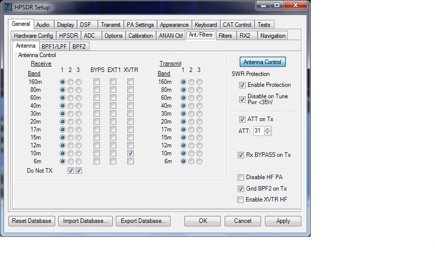

Hi Volker , is there anywhere on the web showing correct settings to use for power sdr/thetis and ME4T ?
dl4zbg
Posts: 172
Location: JO41QG
Re: Which Transverter to use ?
Postby dl4zbg » Mon Jun 10, 2019 9:54 am
Hi Tony,
unfortunately not. For 4m I am using an internal Transverter for my K3 (made by EA7HG, IF 28MHz)
However, I have created a test configuration and checked it with my 7000DLE/ DB6NT 432 MHz transverter (fooling it, HI)
- I was able to hear a beacon on 432.473 with the reading of 70.473 MHz
- transverter noise did not decrease when changing the Frequency below 70 MHz
- I was able to transmit below 70 MHz, e.g. 69.950 MHz (in reality 431.950)
Hope that helps a little bit...
Volker
DL4ZBG/DK0B
BTW: be very careful with the transverter output drive level, I use a 20dB attenuator!!
Transverter settings in 3.4.9
Enable Rx for transverters on 28
